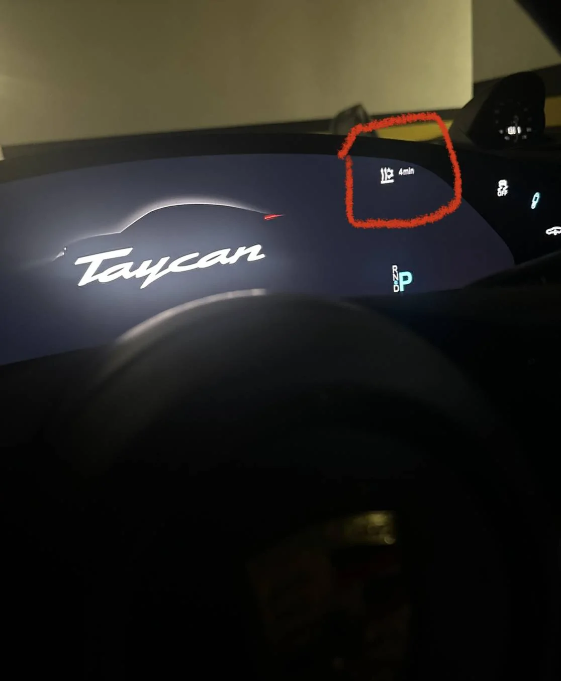

Hi everyone. I just got my Taycan 4S and cannot figure out an icon on the display before you hit the start button. I checked the user’s manual but couldn’t find it?Can you please help me out?

That’s a countdown timer for cabin pre-cool or pre-heat (pre-conditioning). Starts at 60 min and counts down.
you just have preconditioning enabled in a profile or turned on the AC remotely using the app.

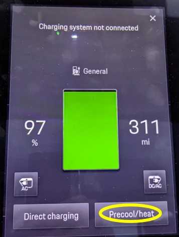

To manually turn the preconditioning on or off, bring up the battery screen and push the Precool/heat button. It's more reliable than controlling it from the MyPorsche app. Precooling keeps my 2022 RWD nice and cool during short stops - especially if I'm not in covered parking.
It also does an automatic 5 minute pre-conditioning whenever I get out of the car.

Thank you so much…I didn’t use the app. I have no idea how I turned on the preconditioning☺
That’s great. Thank you…
