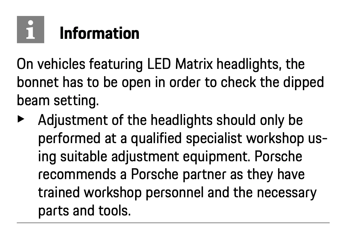

Just as a FYI, this is mentioned in the manual:
Porsche Taycan DIY headlight up/down adjustment manual-not

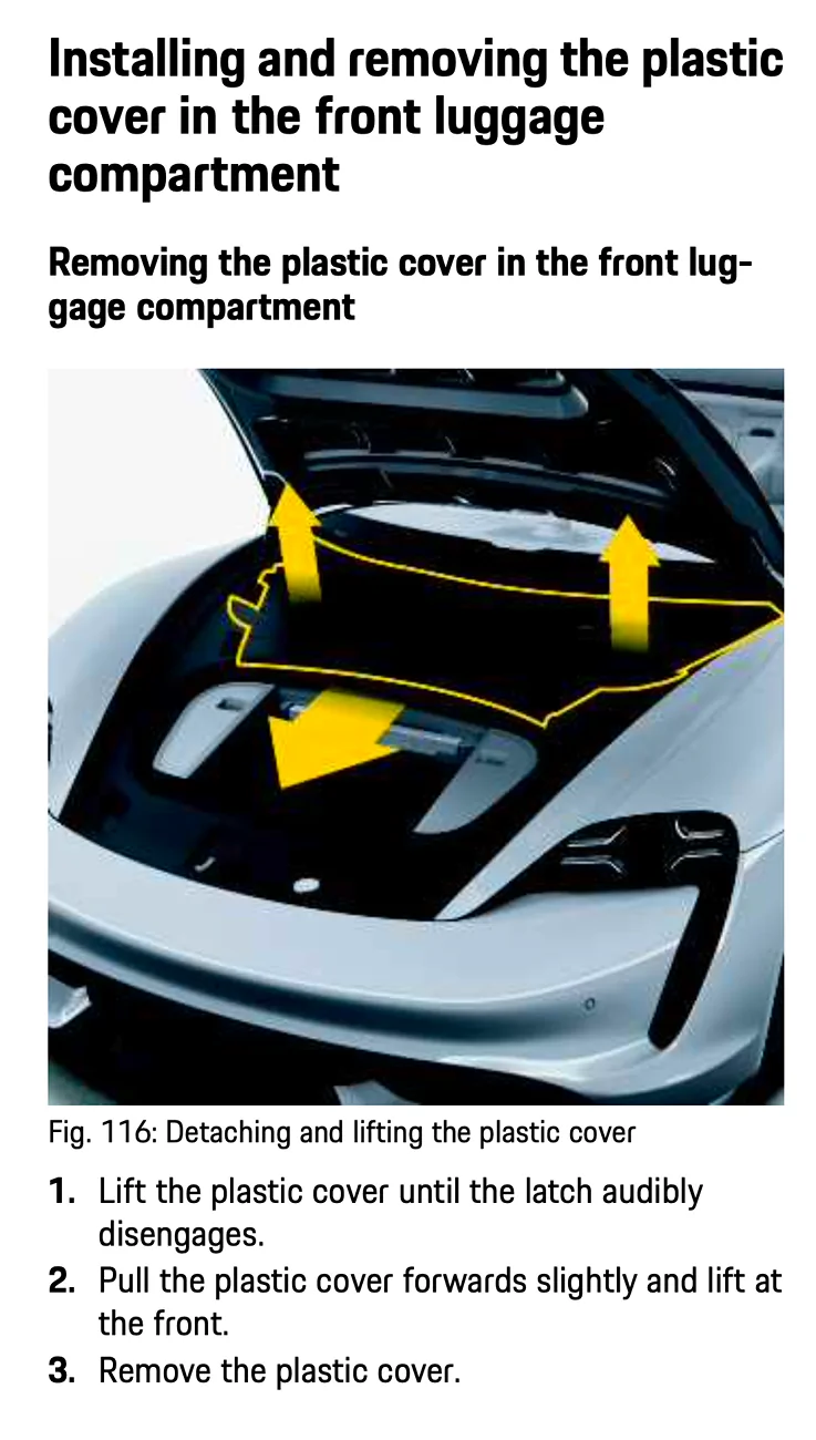

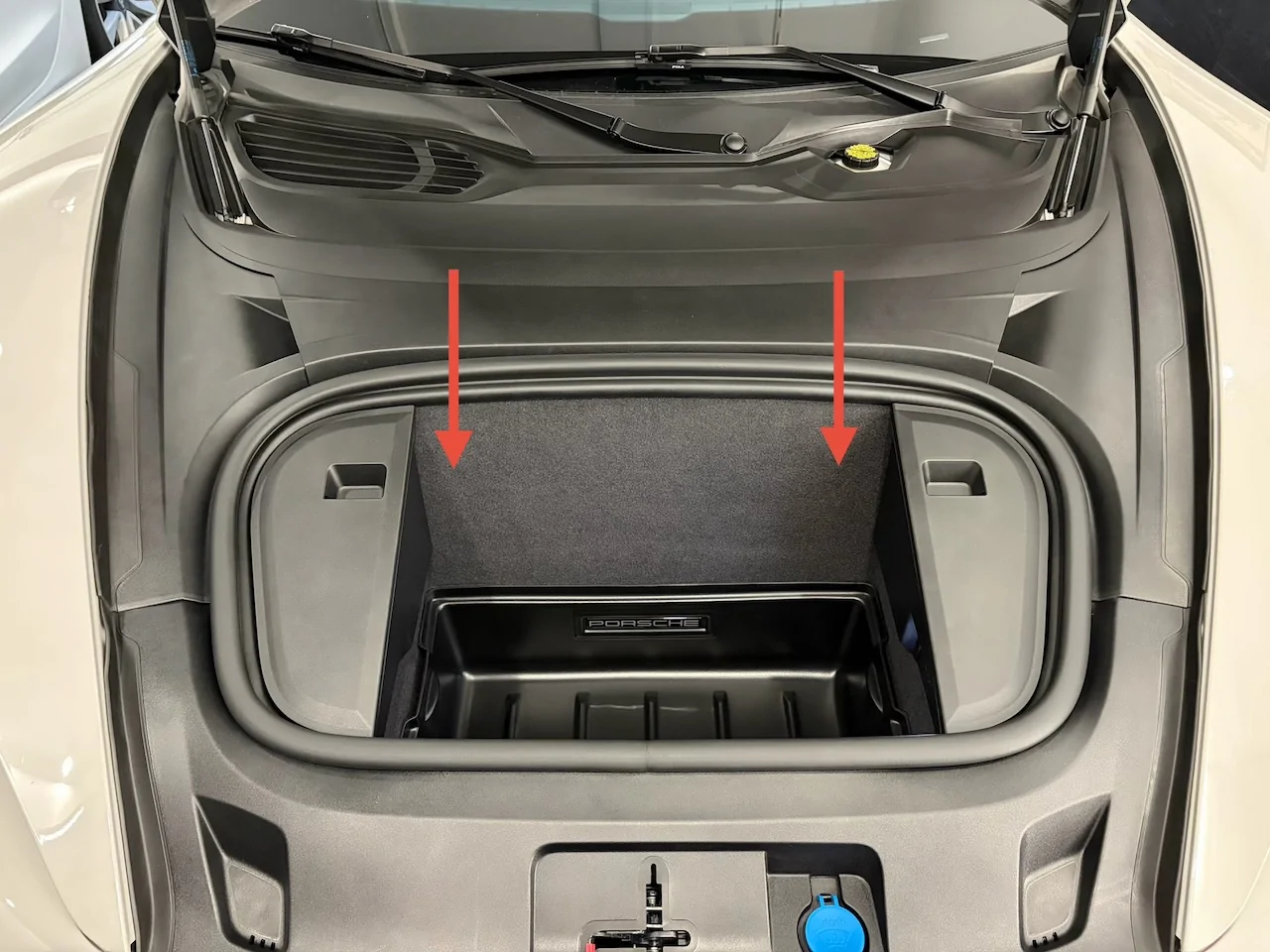

1. Remove top plastic cover
(from manual)
Porsche Taycan DIY headlight up/down adjustment manual-cover-removal
Porsche Taycan DIY headlight up/down adjustment to

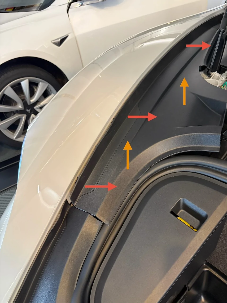

2. Remove side plastic covers
The front cover near the bumper does not need to be removed. Gently remove the rubber ends on the sides, sideways (red arrows). There are 2 metal trim fasteners (orange arrows) which should be pulled straight up. After the panel is removed, ensure the metal fasteners are firmly attached to the plastic panel before reinstalling.

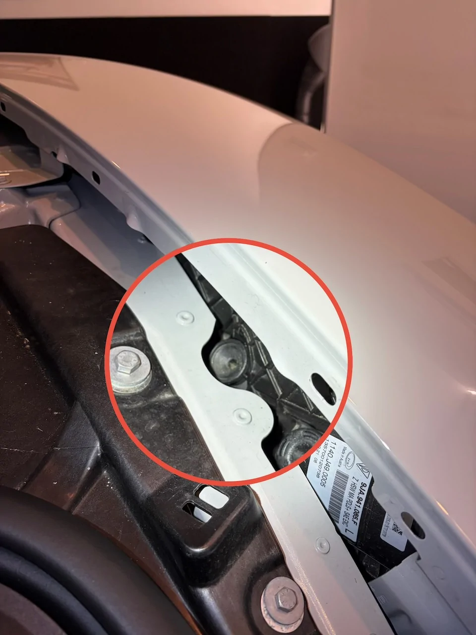

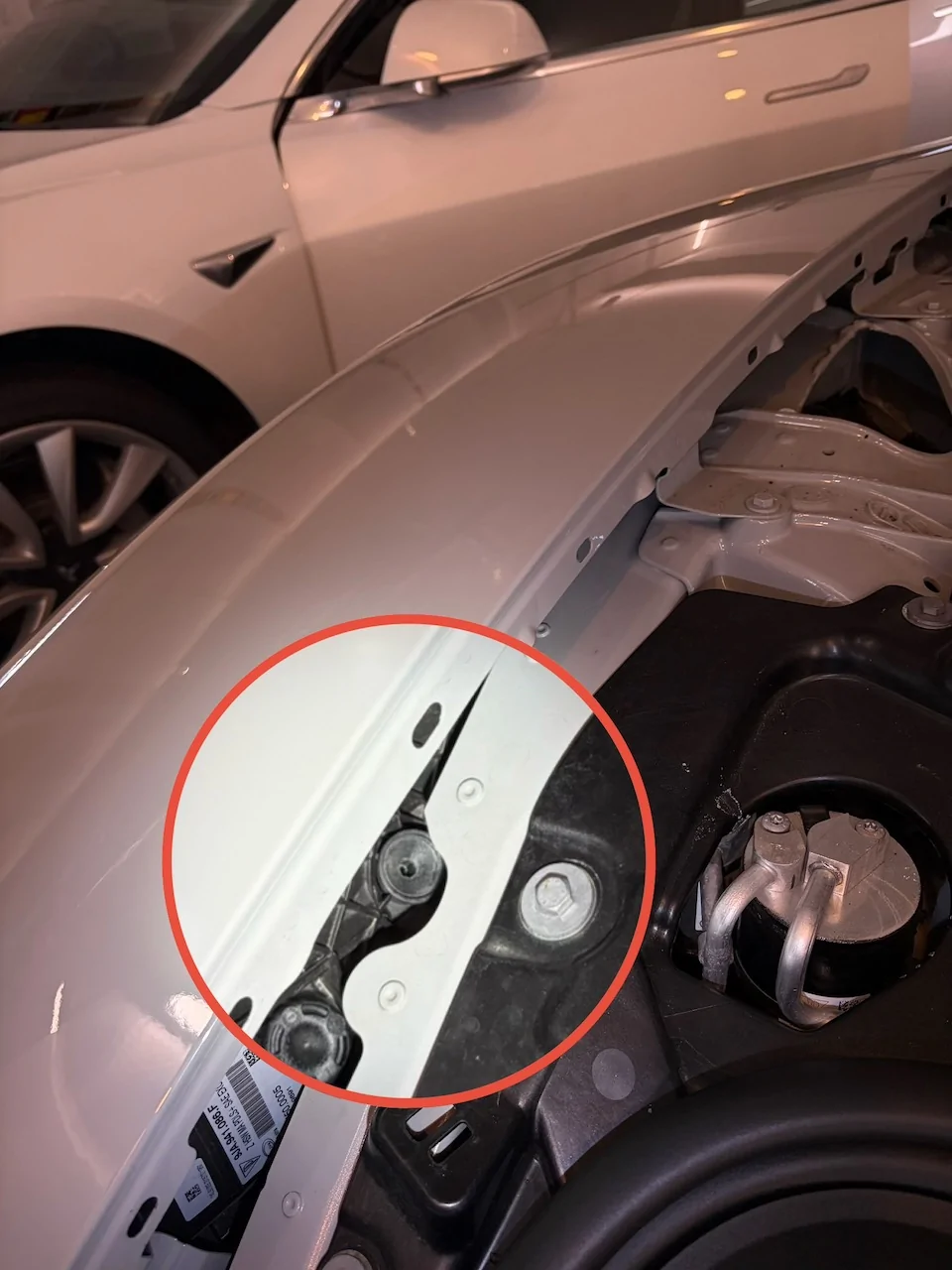

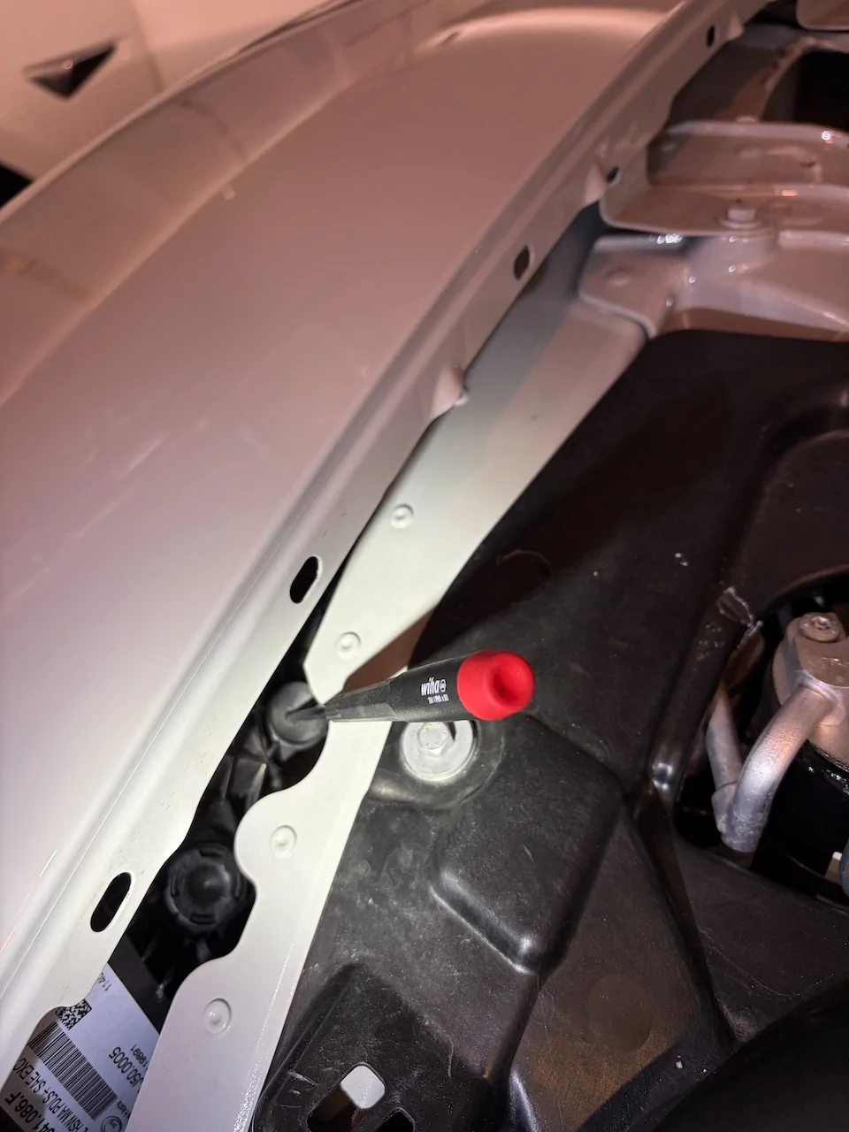

3. Headlight up/down adjustment
passenger side
Porsche Taycan DIY headlight up/down adjustment passenger-adjustment
with PH1 screwdriver
Porsche Taycan DIY headlight up/down adjustment passenger-adj-scr
driver side
Porsche Taycan DIY headlight up/down adjustment driver-adjustment

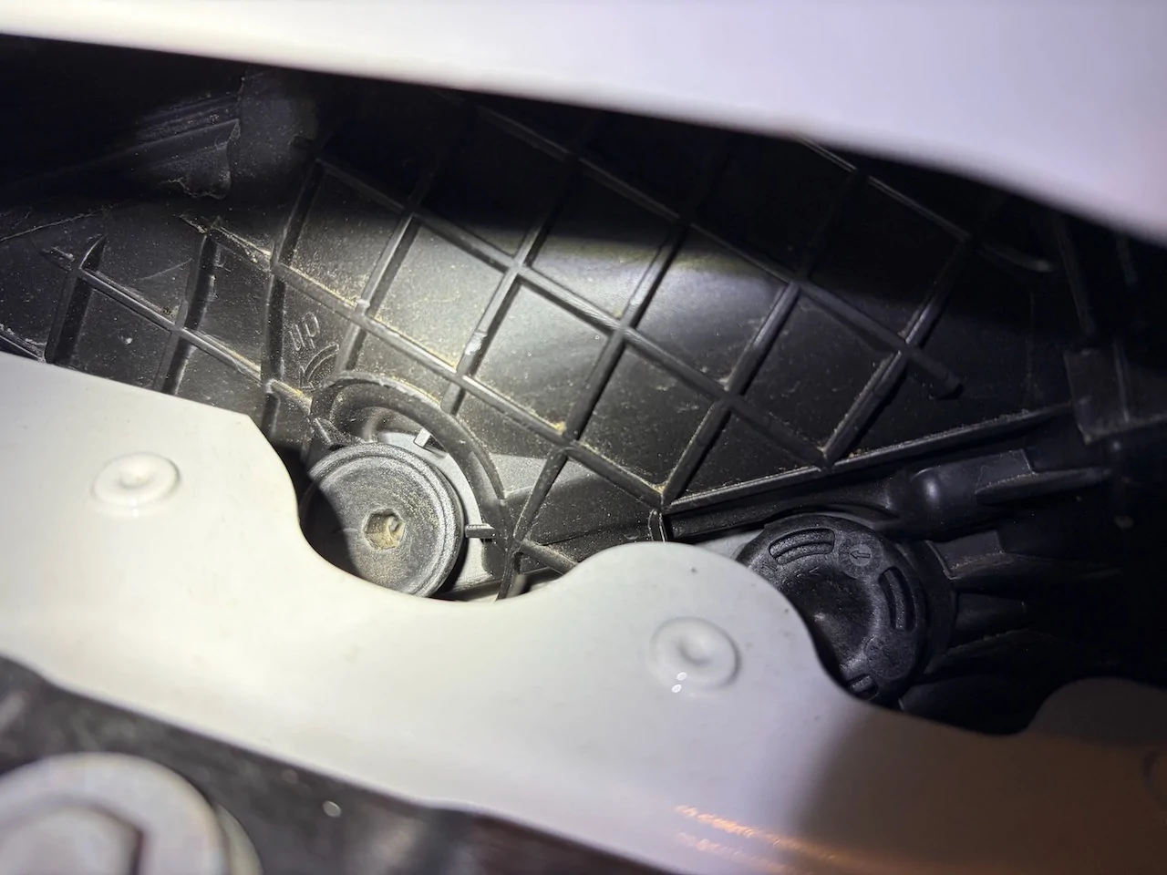

close-up of adjustment screw on driver side (note the "up" marking and arrow); as an aside I would guess the other adjustment with the cover is for horizontal aiming and should not be touched.
Porsche Taycan DIY headlight up/down adjustment driver-adjustment-clos
It should go without saying to avoid raising it to a point it causes glare to other drivers. There are many online guides for how best to aim your headlights (flat surface, tape on wall, measuring tape, etc). After adjustment, study your beam pattern to ensure it's not too high; other drivers flashing you would indicate that is probably the case. Make readjustments as necessary.
passenger side
driver side
