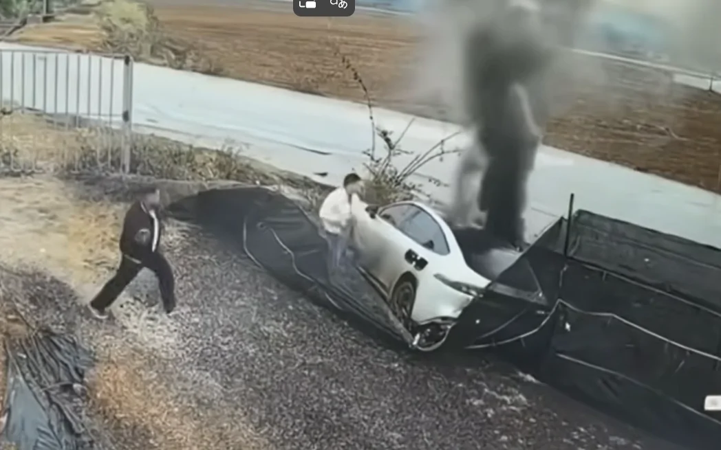

This one is pretty scary, so I would like to open this up for discussion to confirm that our handles are electronic first with manual/mechanical backup. This car was in flames in 60 second from impact and doors not possible to be opened from the outside with 4 passengers inside (1 front/3 rear).
Taycan has very narrow windows to be able to escape through.
Crash to Fire in 60 Seconds: Why China Banned Electric Door Handles - YouTube
