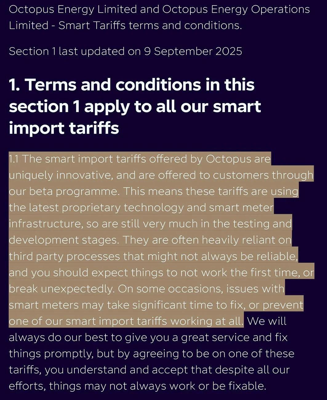

Resupplying Porsche credentials is part of the off and on process. One swallow doesn’t make a summer.
OIG and others are sold as beta products.
Many moving parts are involved, most of which are not under Octopus control, and there are many potential points of failure with immature error handling and no recovery or resilience. This may mean you wake up to find you don’t have sufficient charge to get where you need to go.
Ignore the hype. A timer plus a dumb supply are all you need.
