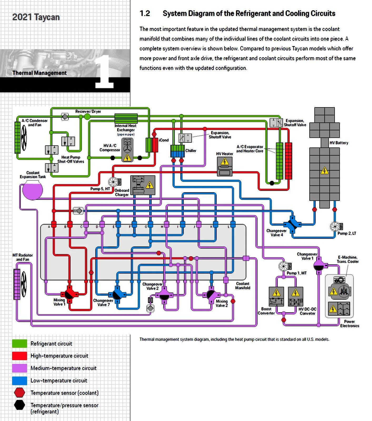

The heater is definitely playing a larger role than just heating the cabin - and it would be really nice if Porsche clarified this rather than downplaying its role.
1) it is the same heater that preconditions the battery. When mine broke in negative temperatures, the car at 350kw Ionity station won’t take more than 30kw/h
2) it plays a role in “energy balancing”. When the car is regenerating more energy than a battery can consume, this energy goes to the heater. When I had above 95% charge and broken heater, regeneration stopped working after the first attempt when the car realized it wasn’t able to discharge the generated energy. Now my heater is fixed and regeneration works (I mean the dial on dash and brake feeling) even if battery is 100% charged.
The sudden loss of regeneration led for a couple of hairy moments because the brake pedal feeling and travel without regen is verbal different.
3) I don’t know exactly what it means, but when my heater stopped working, the 12v battery would be showing 14v. When they fixed the heater (and when the old one was functioning) the dash always shows 13.5v for me.
maybe I am overthinking it a little, but I am reasonably sure that the heater is a part of a bigger picture. For example , would my 12v battery fail sooner because Porsche Assistance were driving my car for many hours with a broken heater on a higher than normal voltage?… who knows

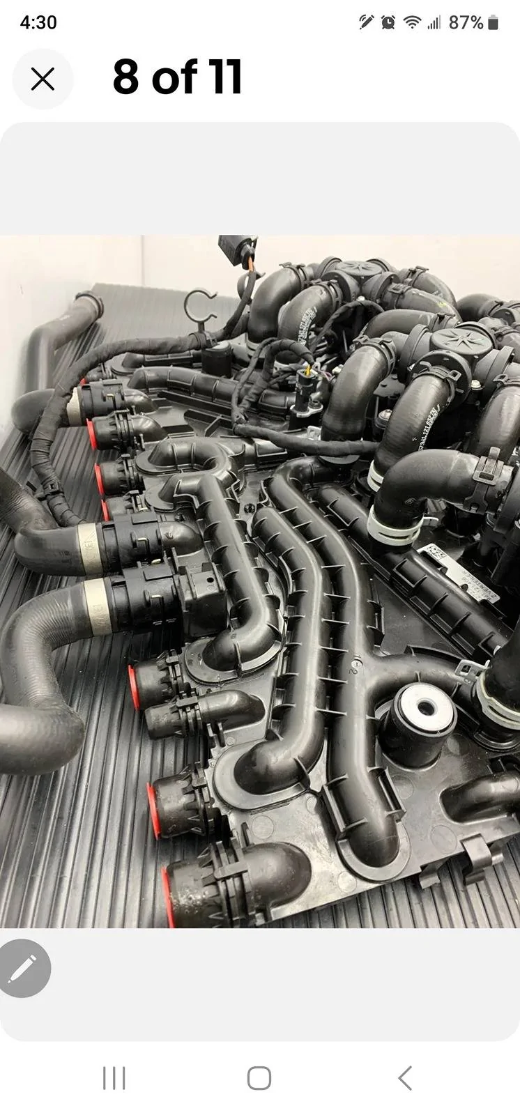

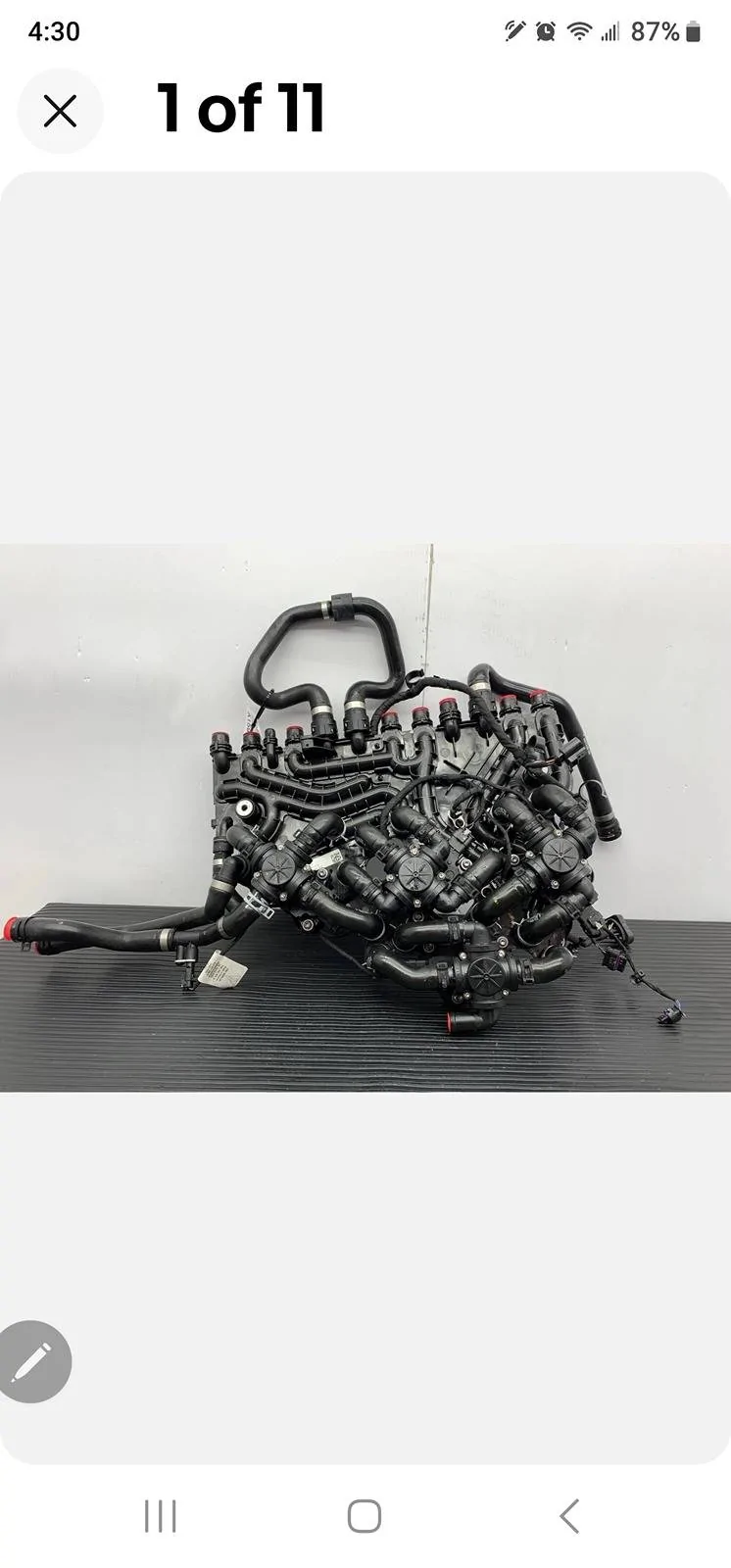

I was wondering if this part of the heater system? I'm sure someone will know this answer
Thanks David
Porsche Taycan Heater Recall Leading to Battery Issues? Screenshot_20230209_043014_eBay
Porsche Taycan Heater Recall Leading to Battery Issues? Screenshot_20230209_043026_eBay
87
