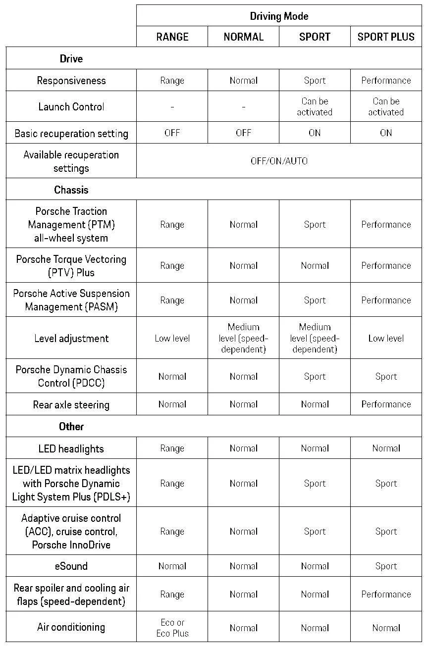

So . . . I was misbehaving a bit yesterday. I was taking a smoothed-out right-hand 90 degree slightly off-camber corner at about 50 mph and accelerating gently as I approached the apex.
I was in individual mode, which is based on Sport BUT I had adjusted the suspension setting back to normal for everyday driving. As such, rather than really being in Sport I believe I was closer to being in normal mode. I had forgotten all of this and thought I was in Sport. Also, my Taycan, a 4S Cross Turismo, has all of the suspension and assist options (and ceramic brakes).
In any event, between turn in and apex, I felt the rear passenger side of the car start to lift and then, rather abruptly, squat back down. I assume this was PDCC automatically adjusting from a less aggressive setting to a more aggressive setting based on the sensor detecting roll, right? Anyone here know?
This made me wonder, how do the various suspension options work together in the various modes, and, in each mode, when does it kick in to save you from yourself (and when does it so you can play with the car)?
I view the Taycan like a digital version of a car, and the older non-electronic granny race cars as the analog versions. On the older cars, if your car was set up correctly, the handling was rather linear (and therefore predictable) no matter what style of handling you preferred (e.g., slight under steer, slight over steer, LFB). With the digital versions, I think it is important (or at least interesting) to know when the car is changing your suspension on your behalf.
So, anyone looked into this or seen any articles about this?

This may answer some of your questions. .
Thank you. Yes, it is helpful up to a point (I had actually seen it, which led to my question). For example, take PDCC. I have the following two questions: (1) what is the exact difference between “Normal” PDCC and “Sport” PDCC; and (2) Will the car automatically change from “Normal” PDCC to “Sport” PDCC (i.e., without driver intervention) if the sensors detect that the roll of the car has exceeded a certain threshold?
My experience yesterday led to to believe that the answer to question 2 is ”Yes”, but it would be interesting to confirm and, if true, understand a little more about how it works. Getting answers out of Porsche is, well, challenging.
I have the same questions about the other suspension options, like rear wheel steering, PTM, PTV, etc . . .
