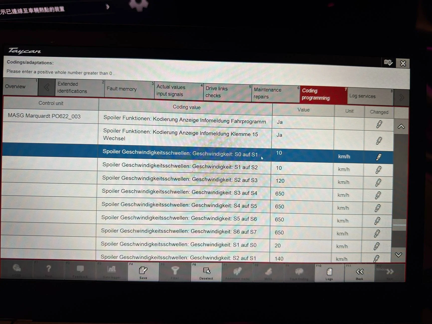

I am installing a permanent rear wing and would like to turn off the deployment of the rear spoiler. Is there a way to do this?

You can use PIWIS to change the value with speed <-> spoiler.
When the speed does not meet the conditions, the tail will not deploy.

Thank you for that. Where can you get PIWIS? I assume its a software package? Does it connect through OBD2? I have a blue tooth dongle and run CarScanner with it. Similar kind of deal?

I had the chance to try the clone version last week—it's quite an intriguing piece of work.
You will need PIWIS 3 and PTG3 (the connector).
Do you have a link to where these can be purchased?
I think 650 km/h is a bit optimistic.
Besides, it doesn't make sense cuz from S3 to S7 isn't speed related.
????? If I can drive 650 km/hr. -> it means the rear spoiler never retracts!
Yes only S0, S1, S2, S3 takes effect

I don't see a fuse explicitly labeled for the spoiler, but that, or it might be easier and more reliable to unplug a connector back there rather than clone PIWIS reprogramming. I believe there are posts that show R&R of the spoiler as part of modifying/lighting the PORSCHE logo. I was thinking of WhiteX's project here.
Helll you can help me I have a taycan turbo 2025 and I bought Weissach wing I try the same of these picture but the wing is normal no change the fuction to go off

I would also like to deactivate the spoiler, however, an error message appears at speeds above 160 km/h. Does anyone have an idea how to completely disable the spoiler?
