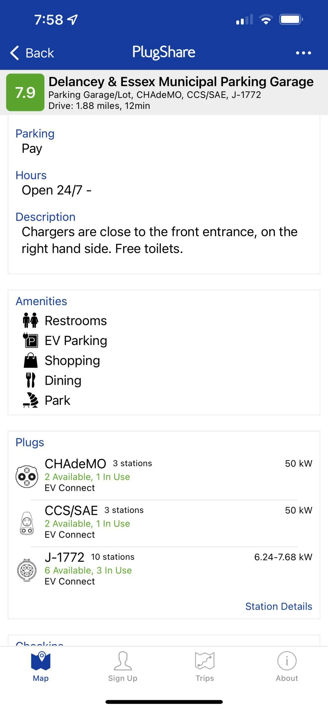

Thanks! The PlugShare app is very helpful. Using it I actually found this parking lot that looks like a self parking lot with some DC chargers (although they’re 50kw). Am I reading this correctly and the CCS plug should work with the Taycan and enable 50kw charging? If so this could actually be a viable option even though 50 kw isn’t the fastest. I should mention also that I would be using the car mostly for weekend trips (I live and work in Manhattan), so don’t anticipate needing to charge more than once every couple of weeks.
I’ll also check around my local garages to see what options there might be to plug into to an L1 socket or have attendants slot me into an L2. The garages near where I am seem to be a cluster**** like many garages in NYC, so if possible to avoid having to have the valet play Tetris with cars and chargers that would be ideal!
If you are generally going to be using the car on the weekends, you dont need a garage with a DC fast charger. There are many garages in Manhattan that have slow chargers available. I just looked at ICON parking (pre-covid i had a monthly parking contract with ICON in midtown). They have over 60 garages in NY with slow chargers. I am sure the other garage companies offer similar services. Find a garage with j-1772 chargers and get a monthly pass. Just ask the garage guys to charge the car overnight one night during the week and you will always have a full charge when you pick up the car on the weekends. If you road trip then use Electric America fast chargers which are relatively plentiful in the tri-state area. Lastly, get a TESLATAP so you can use tesla destination chargers (which the ICON garages also have). If you dont get a monthly pass at a garage with a charger and get this all set up, you will hate driving an EV. If you get it all set up, you will love it.
