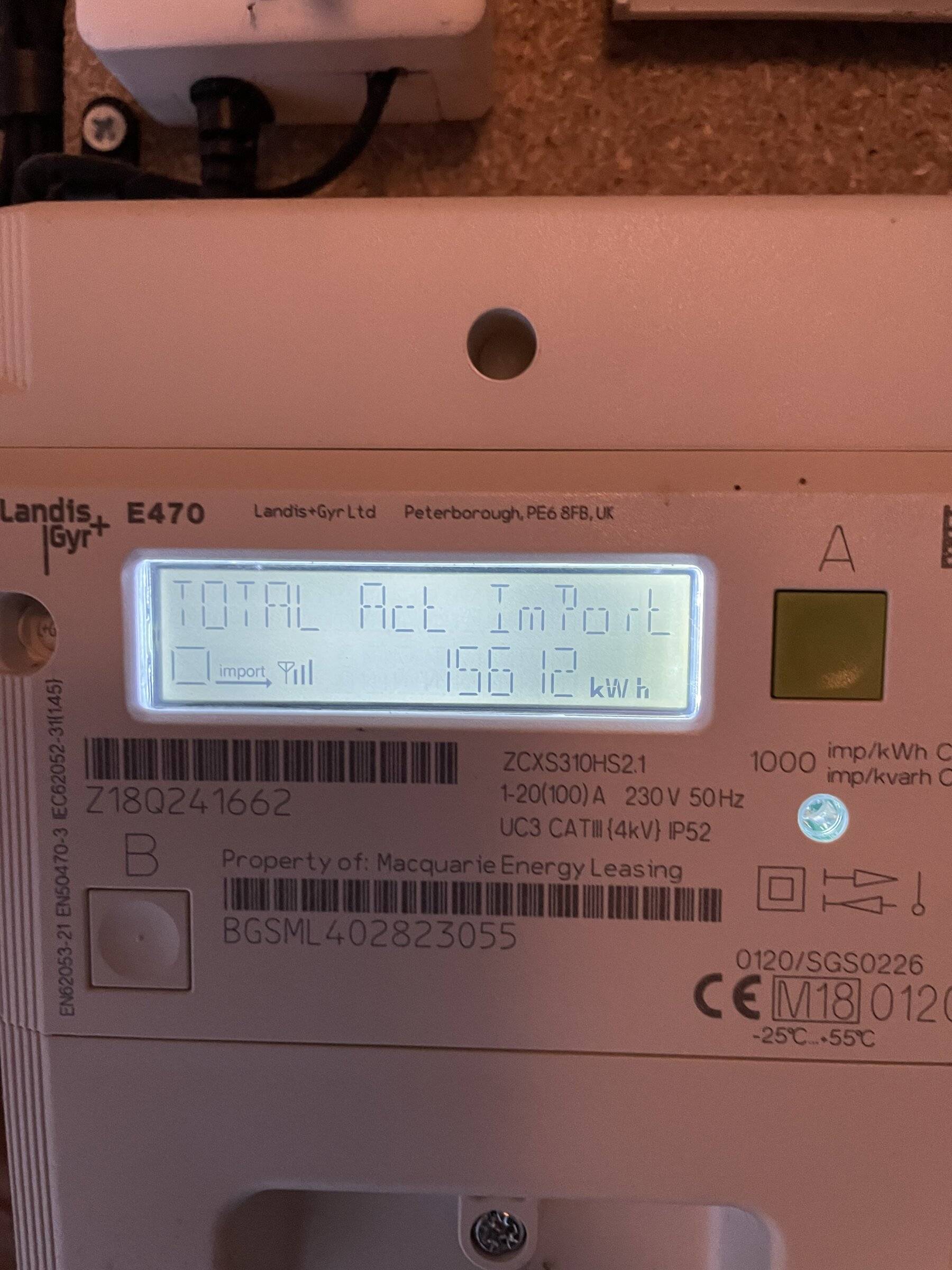

Thanks that’s really kind. Mine is a Landis. I know Octopus have always said they can only support smets1 meters made by Secure. Cheers

You meter is absolutely fine and it does support both features.
½ hour (or 30 minute profile) as well as 2-rate tariffs.
So there should not be any issue on the metering side.

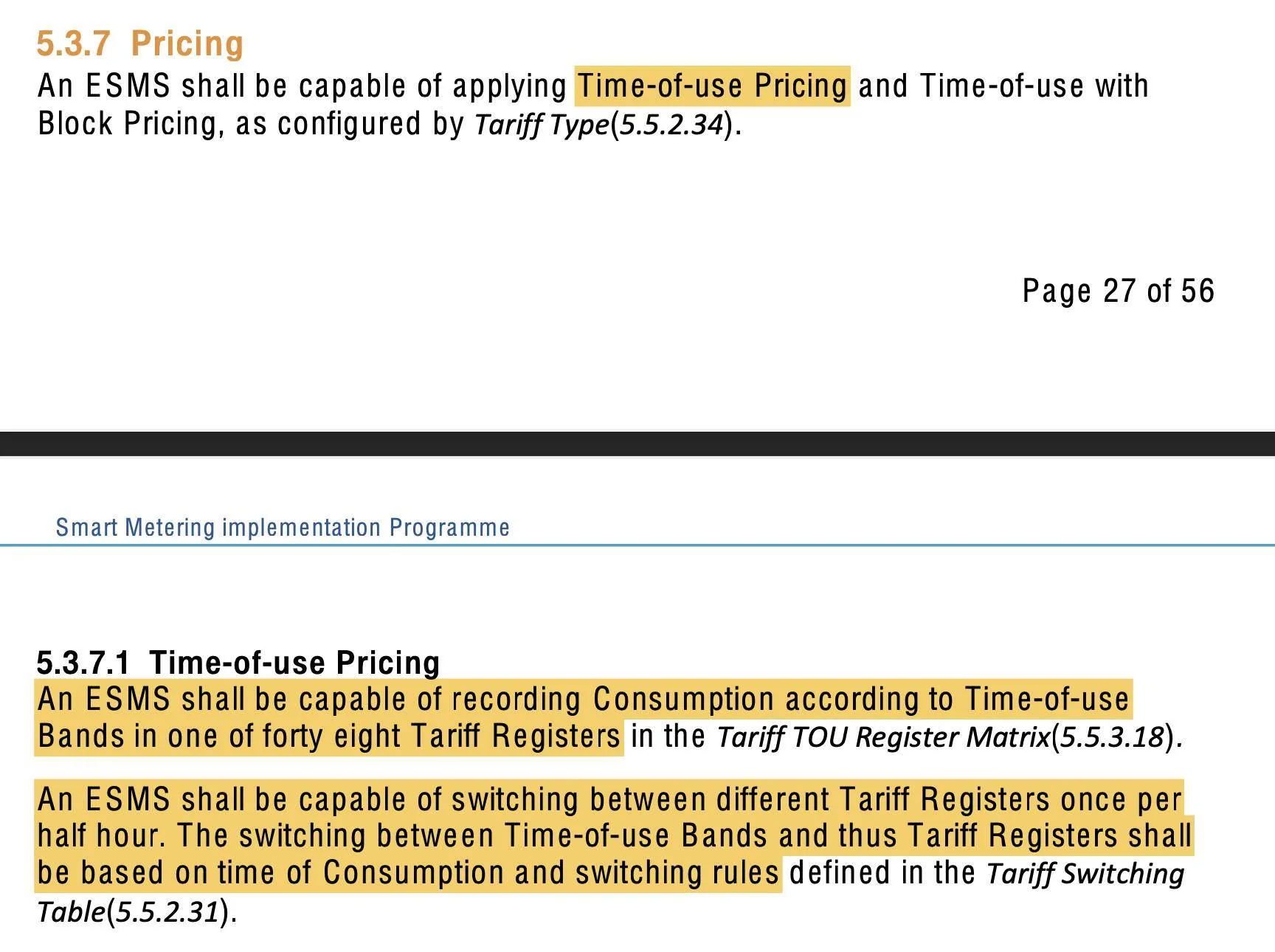

Attached is the SMETS1 standard specifications. See page 27/28.
Porsche Taycan Off-peak charging: Stuck with old Smart Meter (SMETS1) 1652268151786
Speak to Octopus
1) Inform them that you have a DCC enrolled SMETS1 meter and that this meter would not have been enrolled (if it did not meet the SMETS1 standard).
2) All Octopus needs to do is to send a config to the meter to enable 2-rate tariff.
3) Octopus need to execute a change tariff command on their business system to send a 2-rate tariff to the meter.
The command is DUIS SRV 1.1.1 (Update Import Tariff - Primary Element)
4) If Octopus also want to read the 30 minute (½ hour data) the
command is DUIS SRV 14.8.1 (Read Active Import Profile Data)
If Octopus state that your SMETS1 meter has NOT YET been enrolled (regarding Point 1), then inform them that is an energy suppliers obligation to either enrolled the SMETS1 meter or replace with SMETS2.
Say that you intend to complain to OFGEM - as you as a consumer is not able to get an appropriate tariff for your property due to Octopus policy.
Hope the above gives you enough ammunition to talk to Octopus and get your tariff.
(Assuming you are able to get a 'sensible' call centre operative on the other end, who can understand this !)
Good luck !
