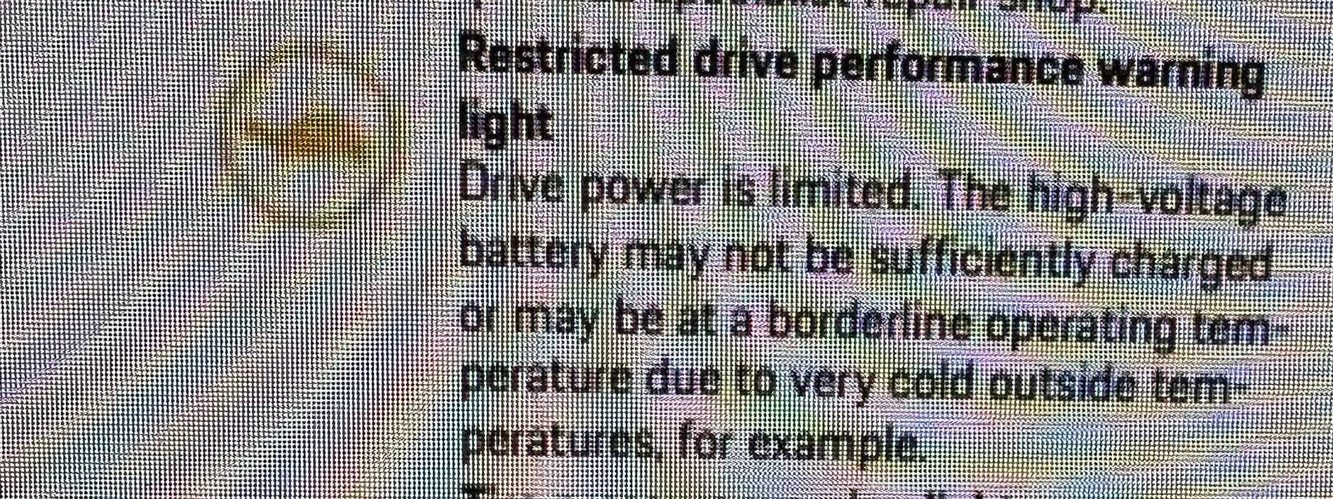

I found same information related to the turtle in the manual and yes because the battery was almost out of charge (well at least something working as it should?
