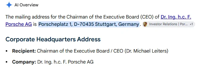

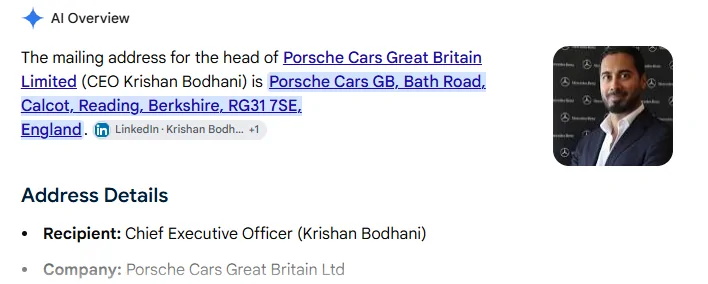

Take it to a different dealer. Mail a letter with copy of your post above directly to the senior manager of Porsche GB and the CEO of Porsche AG.
