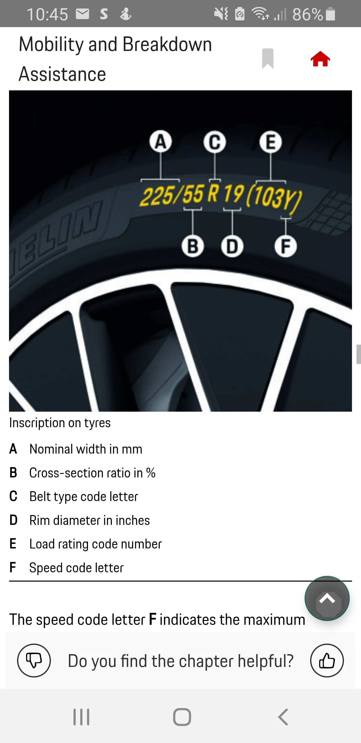

I have a ST RWD with PB+. I'm looking for other wheels but can't seem to find the required load capacity. Does someone know?

Is this what you are after?
Not the tyre but the wheels load rating. But i found this explanation: To find your wheel load rating requirements, divide your vehicles heaviest gross axle weight rating by 2.
On my car documents it says 1280 and 1545 kg. So 1545 / 2 = 772,5 kg.

Dumb question but why do you need it?
