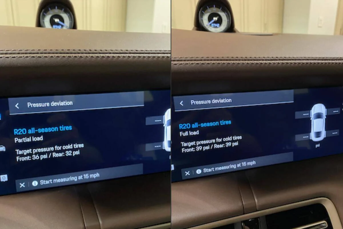

What are people driving at, the Full Load setting or the Partial Load. I was surprised at the difference in the stated pressures for the 20 inch all-season tires.
Porsche Taycan Tire Pressure - Full or Partial Load? Screen Shot 2020-10-22 at 8.09.03 AM

I am running half load pressures in my 4 S with 19" wheels. In my Cayenne if I run full load tire pressures with light loads I would see slightly increased center tire wear. YMMV

I run the partial load pressure per the PCM. Note that the tire pressure label on the driver's door jamb is for full load.

I use 40 psi (2.75 bar) at 68F (20C) on all four wheels for partial load (Turbo S). Perfect and easy to remember.
