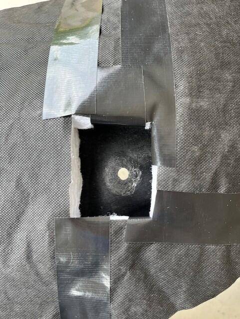

Above is a pic showing how I left a large void, this time, in the areas surrounding holes in which bolts/fasteners would need to protrude during re-installation. Last time around I just poked a little hole through the Thinsulate with an X-acto knife -- which did not make life much easier for me during re-assembly.

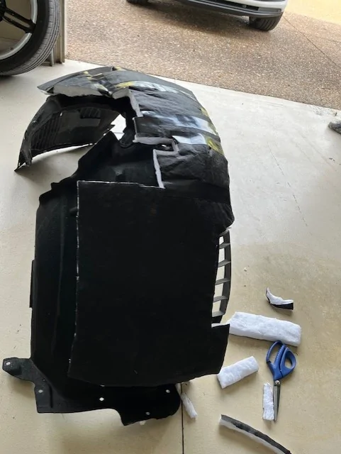

Above is a pic of the liner cover construction in progress. Last time around I applied the Thinsulate like a blanket around the liner and cut-out wedges in order to get the Thinsulate to lay flush against the liner without any wrinkles. This time, I constructed my sound absorbing layer from several smaller pieces and taped them together with my trusty Gorilla tape. This proved to be much easier than the former process. And I suspect that having several small pieces of sound absorber vs. one large piece makes no difference in terms of efficacy.
Total time spent on this morning's install was about 2.5-3.0 hours in total (including coffee breaks, washing the liner, cleaning all the gunk under the liner, etc.). The most time consuming part was fabricating the liner cover from the Thinsulate.

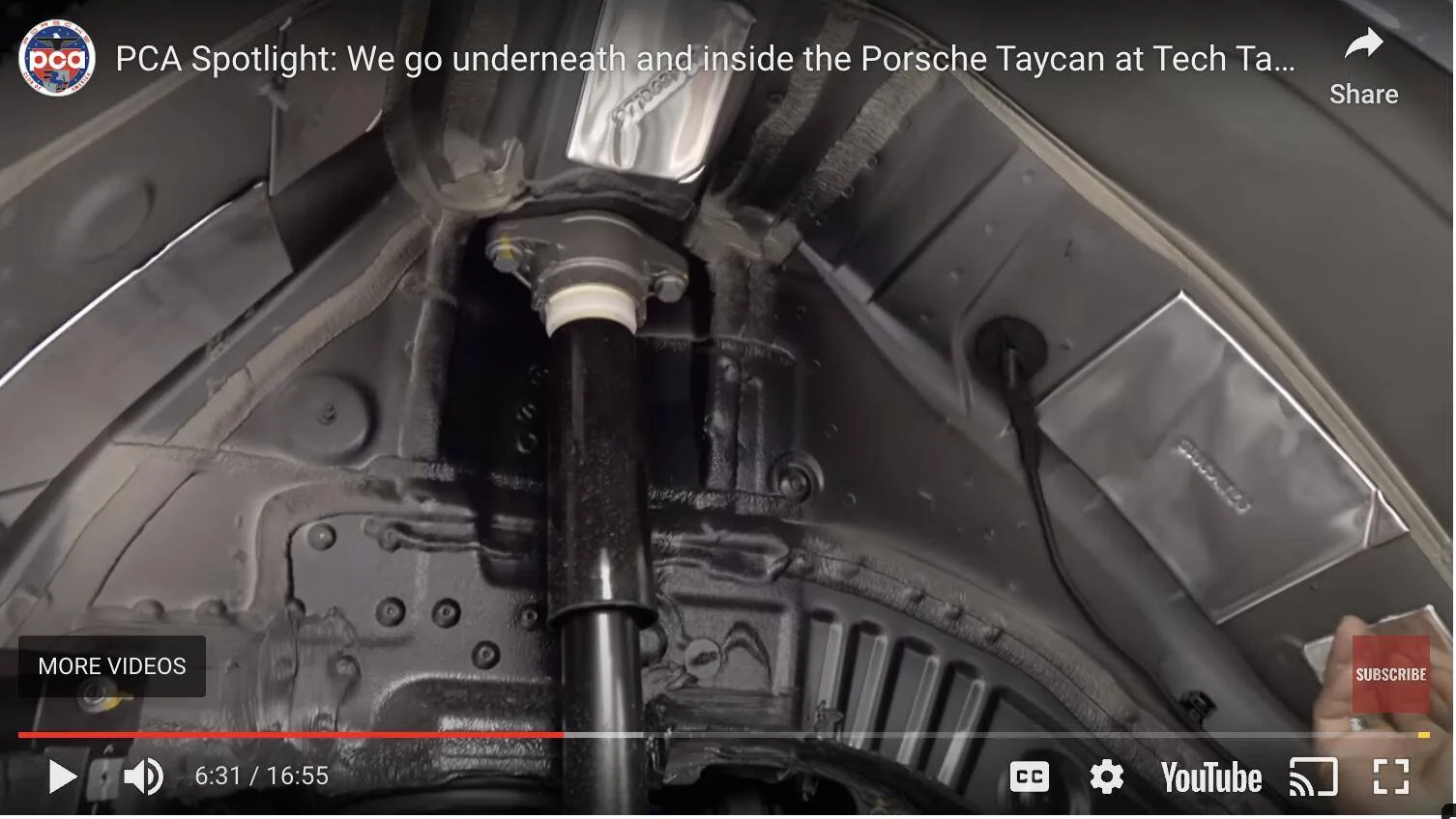

Update on road noise project. Yesterday afternoon, I finished installing sound deadener and sound absorbers on all four wheels. I have not yet had the chance to take a long drive with my trusty Amazon dB meter to quantify the results, but subjectively the noise level is much improved. I'll take a few dB readings at different speeds, hopefully today, and post the results. One very interesting, and very disappointing, observation while tackling the rear wheels is the following:
Porsche Taycan Road Noise Screenshot 2024-06-30 at 9.46.03 AM
Above is a screenshot from an early video examining the tech in the new Taycan. In the video, the Porsche rep made a big deal about the pieces of CLD affixed to the rear wheel well as a means to keep the car quiet. After researching auto sound deadening (for a longer time than is probably healthy) my initial conclusion was that Porsche's attempt to reduce resonance in the wheel arch was half-assed and not likely to make much of a difference. After removing the wheel liner, I discovered that Porsche apparently reached the same conclusion because the little pieces of CLD pictured above were nowhere to be found on my car.
