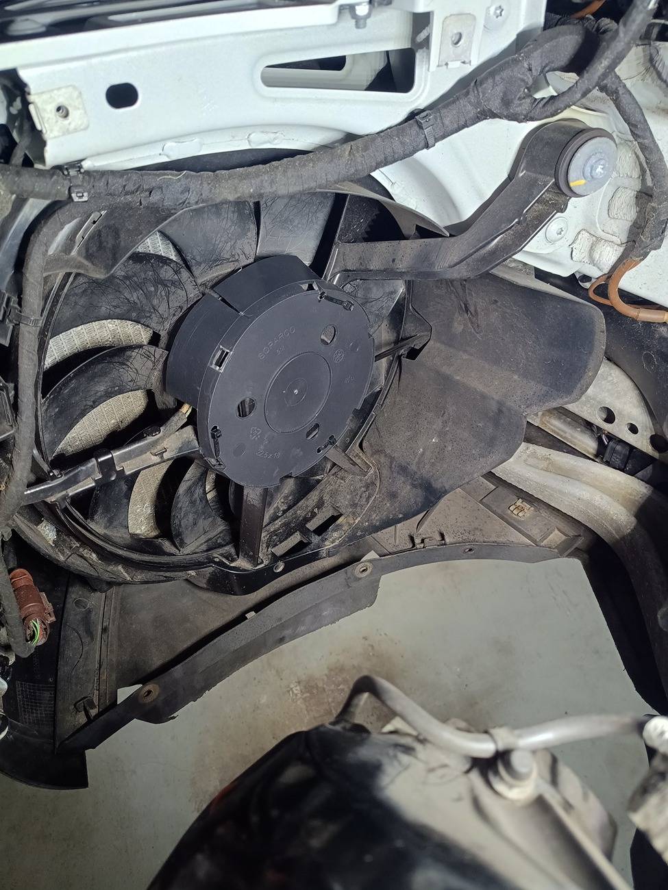

To my astonishment, the fan was turning perfectly. I thought I was losing the plot, how could it be freely moving when I had given it everything before with no luck. Then after a few minutes of head scratching I noticed this:
Porsche Taycan Seized cooling fans and my solution 1762118990855-o
The fan has been replaced with the upgraded version. In my state of disbelief, I check the drivers side and this has also been replaced.

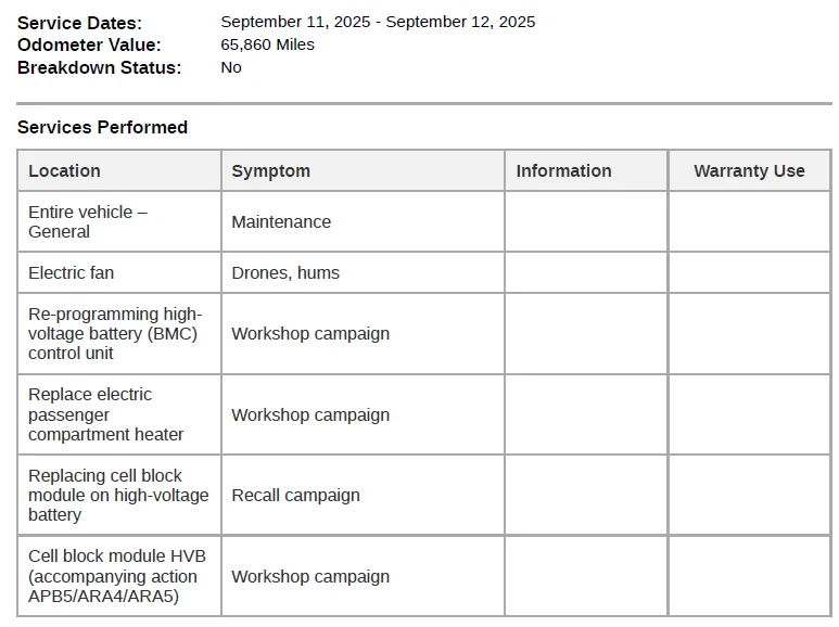

If I hadn't decided to check this I would have had no idea that they had been done. I went on to Vinanalytics and paid for the service report to see what was showing and it appears to have been done at my local centre when it was back in for the battery monitoring software in September, although I note it doesn't show as a warranty job. There is no way Porsche would do this out of the goodness of their heart surely...
Porsche Taycan Seized cooling fans and my solution 1762119908273-q

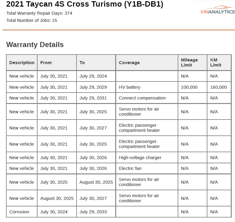

Appreciate that Vinanalytics may not be entirely accurate, however there is some interesting info on warranty cover. As mentioned I believe the car is out of warranty and I haven't extended it, however based on this, it would appear that the electric fans, HV charger, and heater are warranted until 2026/2027:
Porsche Taycan Seized cooling fans and my solution 1762120622938-yq
It's interesting that onboard chargers, radiator fans and heaters are prone to failure, and these are the parts that have warranty extended. Am I reading this correct that these parts will still be covered, and is anyone aware of Porsche doing this?
