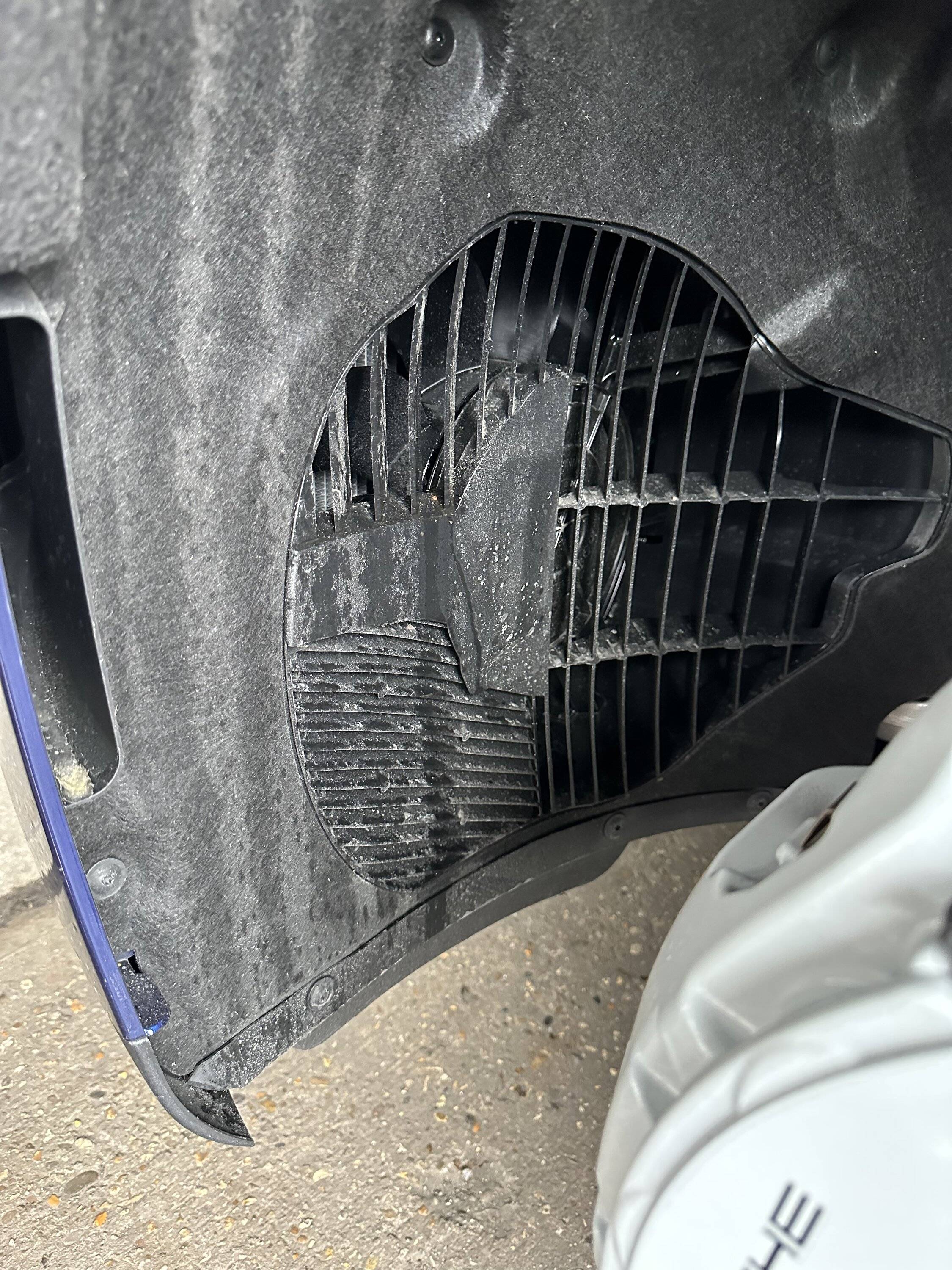

Has anyone got any photos of the updated fans / arch liner design?

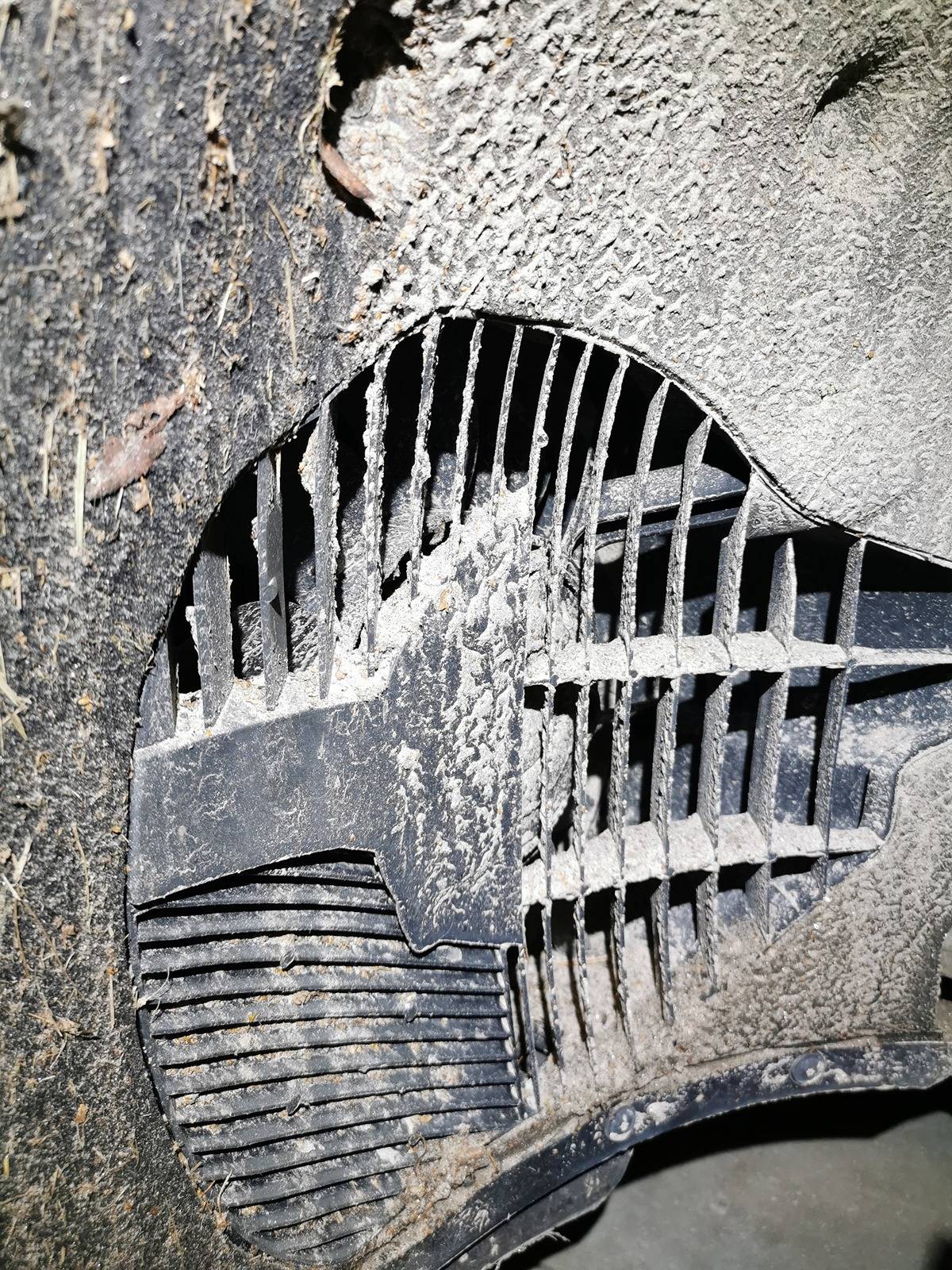

Stones removed during every service visit (ie. many times) and finally swapped to a new design under warranty.
A real life photo here.. who would have thought there will be stones flying inside the fender..
Is that the “new” design?
Looks the same as I posted last year on my MY23 car?
They are pretty exposed inside the wheel arch to be fair….

This is the old one. Can't take photo of the new as the car is still in warranty service 260 km away..
