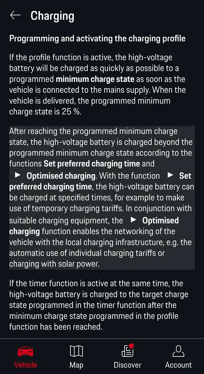

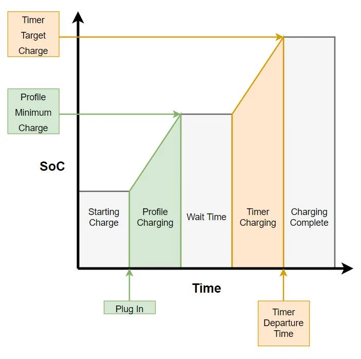

This makes it clear:
The thread starter can achieve their aim by setting only a Profile. No timer is required.

I understand: the "minimum charge" setting is also maximum, if no timer is set.
I will try this today.
Until now, I thought it is not possible to make the car stop charging at 85 % UNLESS a timer is set with a designated time and soc to be reached at that set time.
Nonetheless: it would be easier just to set a maximum soc that overrules everything else but that setting option is not available in the Taycan.

Success. This is a small deal-breaker to me.

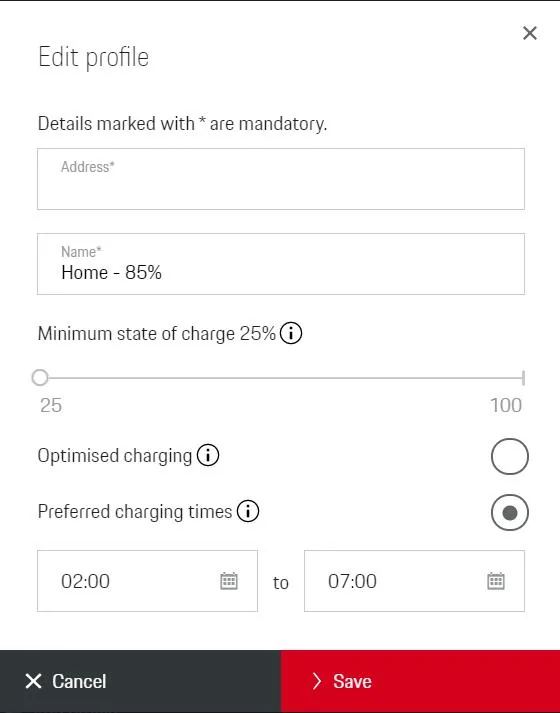

Daily timer and profile for preferred times attached. Specific to MY20 - MY24 J1.
Porsche Taycan Taycan charging question Daily Timer
Porsche Taycan Taycan charging question Profile - Preferred Charging Tim

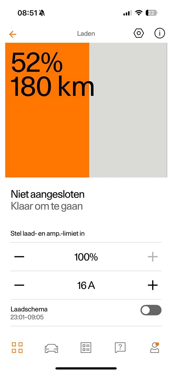

It could be so much simpler. Look at all the topics and questions on this forum. Just a charging limit and timeslot will be understood by everyone without reading the instructions. How easy is this, clear settings for limit, power and timeslot:
Porsche Taycan Taycan charging question IMG_5211
And I do understand how it works. But mine is just broken ?
