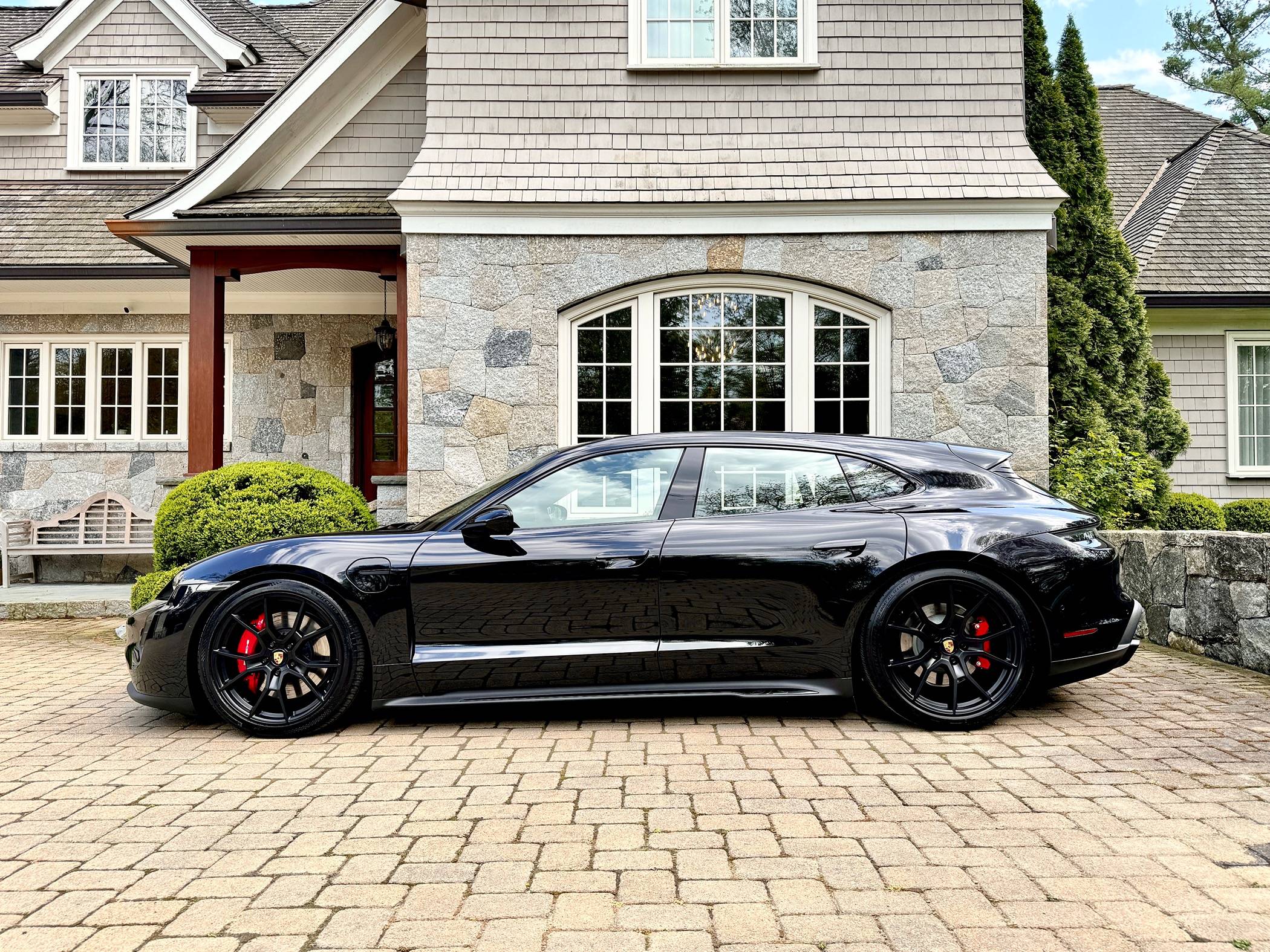

I also have a 2023 ST GTS in black and I added 12mm spacers up front and 10mm spacers in the rear. I also lowered my car slightly with FVD lowering links.
I have no rubbing issues whatsoever, and I live on a private road with large speed bumps. I do raise the car into Normal mode whenever I drive over the speed bumps, but that is mainly to prevent the front spoiler from scraping and to avoid any possible damage to the underside of the car. I have never experienced any rubbing within the wheel wells.
You may want to jack the car up and look up inside each wheel well to make sure there is nothing protruding from the fender liners. Perhaps one of the clips in the fender liner came undone and that what might be causing the rubbing?
Here’s a few pics of my setup.

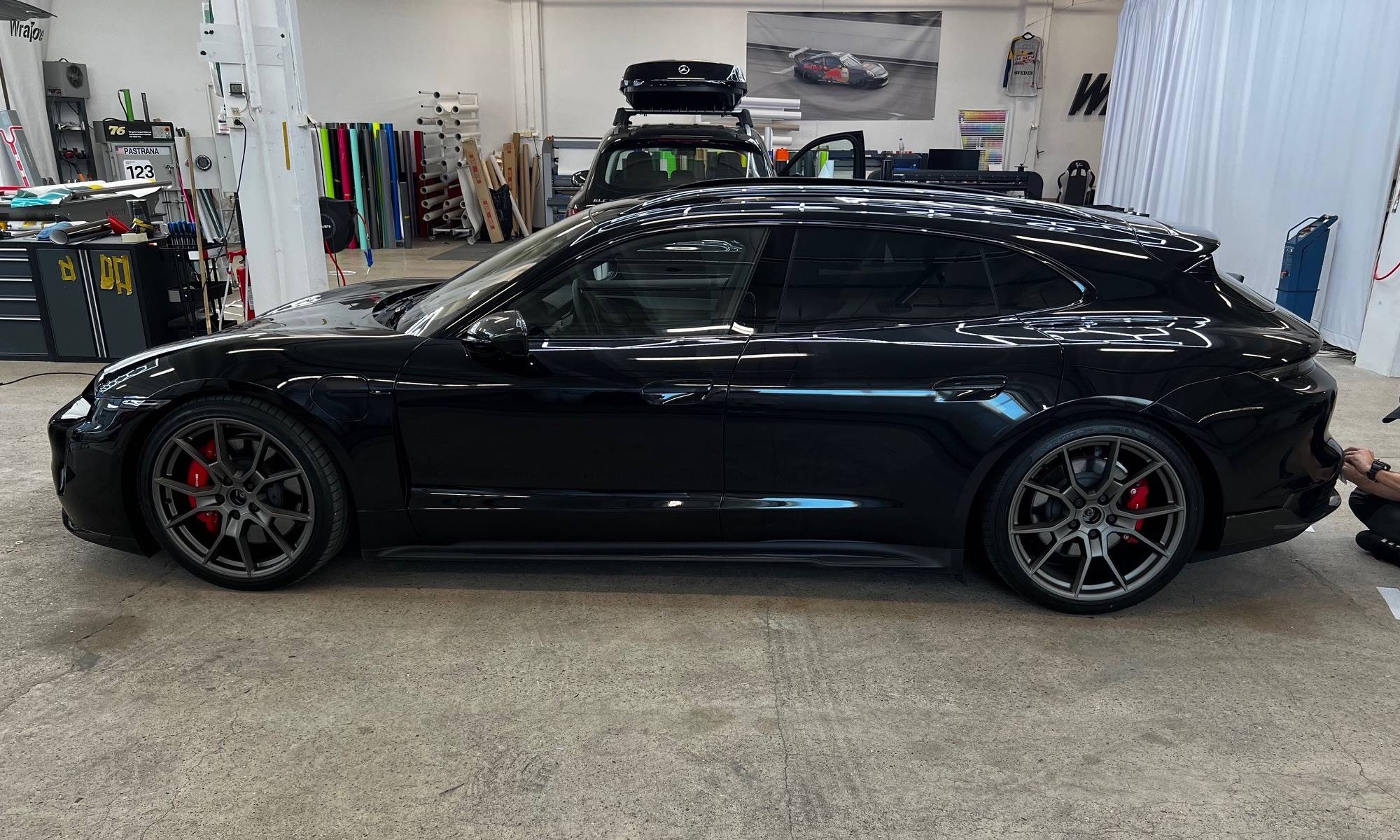

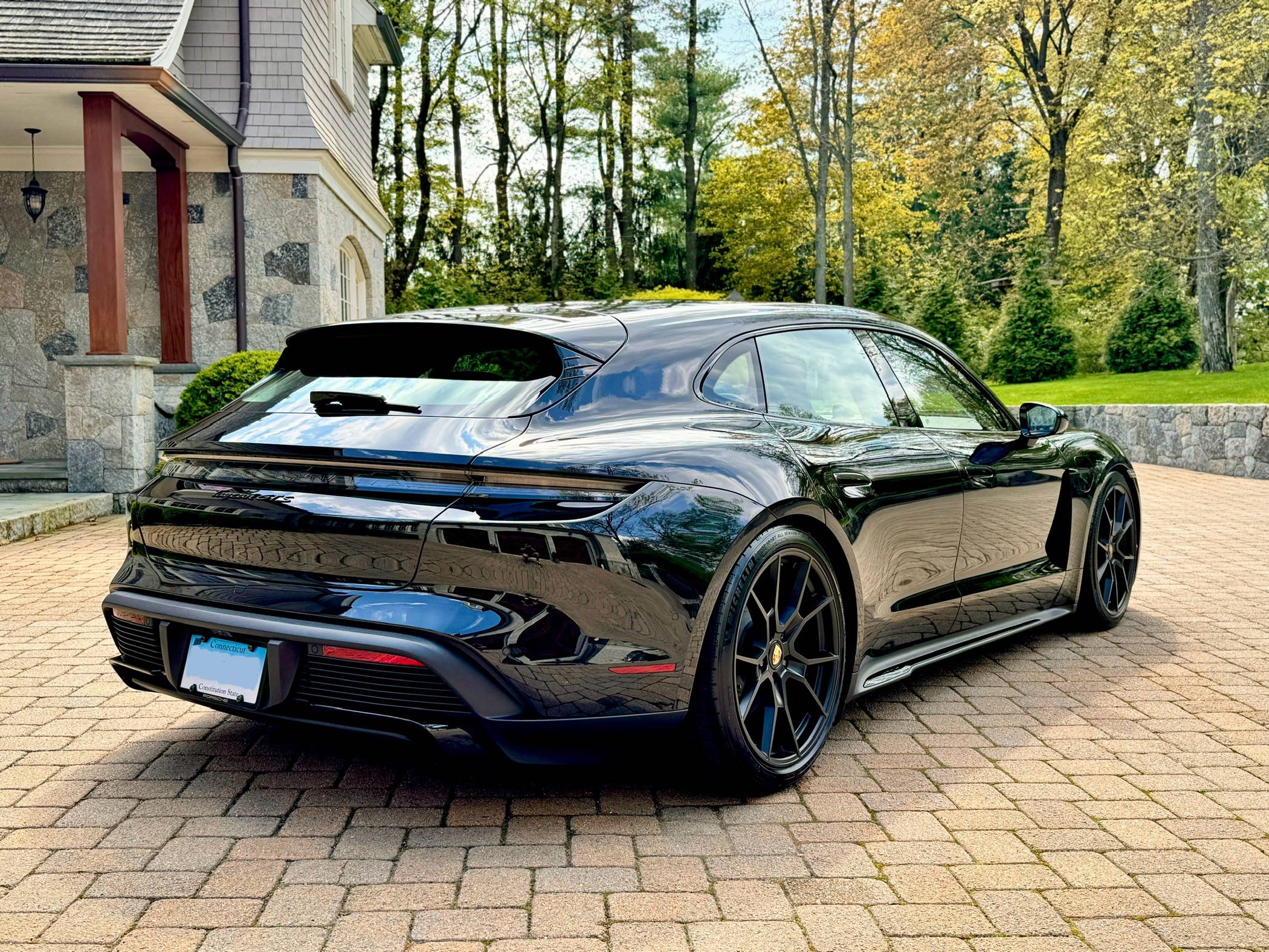

Thanks for the tips, I'll have a closer look inside the wheel wells when I visit my tyre dealer to remove the spacers on Friday, to see if there are any obvious screw head or fender clip issues.
Your car looks great with the low stance, and the tyres fill out the wheel wells nicely! I also like the non-tinted rear windows (prefer those myself).
I've had 4 x 10 mm spacers on my previous RS6 Avant C7 and Golf R Mk7 with no issues at all, and I also have 2 x 5 mm upfront and 2 x 7 mm in the rear on my current Cayman GTS 4.0, so I was quite surprised to discover this problem on the Taycan. I've just taken a second local drive, and when I have the chassis in the second lowest height there are no issues, it's only noticeable in the very lowest setting — but on the other hand, these particular speed bumps (and even some bumpy creases in the asphalt from undergrowth) were never an issue before.

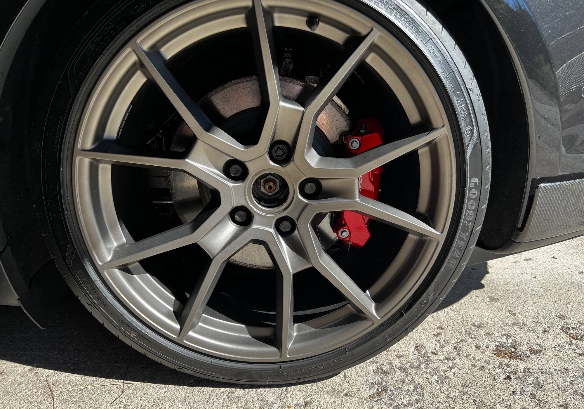

I'll get around to take some professional photos of the car once I have everything in place (I'm still waiting for the rim center caps in Platinum Satin with a monochrome crest), but below is a couple of quick photos that I took earlier today when I had the car over at WrapZone for putting PPF on the rear red reflectors (to tone them down a bit).
To achieve the monochrome look that I want I've also replaced the coloured hood crest with the new Turbonite crest, which I think suits the car perfectly (the only bummer now is that the brake callipers are red; on my Cayman GTS they are black and thus "disappear" within the wheels :).

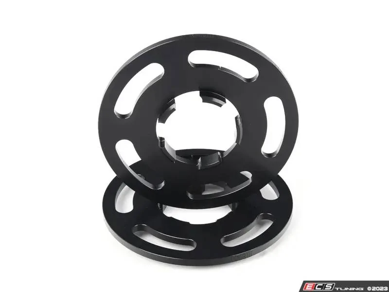

Hey @Emm - can you post a couple photos of the 7mm spacers themselves if/when you have a sec? (and if you still have them) Curious what they actually look like (hub extension etc., considering the slim size).
Thanks,
Brian
Emm
Mark
May 8, 2024
51
Sweden
2023 Taycan GTS Sport Turismo MAPEV + 2014 Audi RS6 Avant APR
Thanks,
Brian
I'll try when I get the opportunity -- I left the spacers at my tire dealer's garage and more or less forgot about them :–). Right now I'm contemplating whether I should get a new set of 20" winter rims (with new 20" winter tires); if I should just get a set of 21" winter tires and switch on my current RS Spyder rims; or if I should just leave the summer tires on and let the car more or less stand still this winter (I also have an RS6 that I will drive instead during the winter).
Meanwhile, here is a link to the store where I bought them (I got the ones in black, but they're available in silver too):
https://www.bilmodecenter.se/product/h-r-spacers-porsche-taycan-2019-5
Hope this helps.
PS. Let me know if you'd be interested in these, as I probably won't be using them...
bwherry
Brian
Feb 19, 2022
156
114
Los Angeles, CA
'23 Taycan GTS ST, '22 BMW iX xDrive50
Thanks for the reply, @Emm . Nice to not have to worry about winter tires here in Southern California! I don't think I'll need any spacers on my new wheels, but sort of doing research just to be prepared... and thanks for the offer for yours, but as I'm in USA and you're in Sweden, I think the shipping would be cost prohibitive haha.
If and when you can access your actual spacers to snap a few photos, I'd love to see them - but no rush. I was curious to see your actual spacers, to see what the little "hub extension" parts look like, if present at all.

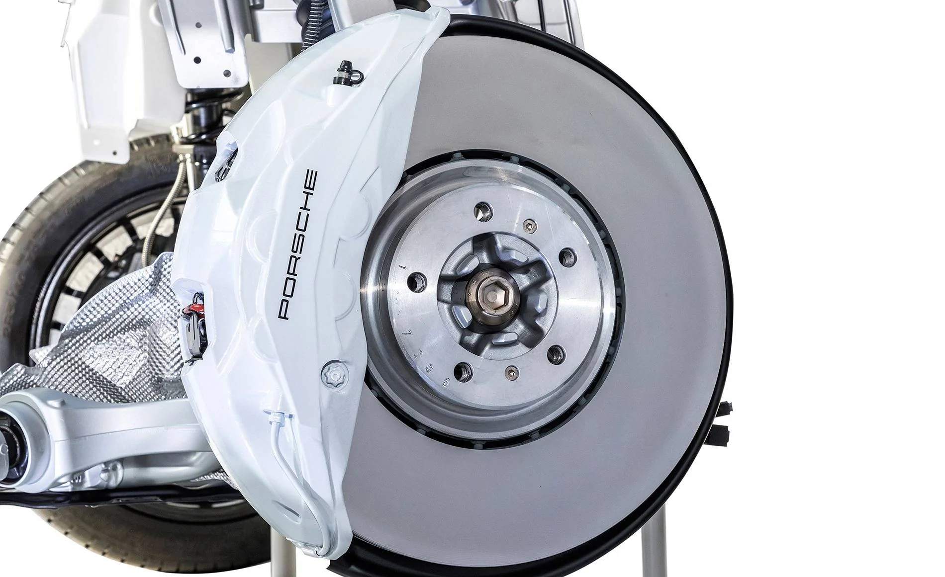

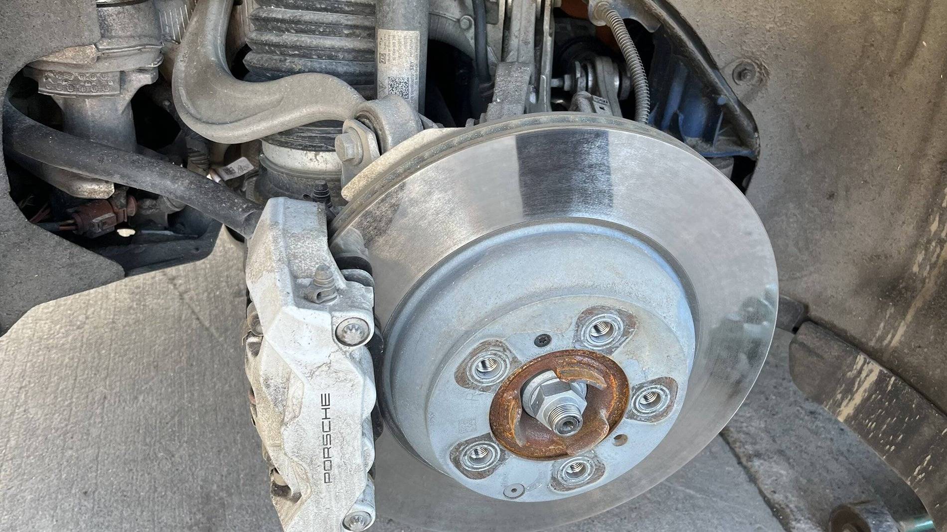

The part number that H&R lists for 7mm Taycan spacers is 14957160Z (14957160ZSW for the black ones), which is the same part number that they list for the 2019 Cayenne. The ECS Tuning product page for those include photos of what appear to be the actual spacers. Looks like this:
Porsche Taycan Unexpected issue with H&R spacer kit 7 mm all-around 14957160ZSW
You can see the five little hub "extensions" to make the spacers hubcentric. This jives with the 2019 Cayenne, as its hub isn't a continuous flange, but five separate flange sections - or "flangelets" so to speak:
Porsche Taycan Unexpected issue with H&R spacer kit 7 mm all-around 2019_cayenne_brak
So the little bits on the spacers fit into the gaps between the hub flangelets, like a little puzzle.
But the hubs of the Taycan have only three flangelets:
Porsche Taycan Unexpected issue with H&R spacer kit 7 mm all-around taycan_brak
So I was curious to see if your 7mm spacers have only three little hub extensions - or none at all!

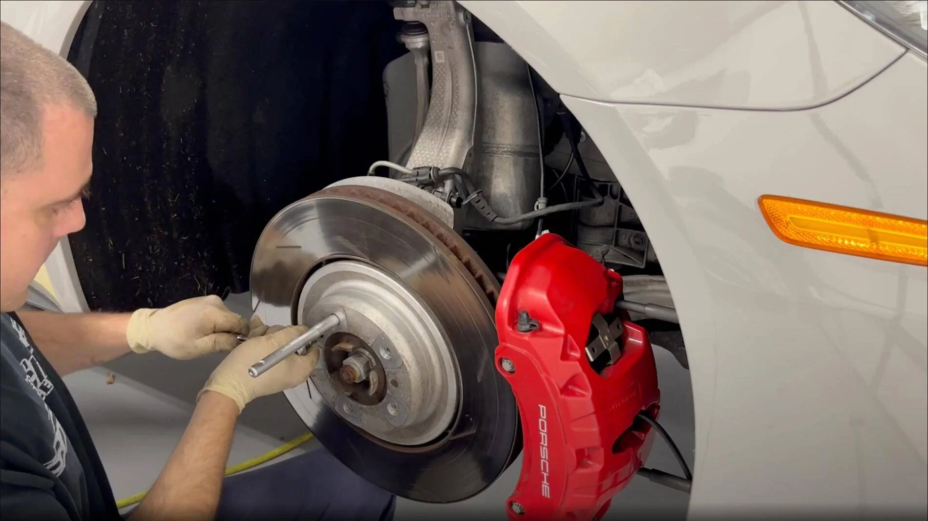

Actually using the part number on the page you linked to (14957161Z), it seems those are for the 971 Panamera, which, as it turns out, has the three little hub flangelets like the Taycan:
Porsche Taycan Unexpected issue with H&R spacer kit 7 mm all-around panamera_front_brak
(image grabbed from YouTube of a guy changing the front brakes on his 971 Panamera ST)
So I think the H&R TRAK+ application finder might not be listing the correct part numbers for 7mm Taycan spacers... I wonder if they make any 5mm spacers with those little hub extensions too...
