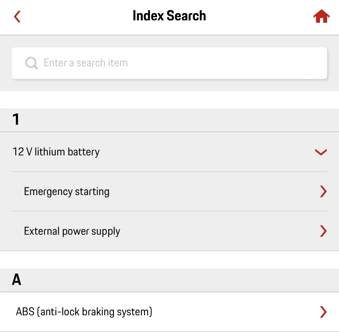

Your experience is puzzling. The very first topic that comes up in the index of the owners manual is 12 V battery.
Porsche Taycan Where are 12 V battery terminals???? 1666952767969

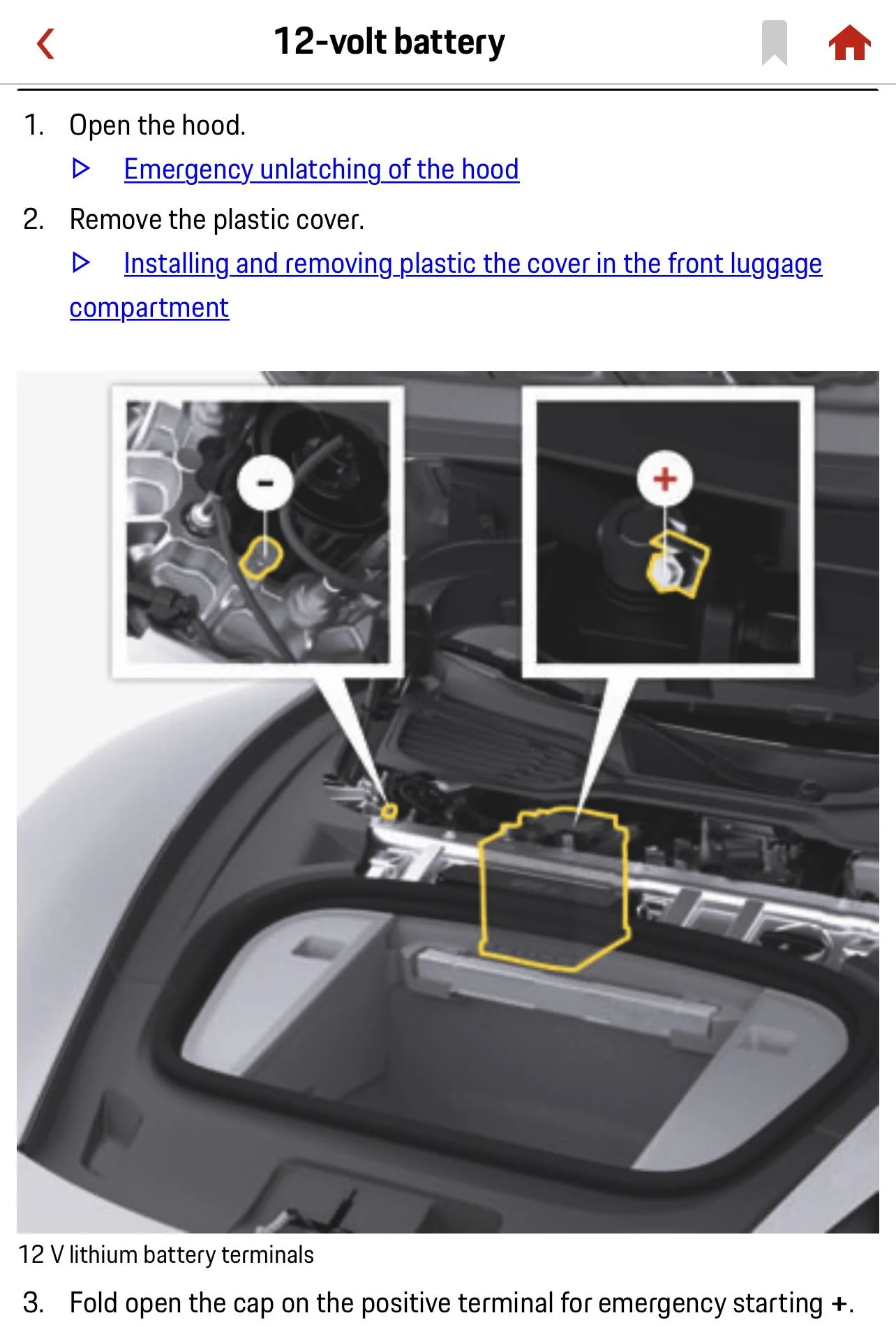

That in turn leads to this diagram:​
Porsche Taycan Where are 12 V battery terminals???? 1666952959981
