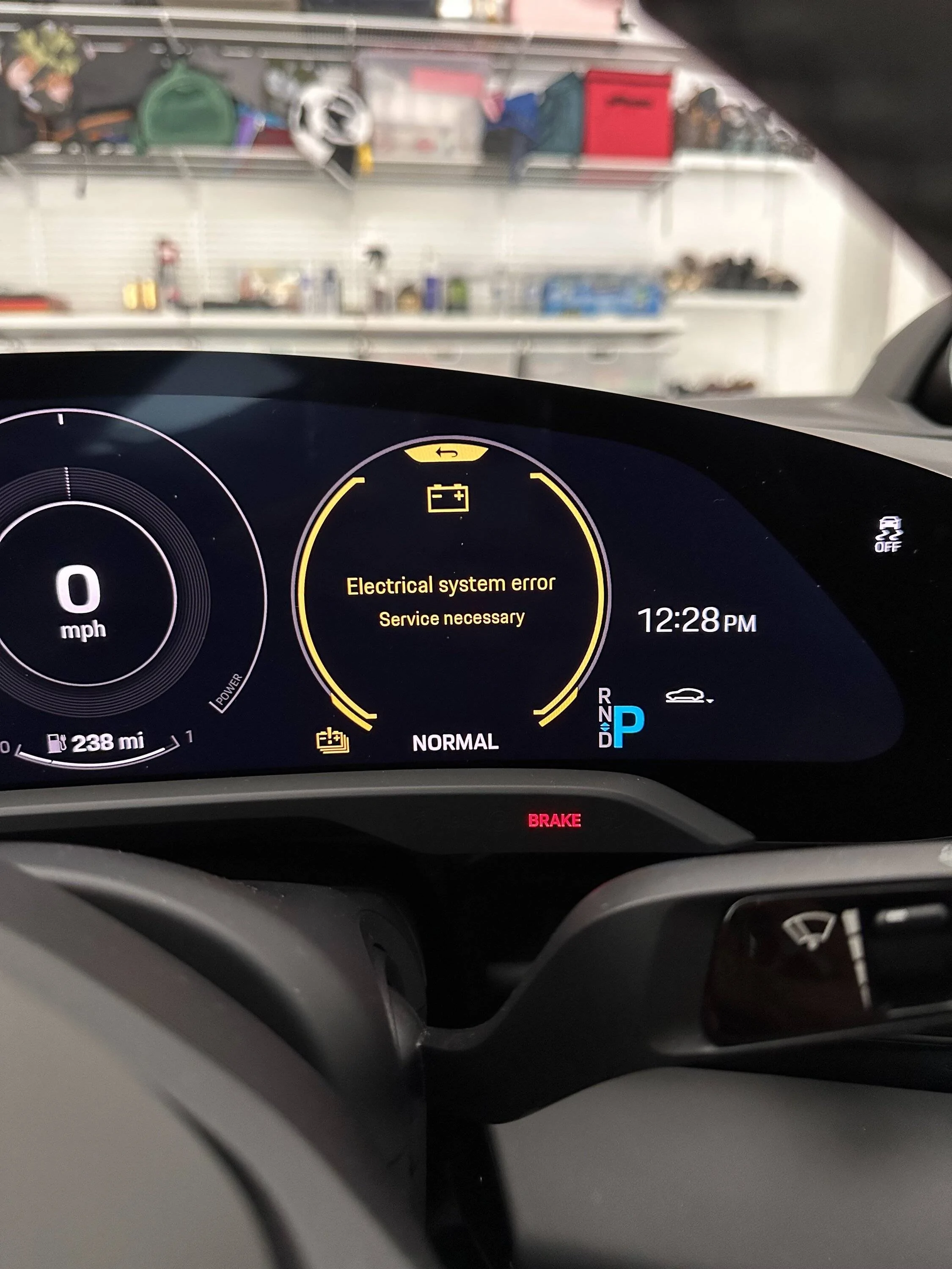

I just experienced the yellow error. All functions worked in the car but I could not engage Forward/Reverse. Neutral and Park worked. Flat bed removal of car and gone 8 days. They said it was "an issue with the voltage converter causing the electrical fault". They ordered it, received in 24 hours and fixed in a day. Warranty repair. Been back and good for a few weeks now...

I’ve been through two 19.2 kW AC On-board HV chargers in two years, last instance with the same symptoms as above (car wouldn’t enter park or reverse) just last month.
I got the error again this morning and thankfully it disappeared while being powered off 15 minutes. But it is no fun living through fear of this happening any given day.
I’m not sure why an onboard charger failing should cause the entire car to become immobile.
