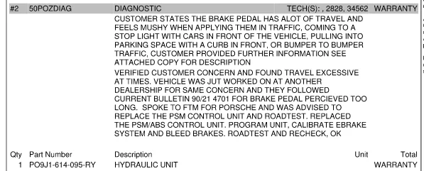

Picking it up tomorrow morning after Porsche service replaced the PSM control unit and loaded latest code per the July 18 2023 TSB posted on page 1.
They also replaced the ABS control unit/brake booster part number PO9J1-614-095-RY
Here is the information I have so far:
Porsche Taycan TSB: Brake Pedal Travel Perceived as “Too Long” Just Before the Vehicle Comes to a Standstill - Mar 23, 2026 updated Screenshot 2023-08-21 161042

Got it back this morning and it feels 1000x better than before. I hope it stays this way now. Pedal travel in all braking conditions is short and firm. Even on the highway using only a small amount of brake travel gets a ton of regen braking both felt (g forces) and shown on the power meter. I hope it stays this way now!
It still feels like a Taycan, meaning there will always be regen braking, blending braking and mechanical braking. It will never feel like a 911 (much lighter and no blending braking) but it feels good and the way you expect it to.
Assuming you don't need a new PSM unit (ie yours accepts the new code that came out as of July 2023) then it could just be a software fix, they did this first and then a new PSM unit was needed since mine wouldn't take the code (was not given a reason why). If that doesn't fix it then a new brake booster/ABS control unit is needed to go with it as well. So your "fix" might not be as long or complicated as mine.
A little scary to think what this would have cost without a warranty but I guess that's the price of being an early adopter.
Biggest takeaway/surprise for me from these 3 weeks without it is how much I dislike the Panamera and as similar as they seem they are SO different. I cannot describe how much sportier and more 911 like the Taycan feels vs the Panamera. The only other time I drove one was a 2015 GTS model (back when it was a V8) on a race track during a Porsche World Roadshow event and I don't recall that one feeling as bad as this brand new '23 Panamera 4 Platinum Edition. It was eye opening to see how different the two Porsche Sedans feel even if they share similar parts and DNA.
Thrilled to be back in my Taycan. Hope others suffering from this brake issue can get resolution. Print out the TSB linked on page 1 and bring it with you and you should have no issue getting it fixed.
