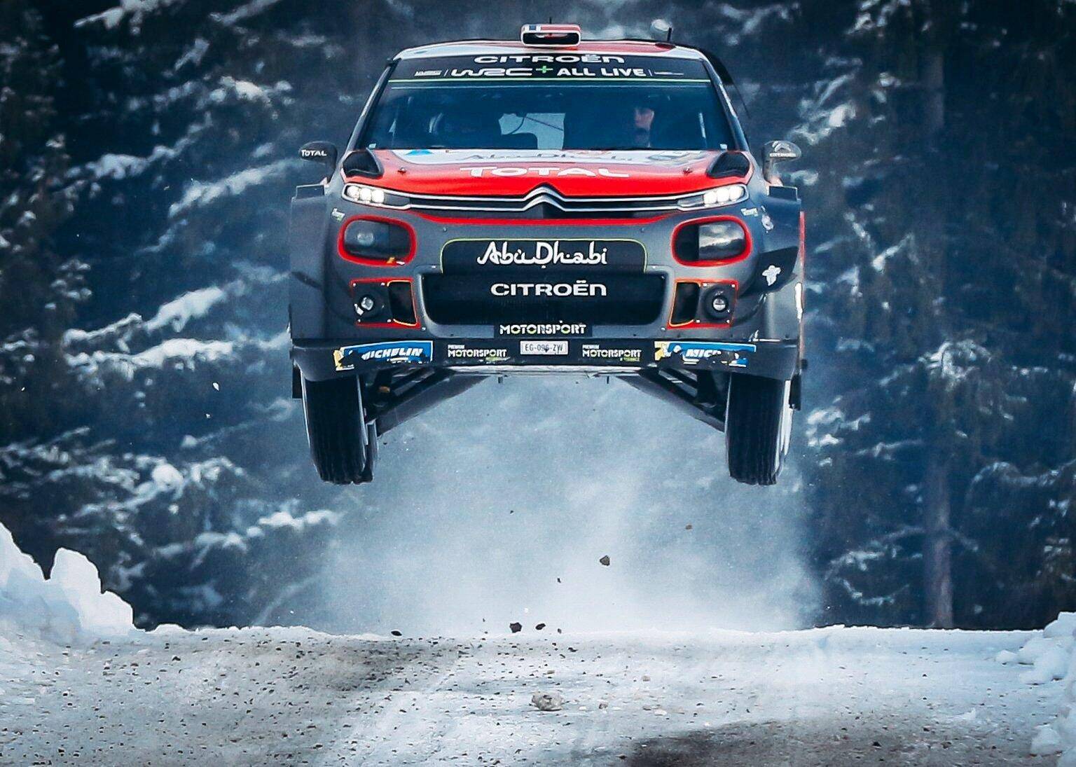

I love it when a new YT video attempts to "settle once and for all" a question that has been answered ~50 years ago. ?‍♂
Exhibit A: WRC wheels/tires throughout the season.

The old rule "narrower = more weight per cm² = better grip" still holds true.. But for studded tires. And keep in mind, in the olden days a winter tire was always studded. Then during the 90s the unstudded winter tires became so good they were a serious alternative.
As for maximum grip on snow and ice we always can count on motorsports to give us the correct answer...
