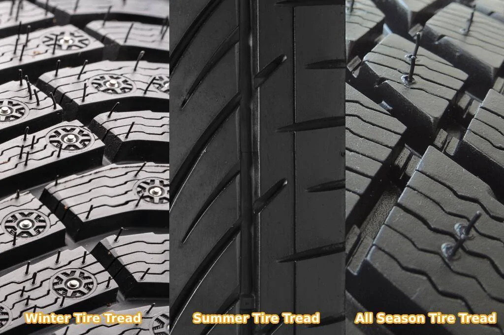

Fair question! I realize I really just made a statement there without any kind of reasoning to why that would be the case. The reason comes down to the tread pattern. The technical term is tire siping, which is really a fancy word for the cuts and patterns in the tire. All other things being equal, (size, materials, etc) a tire with more cuts across the tread design can evacuate more water from underneath itself when it enters a puddle. This is how a tire prevents hydroplaning. Hydroplaning occurs when there is more water under the tire than the tire can handle, causing the tire to float above the water and lose contact with the ground.
Take a look at these sample treads here:
Porsche Taycan Tires: All Season/Winter vs. Summer/Winter 1675622474863
A summer tire has very few cuts across the tread design. This is to maximize rubber to road contact in performance scenarios (like doing a vegas to red rocks canyon run) where the all season tire has a more heavily cut pattern. This results in a more 'squishy' feeling tire but is much better at removing water. You can also see that winter tires take this even further. Not pictured, off road/all terrain tires take this to an even further extreme, leaving big fat gaps between the road contact points of the tire.
Specific to the taycan, let's look at the stock tire options. You can see the siping gets more extreme the more 'wintery' the tire gets.

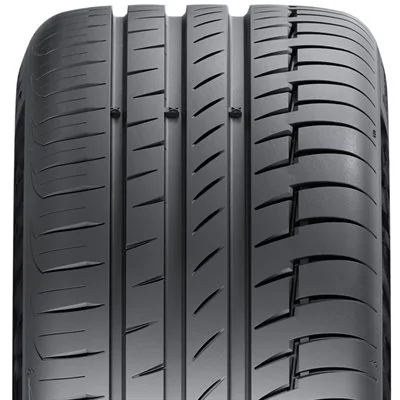

This is the pattern of the continental summer tires (PremiumContact6)
Porsche Taycan Tires: All Season/Winter vs. Summer/Winter 1675622964089

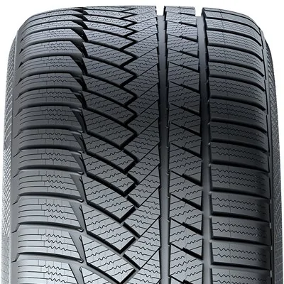

And here are the stock winter tires ( WinterContact TS )
Porsche Taycan Tires: All Season/Winter vs. Summer/Winter 1675623126821
