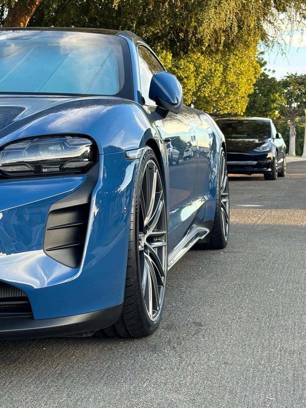

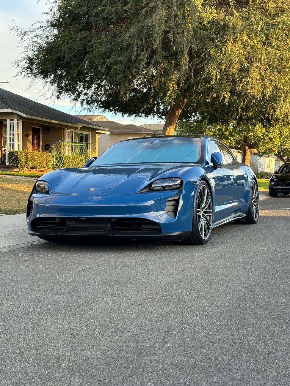

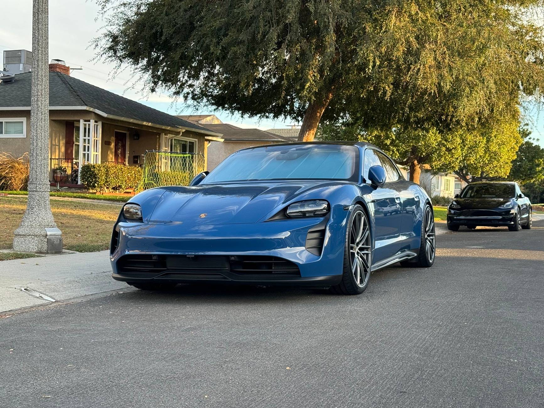

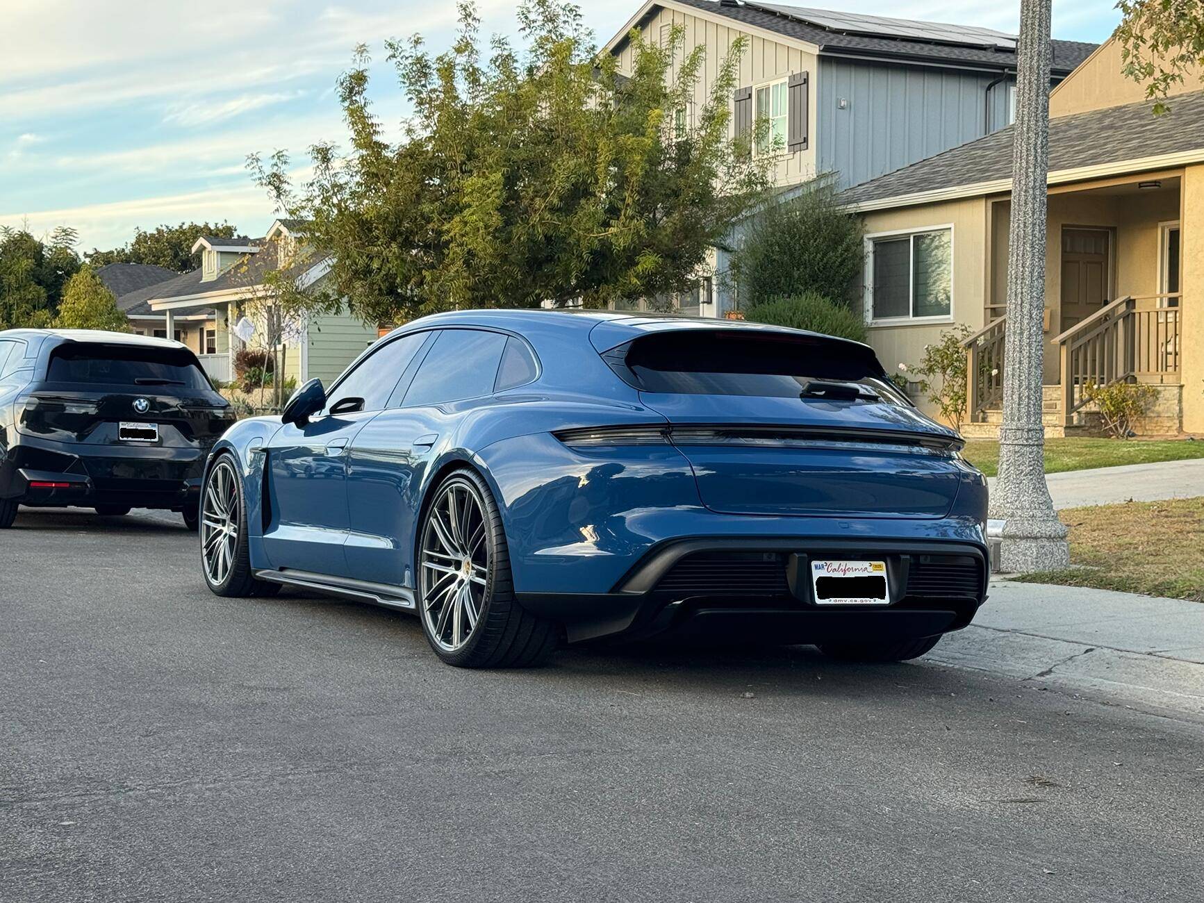

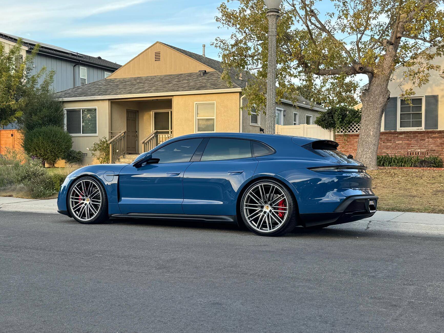

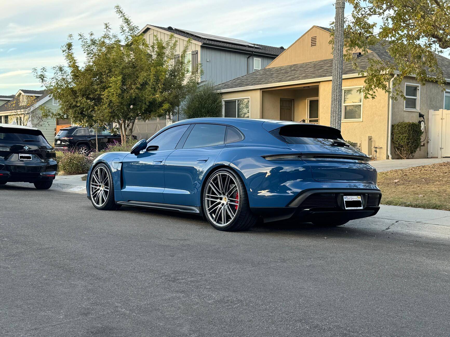

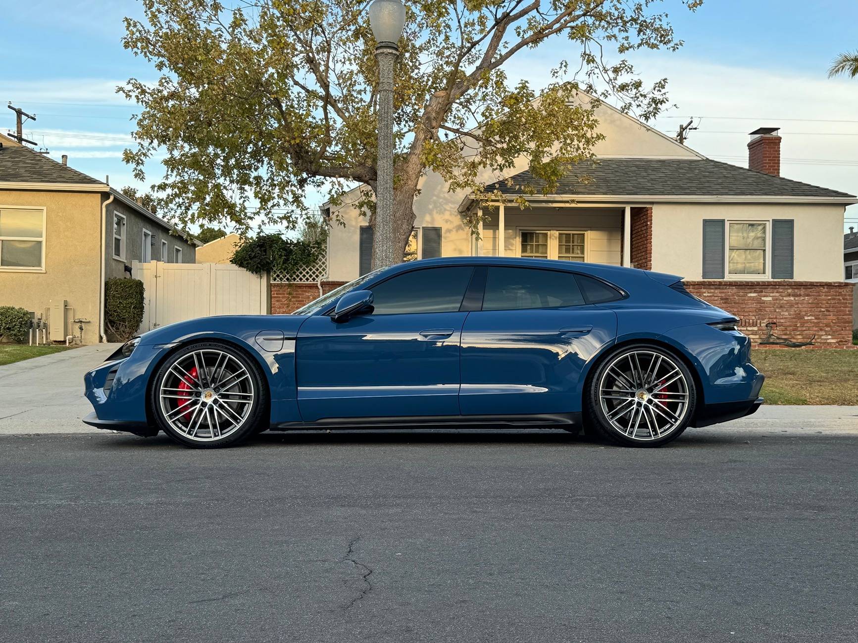

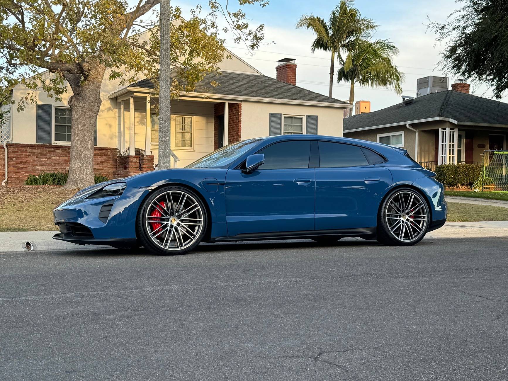

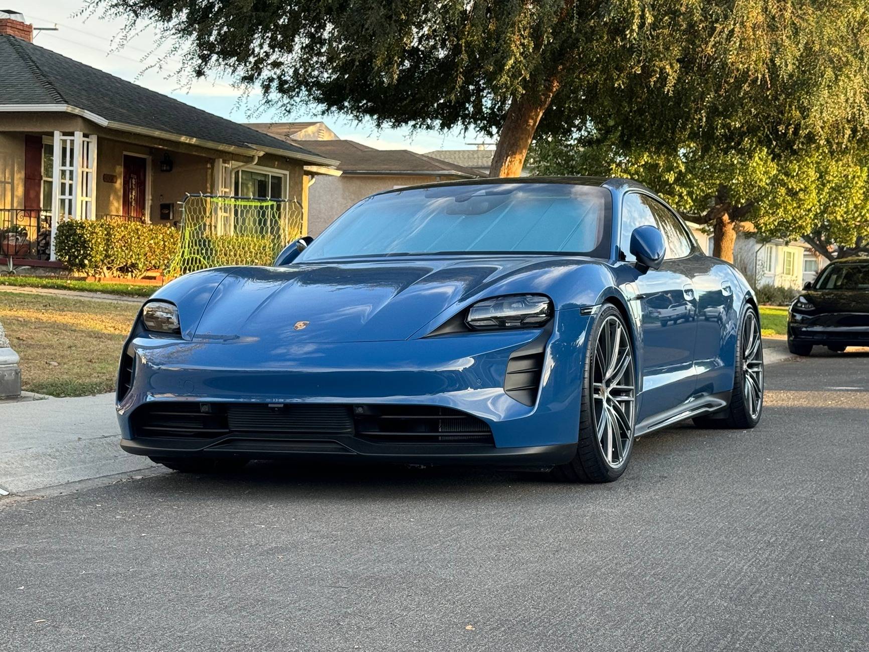

Hey all!
So I got new wheels on the whip - and I loooooove them! Scroll down for photos. Here's the full story.
I never really loved any of the Taycan's factory wheel options. My car came with the 21" RS Spyder Design wheels which are probably the ones I would have chosen if I had been spec'ing my own build. They look pretty good when clean, but once the satin black finish gets a bit dusty, they're pretty dull. It's like they almost disappear entirely. So I had been looking for something else for a little while... Full-on custom forged aftermarket wheels tend to be the opposite - they attract a ton of attention to themselves, and the rest of the car kinda takes a back seat. (plus they're $$$) I like sort of an OEM+ look. The TECHART Formula VI wheels caught my eye, but at close to $12K a set, that's a no-go.
After seeing @bking1306's cross turismo w/ HRE FlowForm wheels that were meant for the Cayenne Coupe looking GREAT, I wondered to myself, "What about factory Cayenne Coupe wheels?" I looked at various 22" wheel styles in the configurator for the current-generation Cayenne Coupe, as well as the previous (9YB) generation. The sizes of nearly all of the Cayenne Coupe 22" wheels are the same: the fronts are 22x10" ET48 and the rears are 22x11.5" ET52. (for the non-coupe Cayennes the fronts are the same, but the rears have a 61mm offset, so they don't poke out quite as much as the Coupe ones) It's a pretty aggressive size/offset - puts the outsides of the wheels/tires pretty flush with the fenders, pretty similar to when I had 15mm spacers all around on the 21" RS Spyder wheels. ...but with 22" wheels and 285/30/R22 front tires and 335/25/R22 rear tires (the seemingly go-to tire sizes for 22" wheels on the Taycan) the tires are more "square" on the wheels - so much less stretch, and that fills the fender wells nicely. Also since the outer diameter of those tire sizes is actually just a wee bit larger than the stock 21" tire sizes, there's a teeny tiny amount of additional ground clearance below the car and a tiny amount less fender gap without any lowering! Win win!
I did very crude mockups of different Porsche factory 22" Cayenne Coupe wheel designs on images of a Neptune Blue Taycan GTS ST like mine from the configurator, using Cayenne Coupe wheel images grabbed from the current-generation configurator and whatever configurator-generated images I could find of the older wheel designs. I'll post those later in this thread for folks to see. Plenty of good options - maybe one of y'all will try one of the other designs? Ultimately I ended up getting a used-but-great-condition set of the 22" 911 Turbo IV Design wheels from the 9YB Cayenne Coupe on eBay. That was my favorite look based on the mockups, and they were also the cheapest & most readily available. Bulletproof Auto Spa got 'em all polished & protected and Bulletproof Automotive mounted 'em up on the tires (Michelin Pilot Sport 4S) w/ new TPMS sensors from TPMS.com. Bulletproof also did a 4-wheel alignment for good measure.
Full specs:
Wheels:
  • 22" 911 Turbo IV Design wheels from the 9YB Cayenne Coupe (Suncoast Parts link)
  • Front: 10J x 22" ET48 (part number 9Y0.601.025.BR)
  • Rear: 11.5J x 22" ET52 (part number 9Y3.601.025.AJ)
Tires:
  • Michelin Pilot Sport 4S
  • Front: 285/30/R22 (101Y XL)
  • Rear: 335/25/R22 (105Y XL)
Other:
  • TPMS sensors are HUF RDE047V21 433 MHz (link)

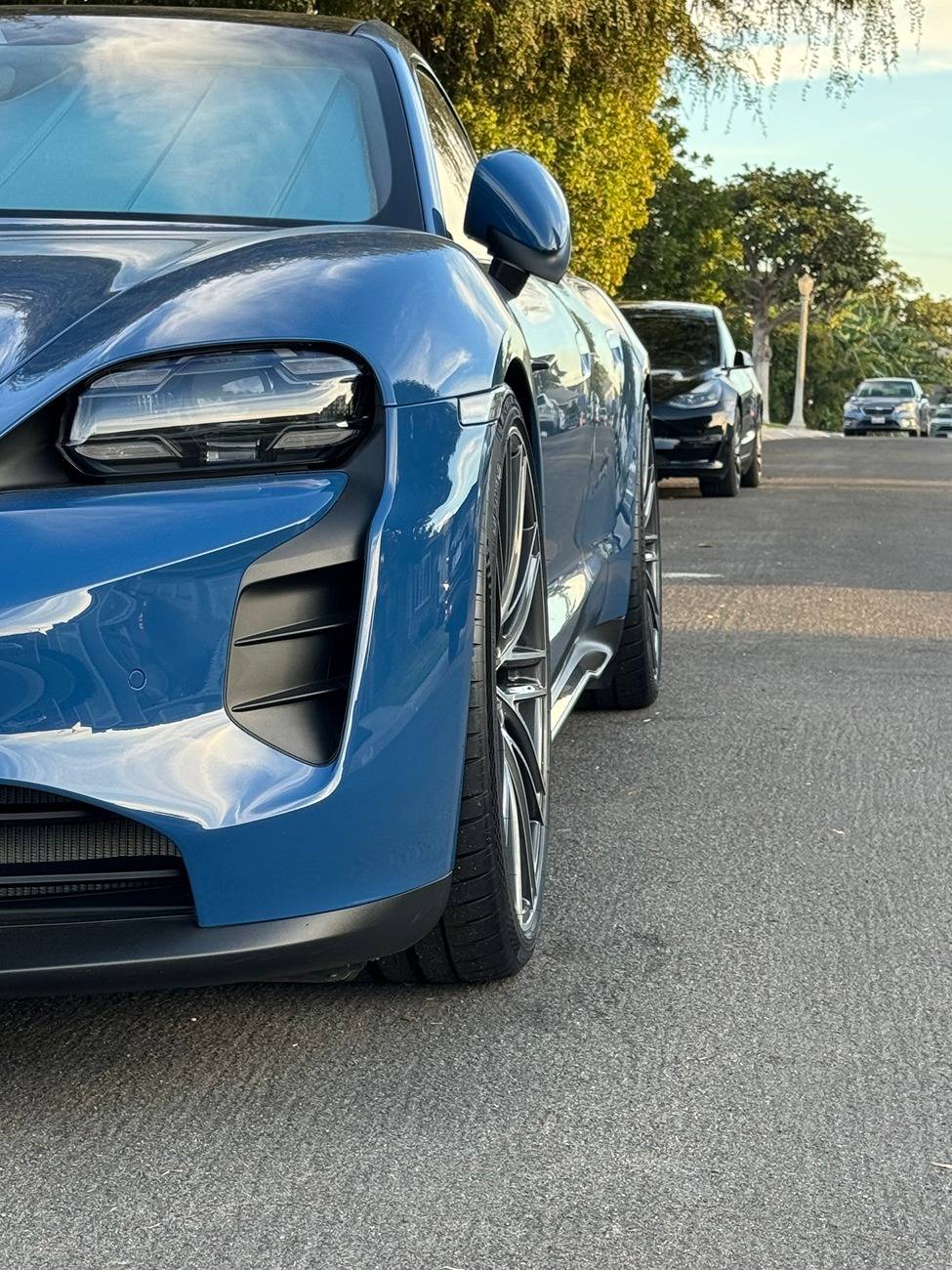

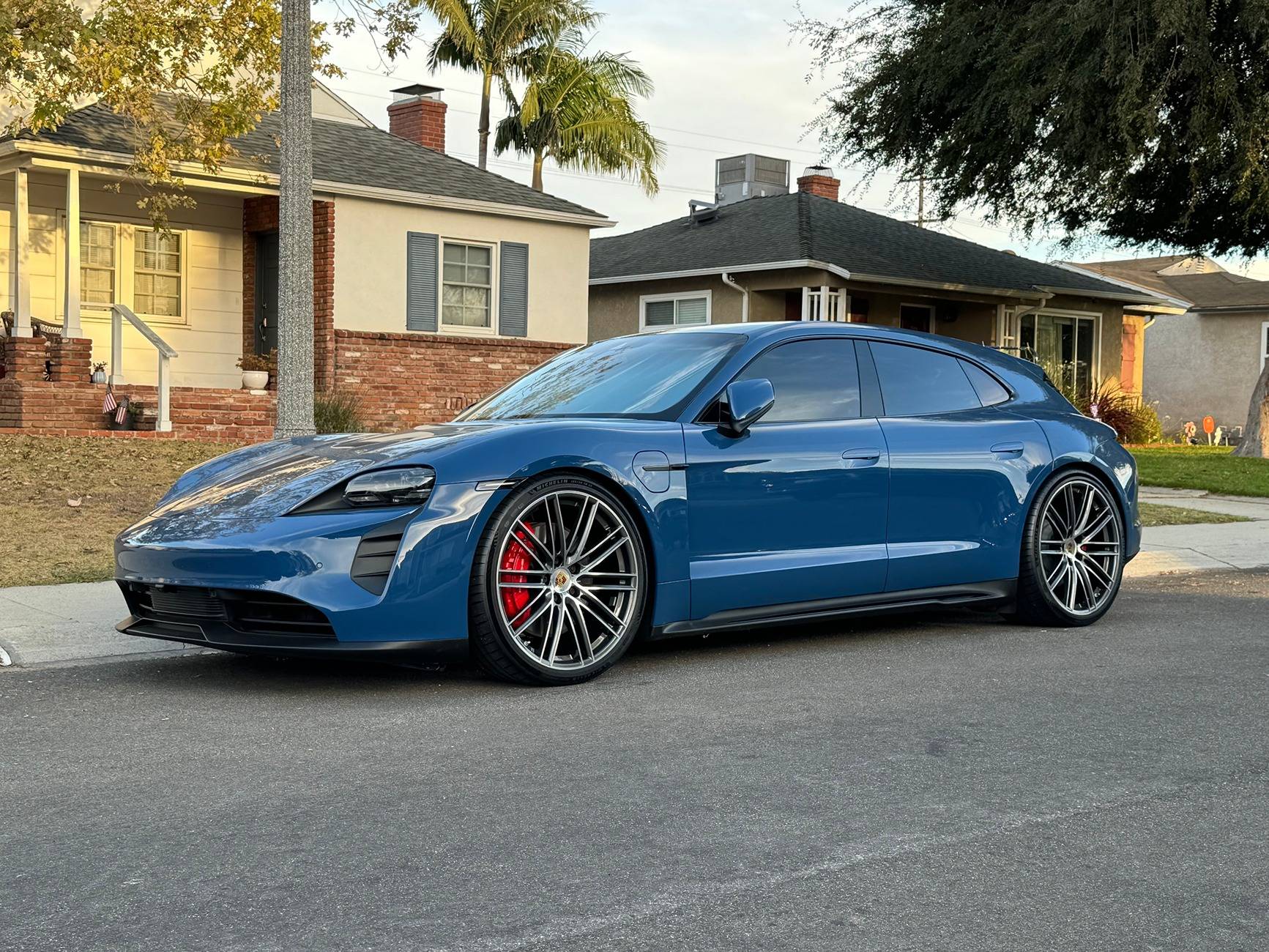

And finally.... THE PHOTOS!!! (note: all of these were taken with the suspention height at "low" - stock air suspension)
Porsche Taycan 2023 Taycan GTS Sport Turismo w/ 22" Turbo Design wheels from 9YB Cayenne Coupe 01 on street 20241026
Porsche Taycan 2023 Taycan GTS Sport Turismo w/ 22" Turbo Design wheels from 9YB Cayenne Coupe 02 on street 20241026
Porsche Taycan 2023 Taycan GTS Sport Turismo w/ 22" Turbo Design wheels from 9YB Cayenne Coupe 03 on street 20241026
Porsche Taycan 2023 Taycan GTS Sport Turismo w/ 22" Turbo Design wheels from 9YB Cayenne Coupe 04 on street 20241026
Porsche Taycan 2023 Taycan GTS Sport Turismo w/ 22" Turbo Design wheels from 9YB Cayenne Coupe 05 on street 20241026
(that ^^^ fitment is perfection!!!)
Porsche Taycan 2023 Taycan GTS Sport Turismo w/ 22" Turbo Design wheels from 9YB Cayenne Coupe 06 on street 20241026
Porsche Taycan 2023 Taycan GTS Sport Turismo w/ 22" Turbo Design wheels from 9YB Cayenne Coupe 07 on street 20241026
Porsche Taycan 2023 Taycan GTS Sport Turismo w/ 22" Turbo Design wheels from 9YB Cayenne Coupe 08 on street 20241026
Porsche Taycan 2023 Taycan GTS Sport Turismo w/ 22" Turbo Design wheels from 9YB Cayenne Coupe 09 on street 20241026
Porsche Taycan 2023 Taycan GTS Sport Turismo w/ 22" Turbo Design wheels from 9YB Cayenne Coupe 10 on street 20241026
Porsche Taycan 2023 Taycan GTS Sport Turismo w/ 22" Turbo Design wheels from 9YB Cayenne Coupe 11 on street 20241026
I'll take some more/better photos (without the sunshade in the windshield and mirros folded up doh!) next time I can/when the car is clean. Just wanted to share some ASAP!
Oh, I haven't driven it a whole lot with this setup, but I haven't heard or felt any rubbing yet - and I did some full-lock turning in "low" mode. (and my car does have the rear-wheel steering) @bking1306 didn't have rubbing problems with the Cayenne-fitment 22" HRE FF10 wheels, and those are pushed out 3mm more in front and 1mm more in rear than these, so I'm not too worried about rubbing problems.
Thanks for reading/viewing! More photos to come...

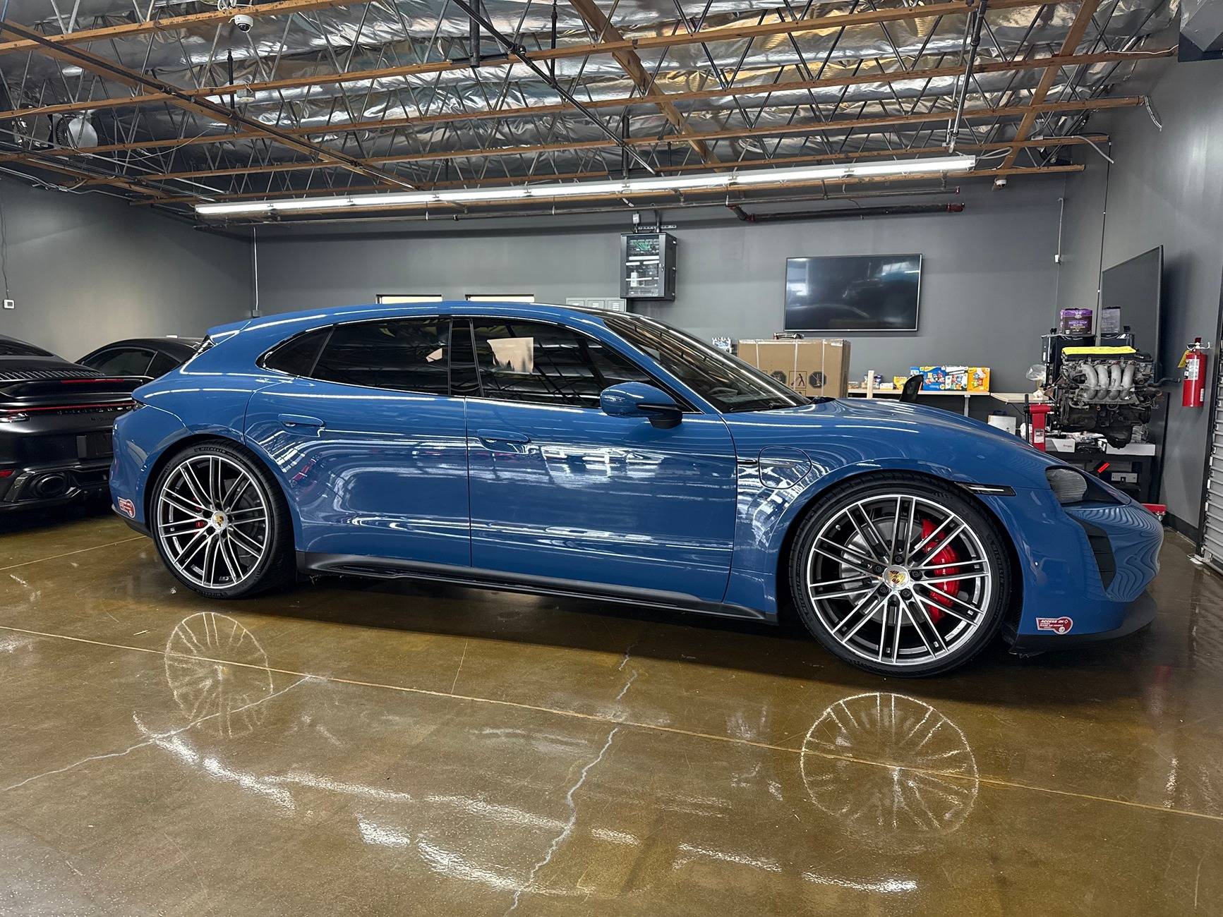

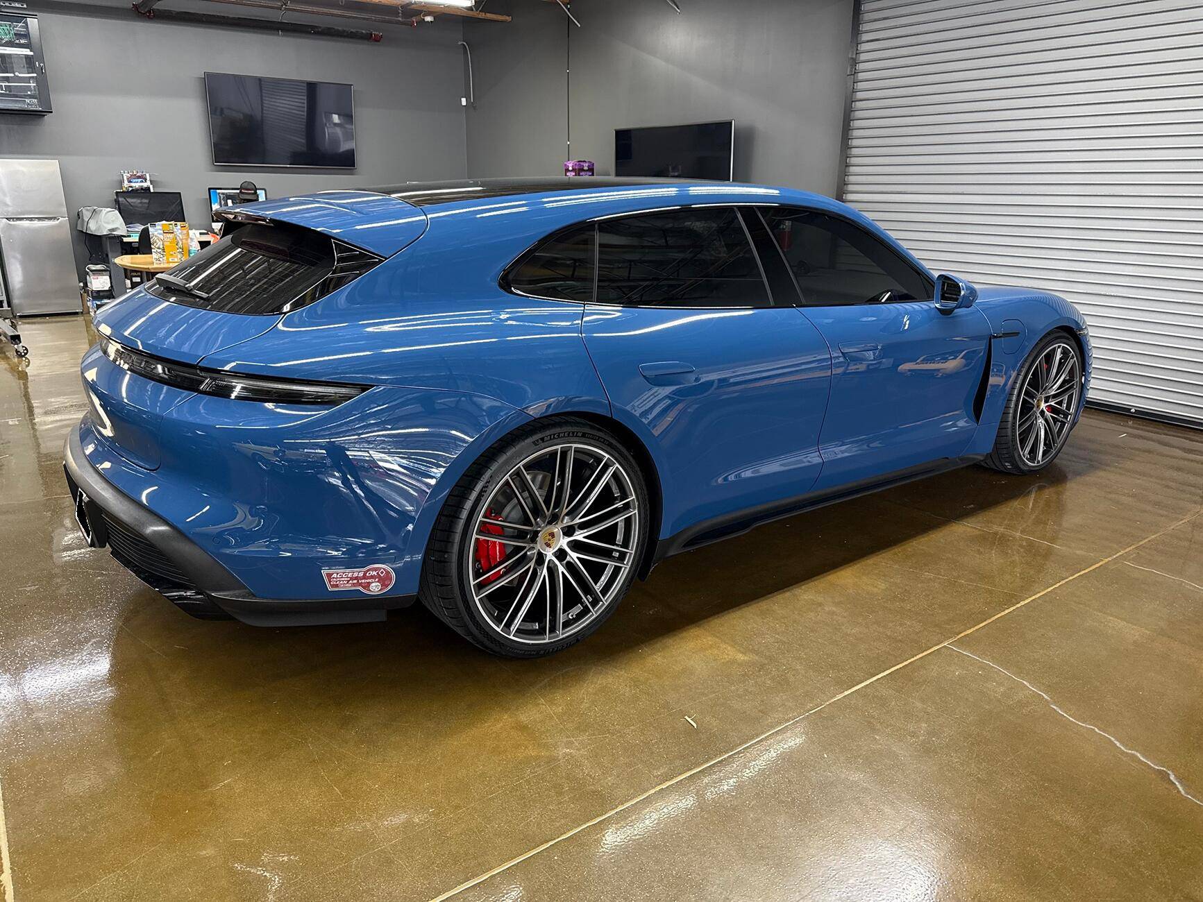

Few bonus photos:
Inside Bulletproof Auto Spa before I picked it up:
Porsche Taycan 2023 Taycan GTS Sport Turismo w/ 22" Turbo Design wheels from 9YB Cayenne Coupe 01_inside_BPAS_side01_20241025
Porsche Taycan 2023 Taycan GTS Sport Turismo w/ 22" Turbo Design wheels from 9YB Cayenne Coupe 02_inside_BPAS_side02_20241025

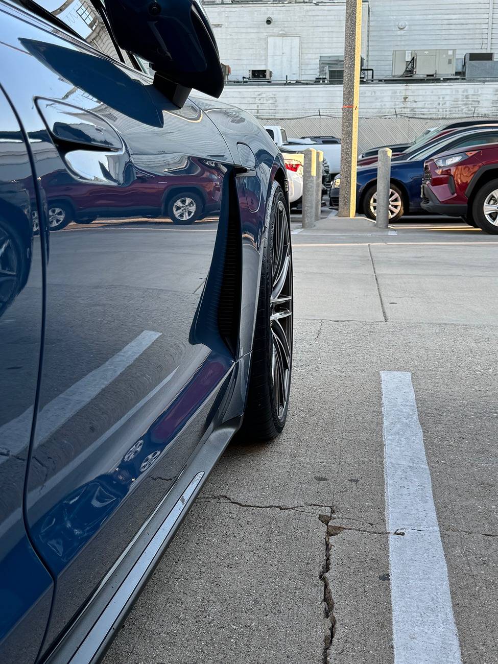

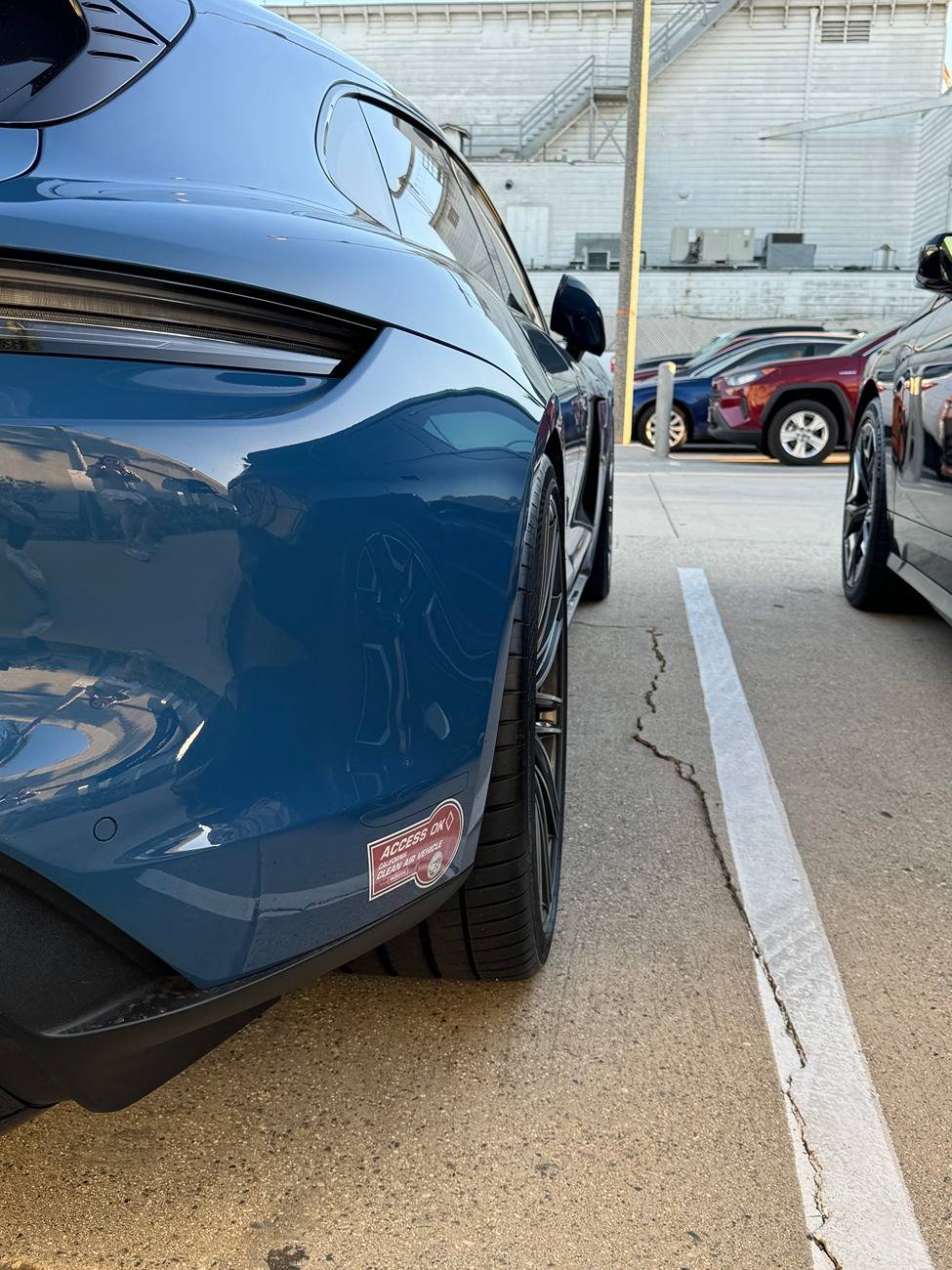

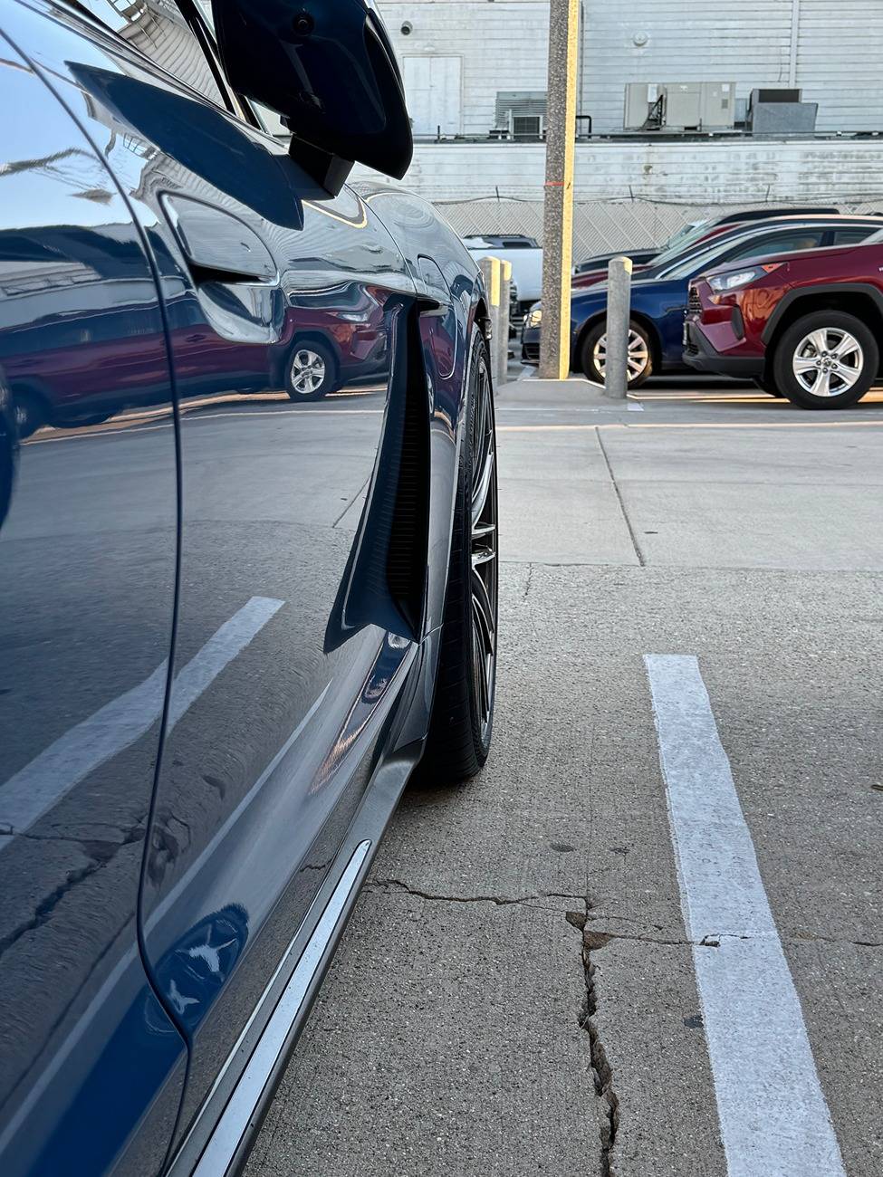

Parked outside Bulletproof Auto Spa when I got there and first saw it - snapped some shots of the fitment/flushness:
Porsche Taycan 2023 Taycan GTS Sport Turismo w/ 22" Turbo Design wheels from 9YB Cayenne Coupe 01_outside_BPAS_20241025
Porsche Taycan 2023 Taycan GTS Sport Turismo w/ 22" Turbo Design wheels from 9YB Cayenne Coupe 02_outside_BPAS_20241025
Porsche Taycan 2023 Taycan GTS Sport Turismo w/ 22" Turbo Design wheels from 9YB Cayenne Coupe 03_outside_BPAS_20241025

Nice! They definitely fit the car well. I agree on the Taycan rim options being quite poor. The ones on my car are probably my favorite from the bunch.

To each their own but in my opinion they look out of place on the car. Way too many spokes clutter the visual of a car that already has a lot of nice curves. Wheels grab all the attention which I personally don't like. Maybe if they were a darker tone it would have been better but again, what's important is the owner to look back when they park the car :)

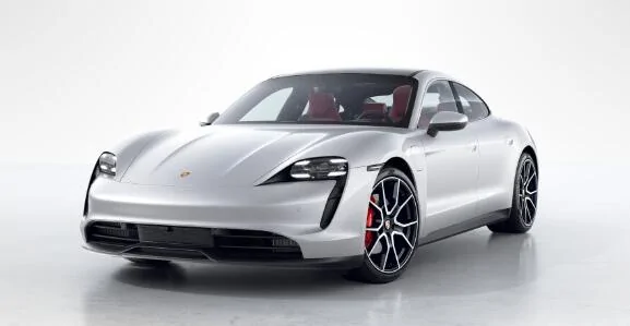

I think the GTS range takes quite a hit when going from the stock 20" GTS aero wheels (pictured here) to the 21" RS Spyder wheels, mostly due to the open design of the RS Spyder wheels not being great for aerodynamics. I figured the "more spokey" design of these wheels might be a little better on aerodynamics, but the stickier and wider rubber would be a little worse on rolling resistance & aero, so in the end it might be a wash. Seems like that's just about the case. I'll continue to monitor and report back... But even if it ends up resulting in a slight decrease in range, having the increased grip from the PS4S tires is worth it in my book (shorter stopping distance etc.).

Them wheels look awesome!
I would love to have that look, if there wouldn't be that many disadvantages.
Now you need PCCB's instead of those "toys" behind the spokes.
