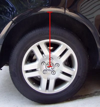

Calibration is done using this measurement:
Porsche Taycan Brabus SportXtra Suspension Lowering Module for Taycan? 1768931591188-hu
It's not done per-level in PIWIS, just for the base level. If you lie on each corner by a fixed amount of mm, then it will be lower or higher in all settings by the amount of mm you lied when doing the calibration.
If the aftermarket modules lie the amount of mm based on mode selected, then they will have more adjustability, but I still wouldn't pay 2k for it.
Lowering links are in that way even more pointless, since you can do the entire thing with software.
