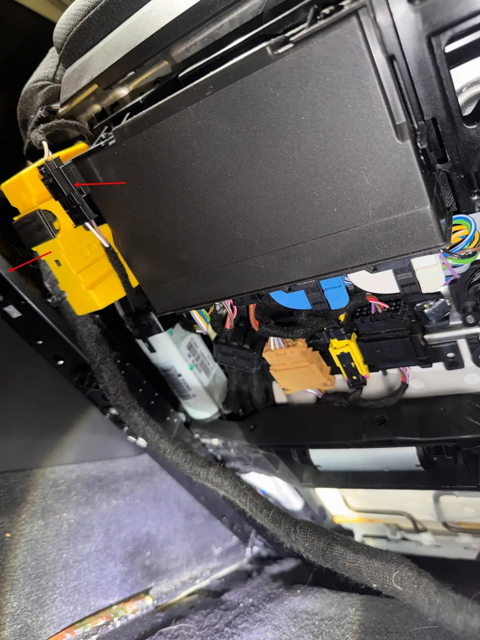

  • Pull the black plastic part located on the yellow connector, remove the small connector, and pull the big one. See arrows below

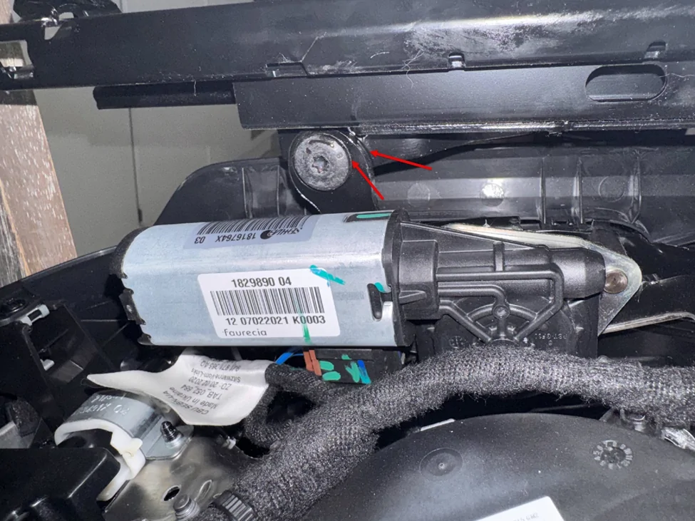

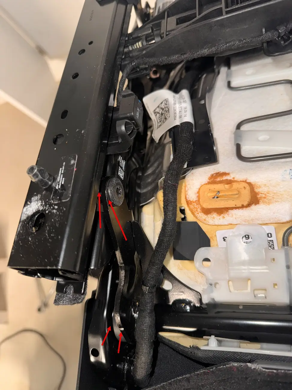

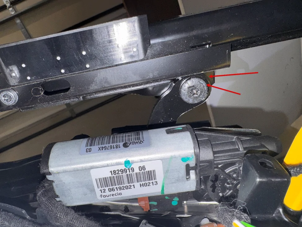

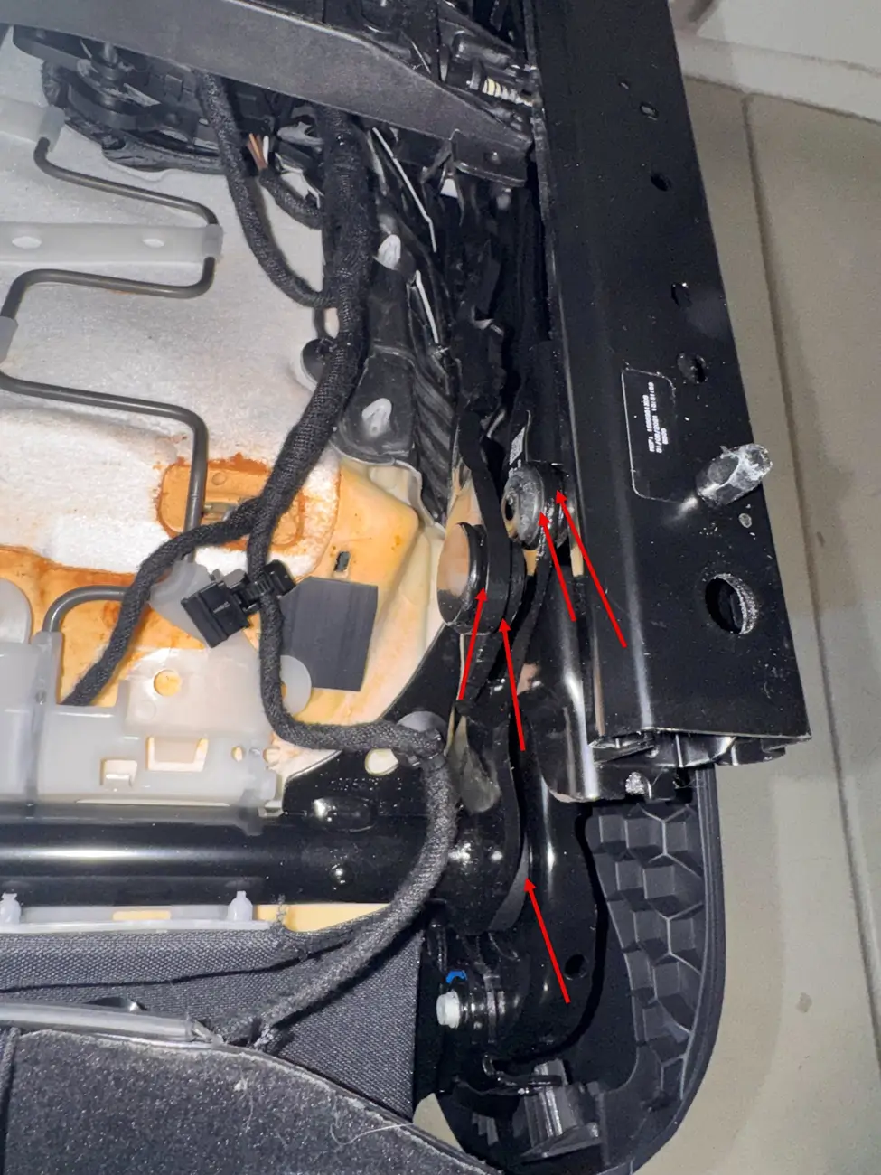

Put the seat upside down on a chair so that you can access the underside of it. The squeaking is coming from the pivots to raise the seat, and they need a bit of oil. I used 3-in-1 oil. I believe grease may be better, but I did not want to do it before making sure the oil was going to fix it.
Apply one drop of oil on each pivot.

The noise is now gone, and it has been 2 weeks.
