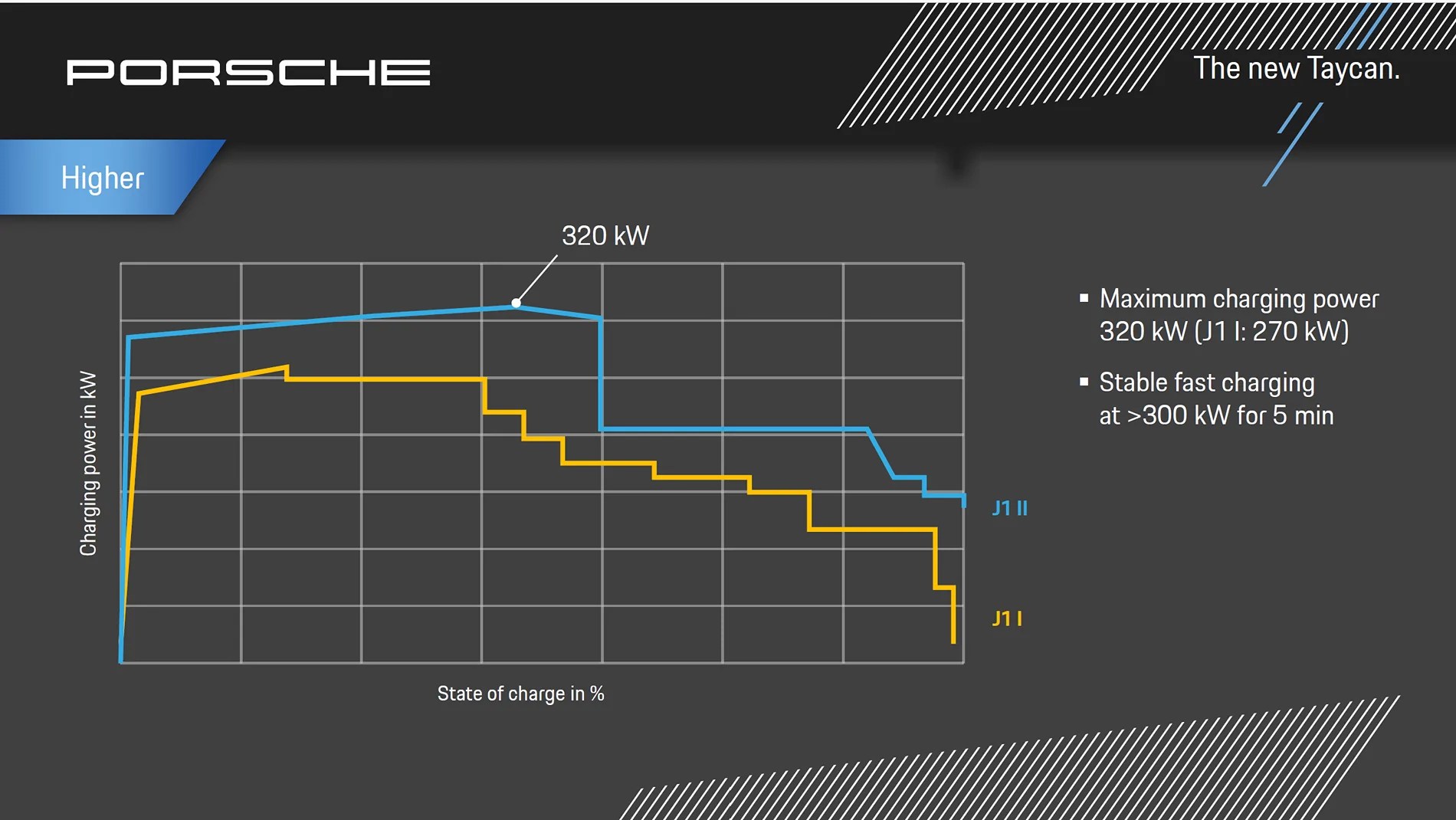

Charging curve differences (logical view)
Porsche Taycan Technical Deep Dive: Taycan J1.2 charging based on my new 2026 Taycan... 1774190535310-6v

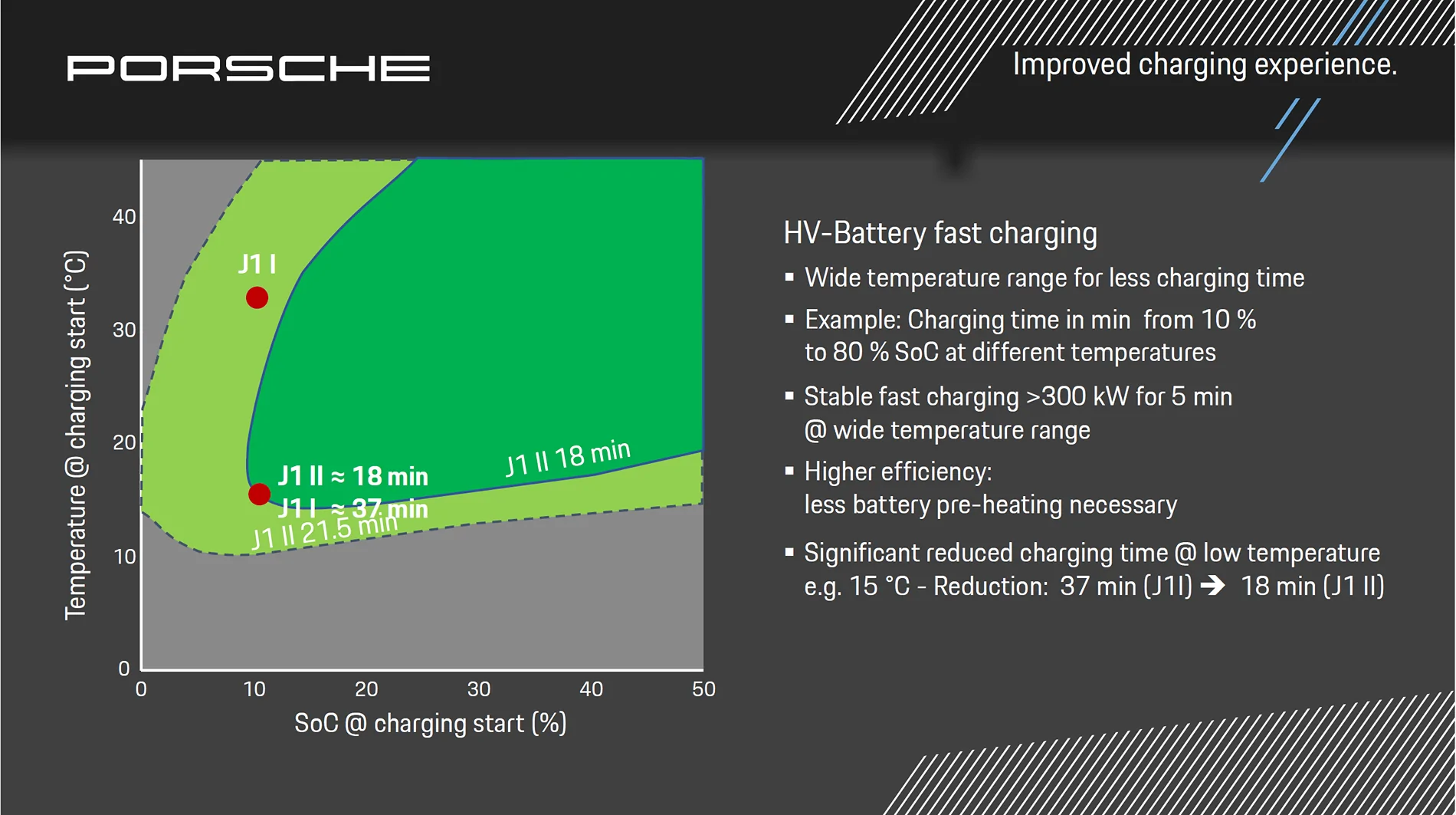

This is the graph that shows how J1.2 is superior in charging at low ambient temperatures:
Porsche Taycan Technical Deep Dive: Taycan J1.2 charging based on my new 2026 Taycan... 1774190891498-ai

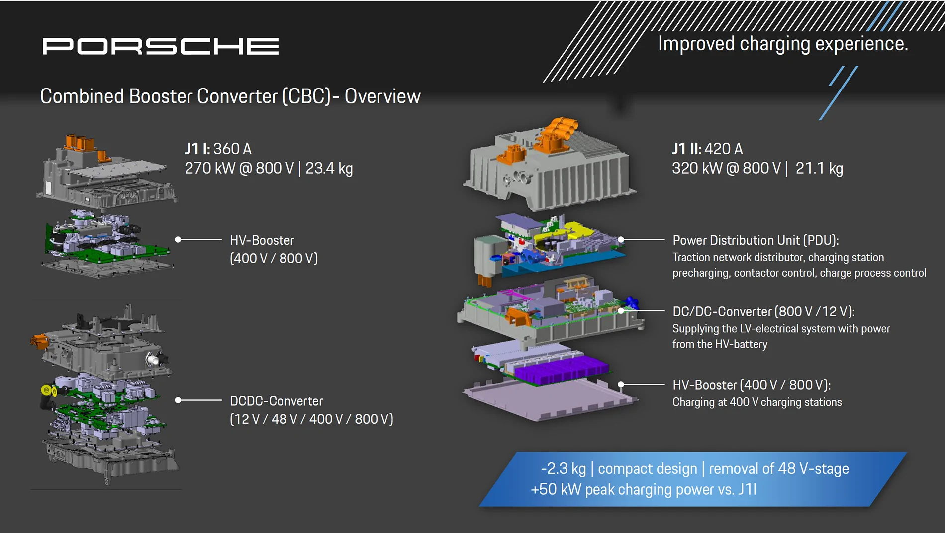

This one shows the differences in the CBC, as 48V bus no longer needed (used for PDCC), but as we know the 11kW AC OBC is a different component. Macan EV appears to have the 22kW AC OBC as an option requiring a 3-phase power setup now in the EU but not in the US.
Porsche Taycan Technical Deep Dive: Taycan J1.2 charging based on my new 2026 Taycan... 1774190984672-e5

J1.2 has a massive improvement in cold weather. It warms up the battery way quicker due to the massively increased heating power and allows for faster charging rates at colder temperatures of the battery as well.
All in all the difference is dramatic slashing cold charging times by up to 50% for me in winter, and allowing you to be a lot more lax about when you navigate to a charger to pre-condition the battery.
