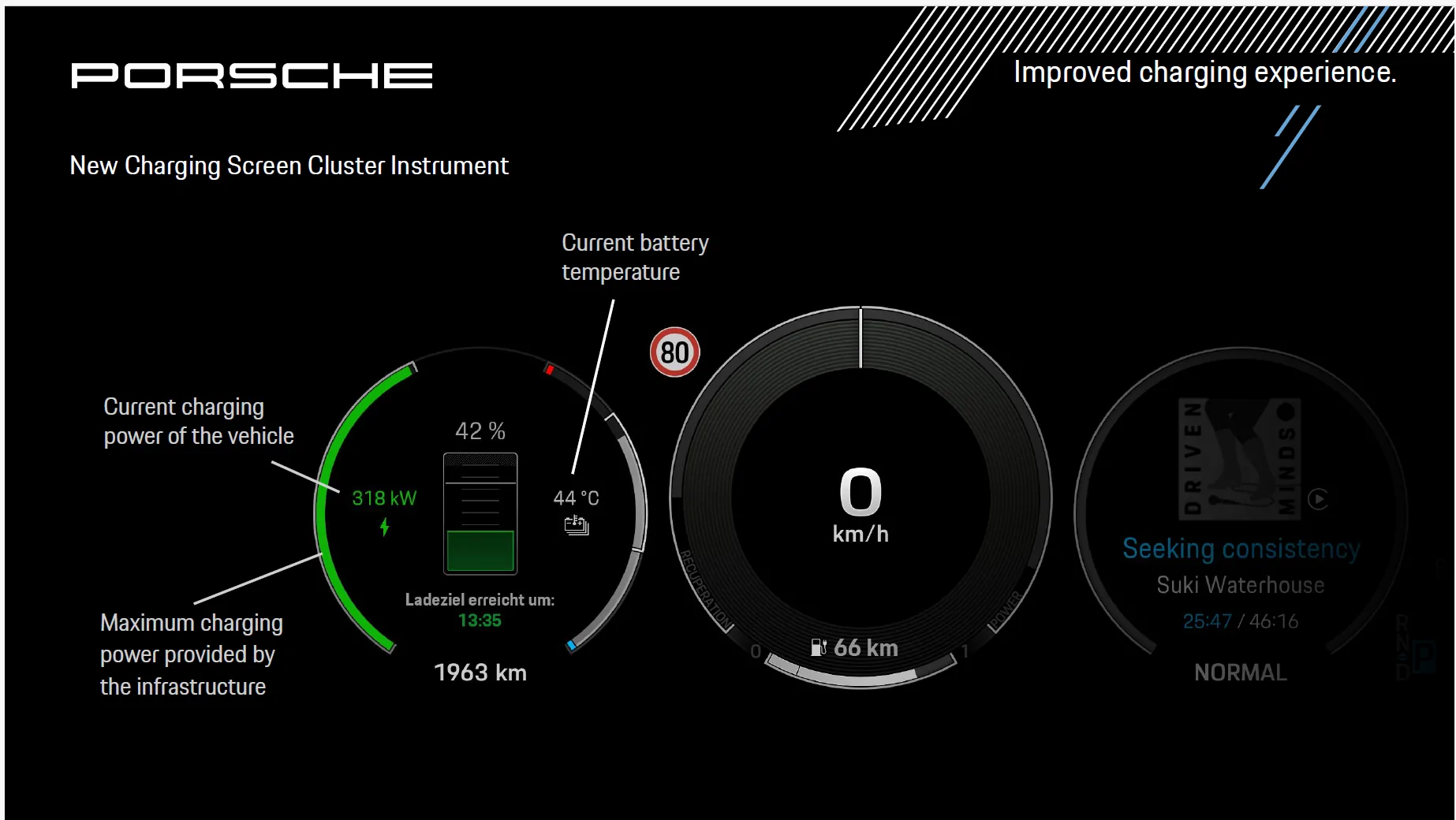

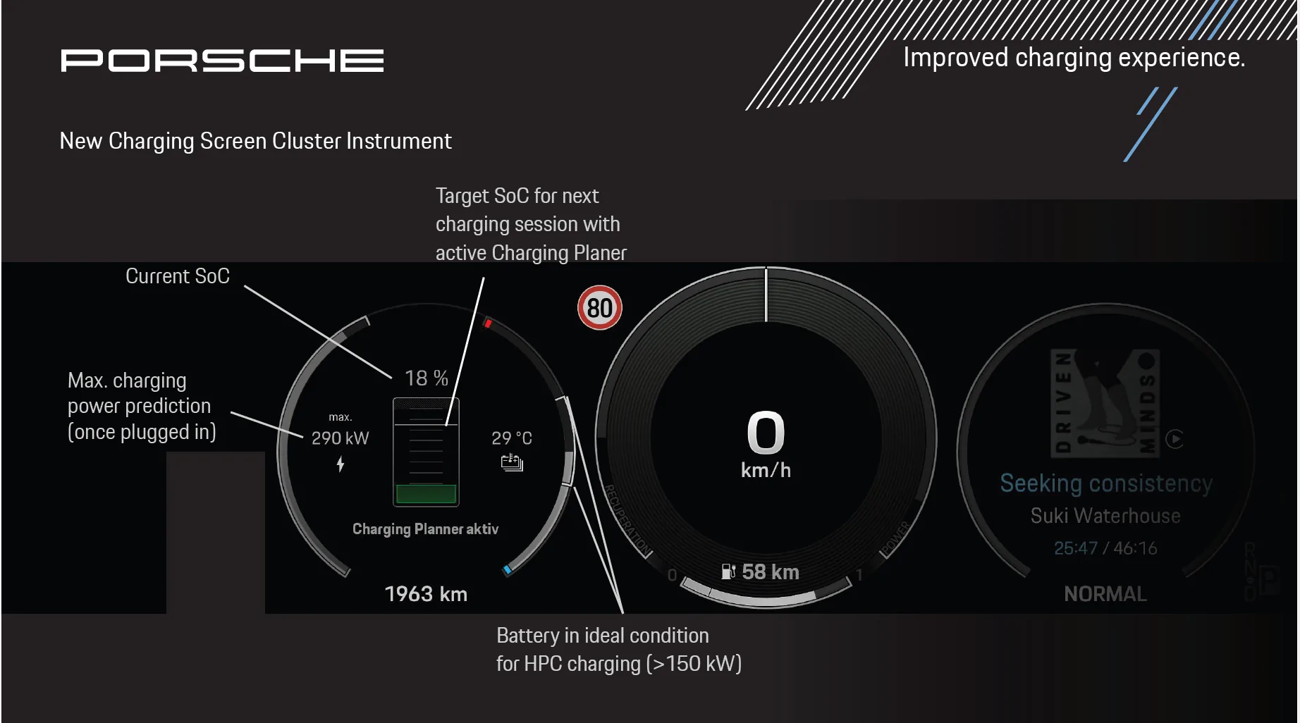

Also, it has an indicator telling you if the battery is at optimal temp to receive max charge, it is on your left tube battery screen at 3 o'clock and what that max is at 9 o'clock. The J1.2 got your back.

Your J1.2 will issue blame the charger message if it is not giving the car the max it can accept.

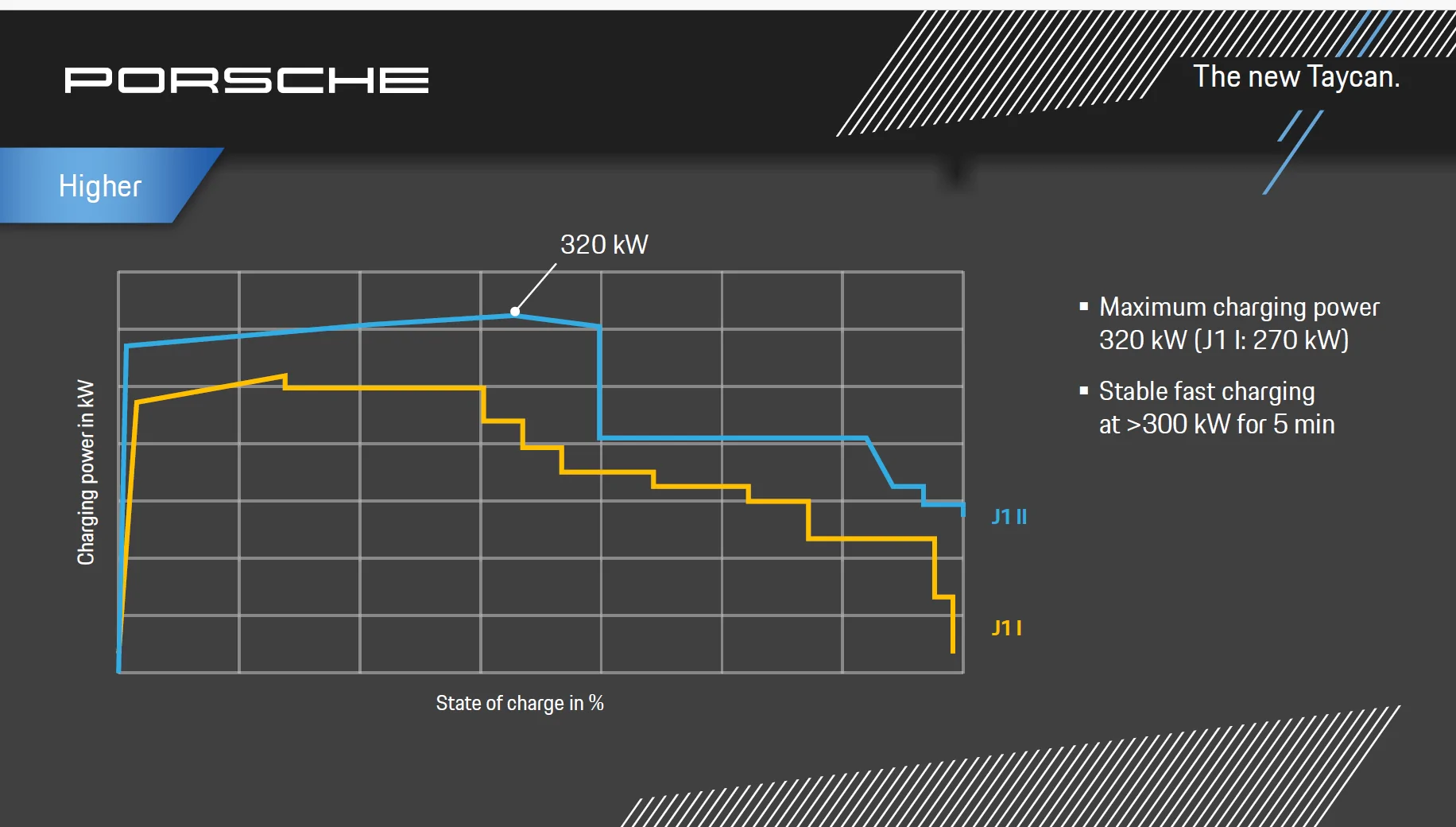

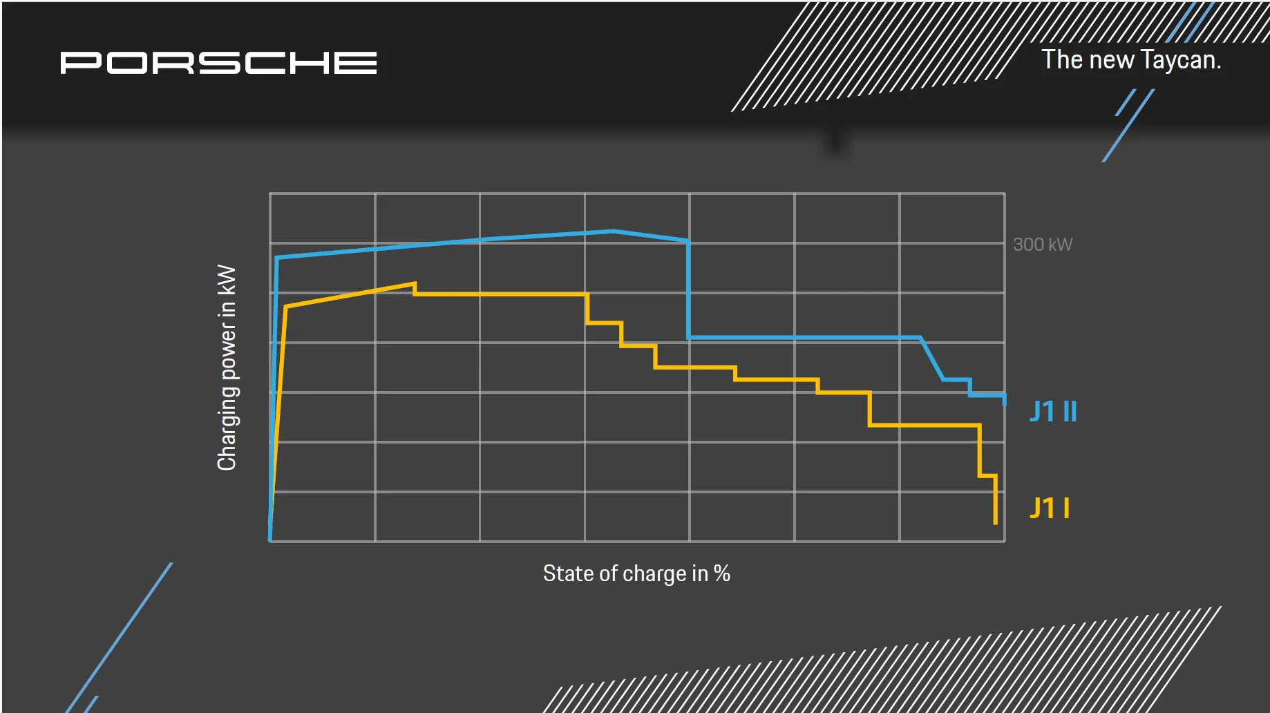

I would guess that the charger itself may be programmed to taper off. However, the car should be able to take a much higher rate, per mothership data graph below. They do not make it really well labeled but there is a 300kW on Y axis and you can assume X axis is from 0% to 100%. Then if you follow J1 II curve it can be as high as 200kW. I would like to see a real-world example if it is any way close to this.

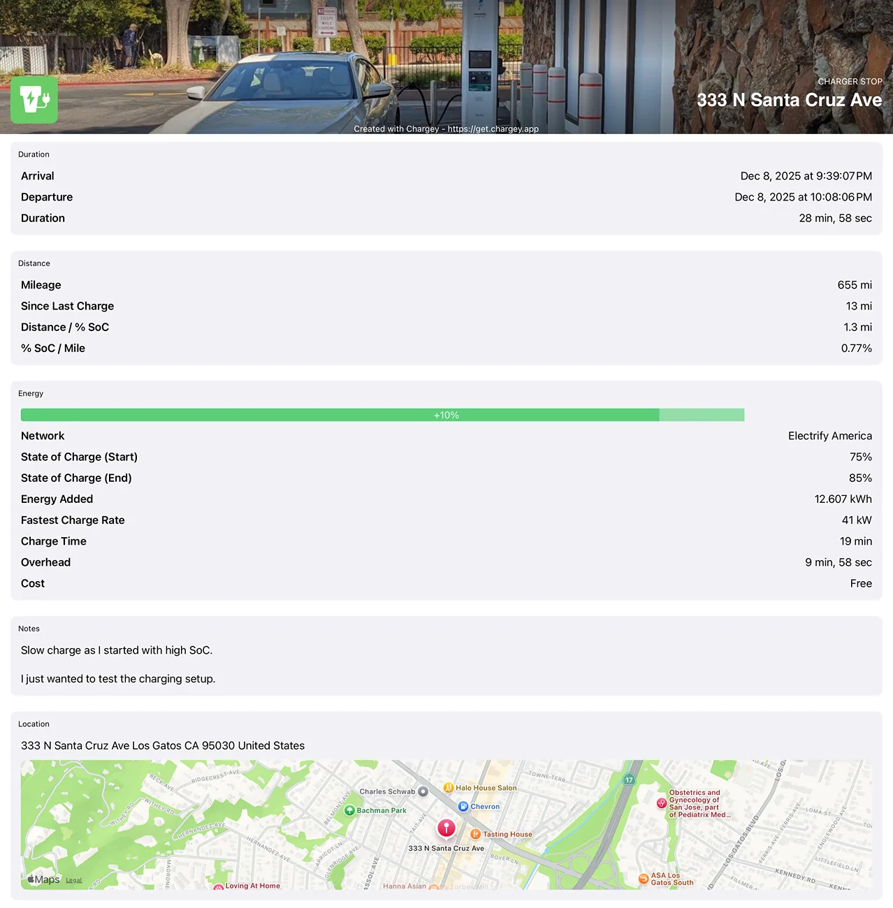

I did a charge from 75% recently and only got 45kW. My purpose wasn’t speed charging but to confirm plug-and-charge after a minor Porsche ID mixup.
Where is that report you posted from?

As you are in a J1.2, the nice new battery screen will show you the maximum power that the vehicle can accept given its state of charge and temperature. This is very helpful in determining whether it is your vehicle or the charge provider that is throttling.

If you come by the SFO airport try the BP Pulse station, these work well and fast if the car is fully preconditioned, which is very easy to see on the charging gauge on the dash in the J1.2
