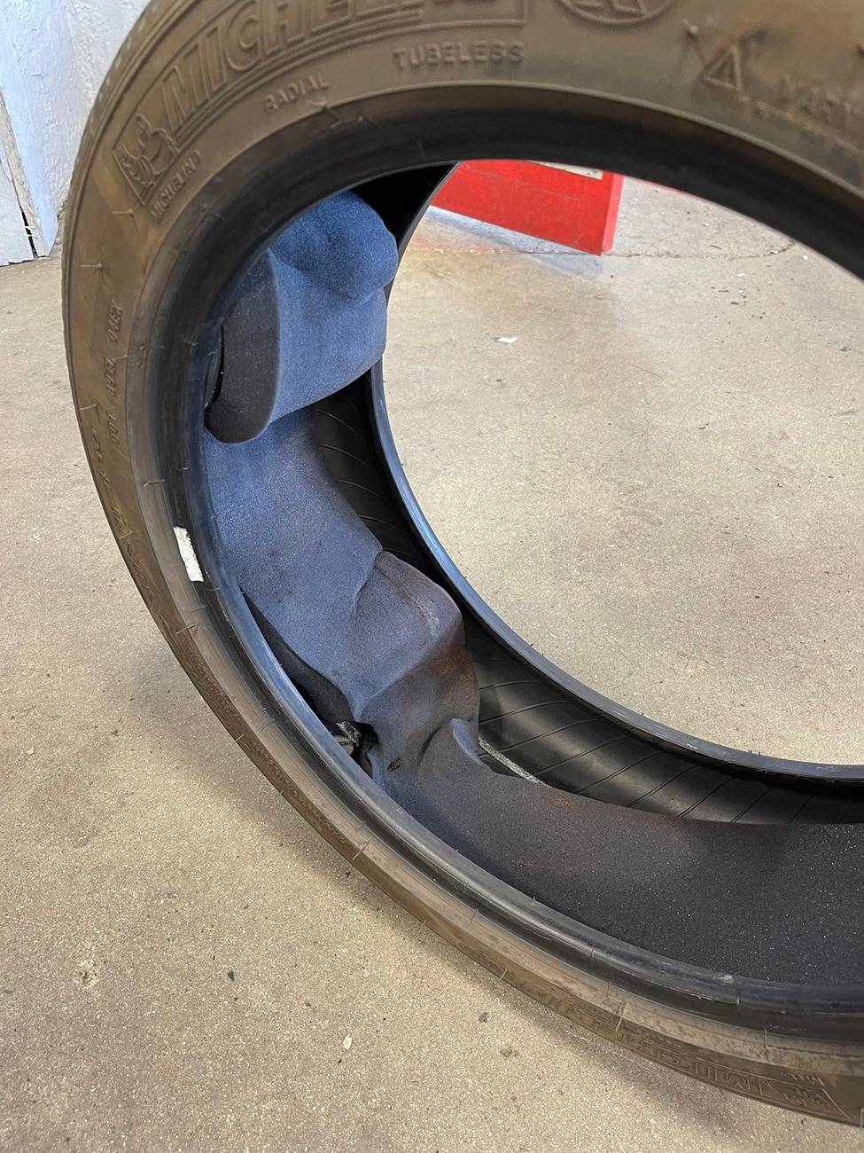

Went out today to try to recreate the thumping experience, however, no joy. After some research the Tesla forum detailed many Tesla drivers having similar issues with the foam liner coming unglued and bunched up causing an unbalanced condition. Updates to follow.
Porsche Taycan 70 MPH Thumping sound undefined - Imgur
