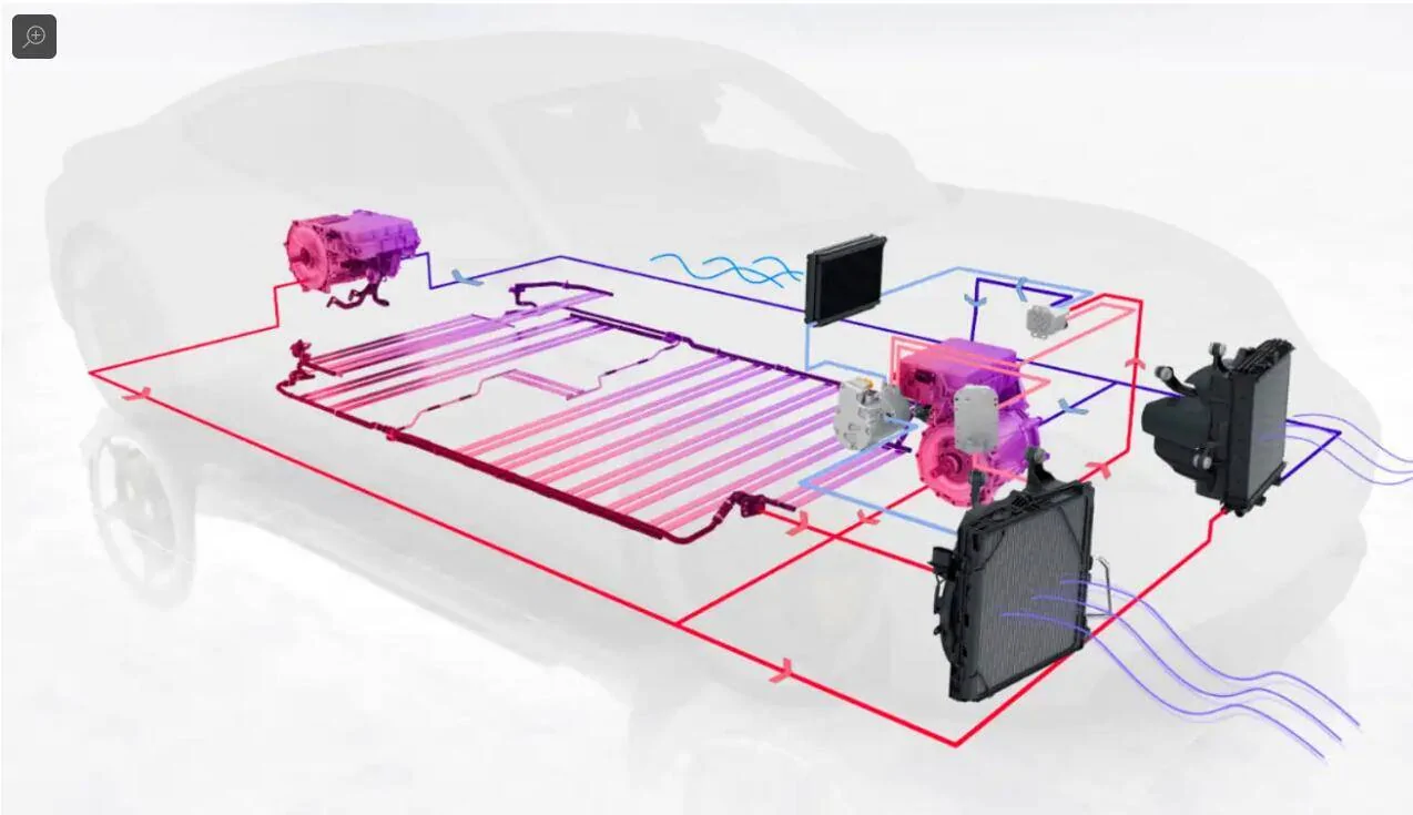

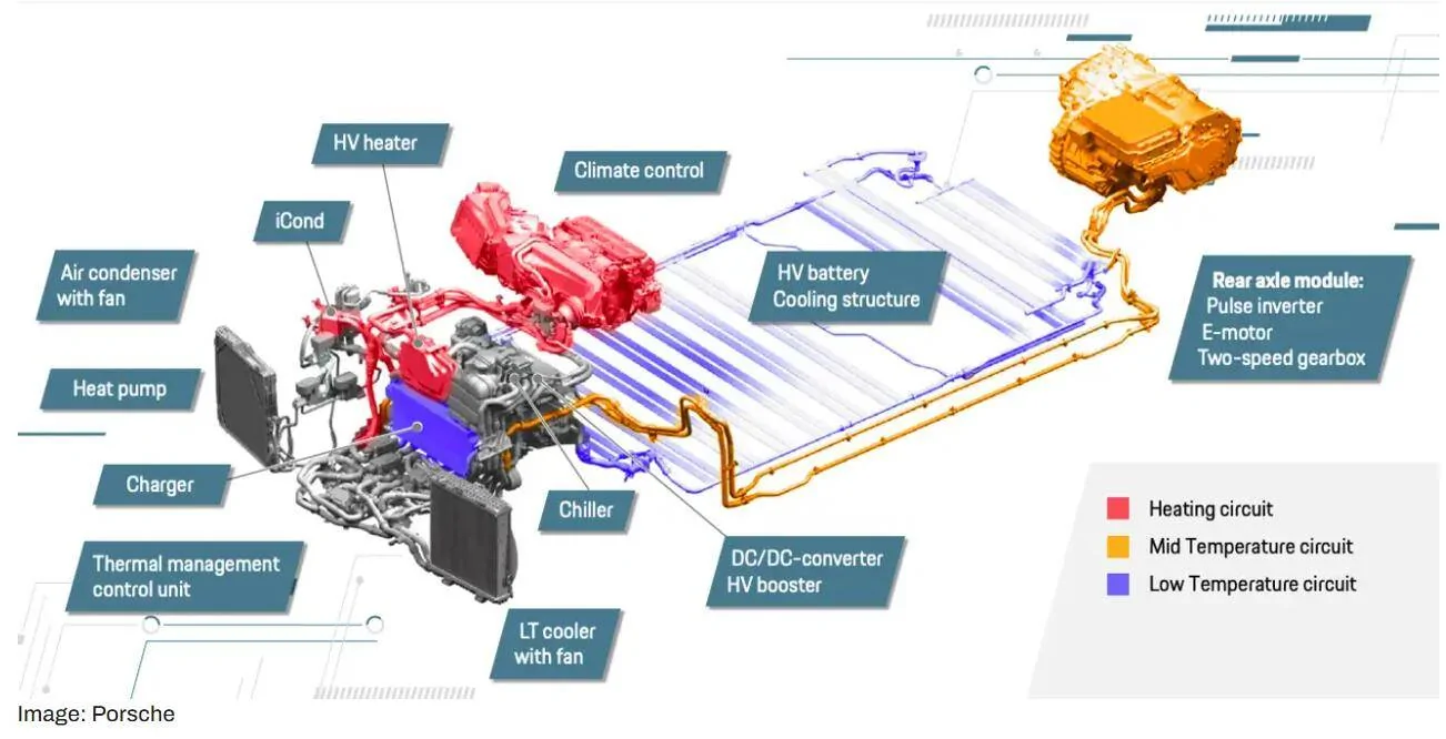

The heating and cooling circuits in the Taycan are complex. As well as the main battery circulation system, there are ancillary components tied in which serve to heat and cool the cabin. As they are interlinked, various failures can trigger issues.
The most common is the HV heater which is prone to failure during cold temps. As well as this, there are two fans in the inner wheel arches, right and left side. These are also prone to jamming with grit / dirt and failing. This will lead to a loss in performance with the cooling.
Reading the forums, it seems as if there is a new part available for the heater, and a new part is incoming for the fan - a redesigned shroud.
