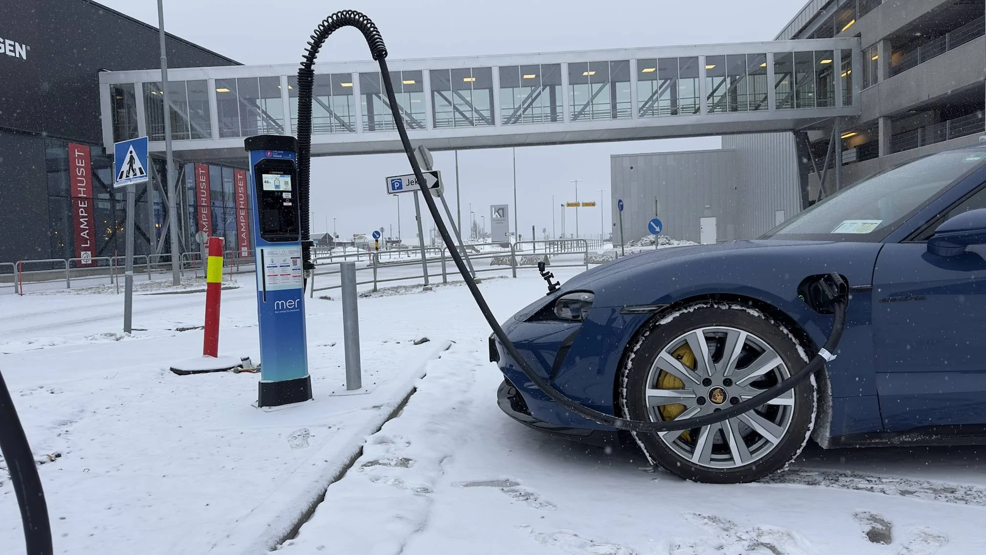

It will be fine for both fast charging:
Porsche Taycan Any tips for charging in the snow IMG_6689

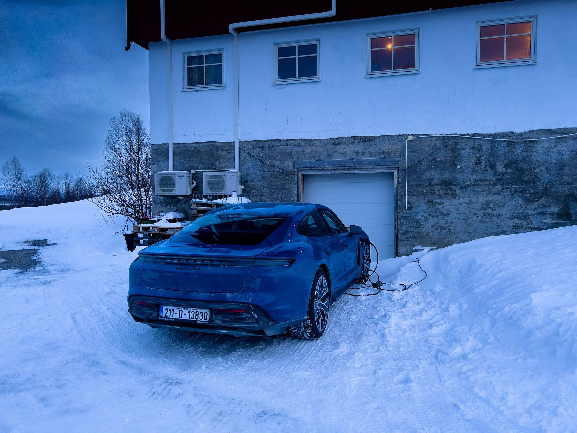

And slow:
Porsche Taycan Any tips for charging in the snow IMG_9142
You might find you have to swipe your had a few times along the touch sensitive panel for the door to open – but eventually it will. That would have been better as a button but I try to get into the habit of opening it via the panel inside.
The door motors have been explicitly designed to increase their torque and vibrate to crack any ice that may have formed over the door. I have never experienced it fail to open.
