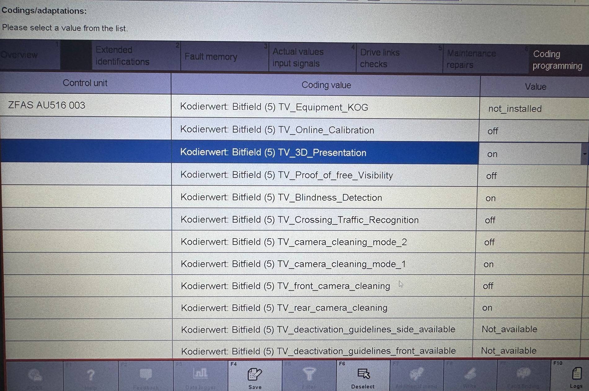

I don't believe this one has been mentioned yet. If you have surround view but not 3D surround view:
ZFAS AU516 003 -> Kodierwert -> Bitfield (5) TV_3D_Presentation
Change from "off" to "on"
@Elysium
Could you please explain what 3D surround is compared to normal 3D?
Screenshots or some more detail please…. Thanks.

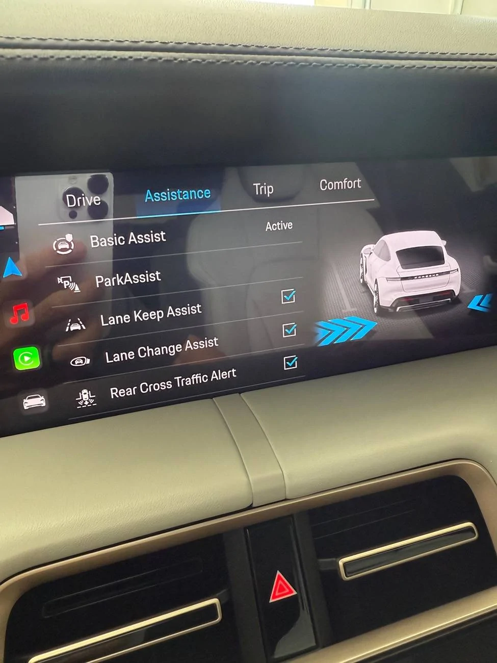

I don't have rear cross traffic alert. I'm not sure if that is only available with Innodrive. Anyway, if you have LCA you can enable rear cross traffic alert as it uses the same sensors.
Caveat: I'm not sure if it actually works since I usually park rear end first, so I haven't had a chance to test it. However, I did code it on my wife's 9Y0 Cayenne and the parking/back up camera mode notified of oncoming cross traffic while reversing
Taken from Cayenne coding on Rennlist.
Rear Radar S1 (Lane Assist Right) Kodierwert: Bitfield Rear_Cross_Traffic_Alert : with_RCTA
Rear Radar S2 (Lane Assist Left) Kodierwert: Bitfield Rear_Cross_Traffic_Alert : with_RCTA
ZFAS (Assist) Kodierwert: Bitfield (3) FW_RCTA : installed
PSM (ESP) Kodierwert: Byte 12 Rear Cross Traffic Alert : ja / an
I can't remember exactly what the modules in the Taycan are called for Rear Radar S1/S2, but they are something along the lines of "...VR...". But if you select those and go into manual coding, you'll see Radar S1/S2 listed. If I get into PIWIS again I'll remember to take note lol.

Would much appreciate if you could find the actual module names in the Taycan. Thanks.
Elysium
Mar 17, 2025
2021 Taycan
MRR_HR (Radar HR) -> Rear Radar S1 (Lane Assist Right) Kodierwert: Bitfield Rear_Cross_Traffic_Alert : with_RCTA
MRR_HL (Radar HL) -> Rear Radar S2 (Lane Assist Left) Kodierwert: Bitfield Rear_Cross_Traffic_Alert : with_RCTA
ZFAS (Zentrales Fahrer Assistenz System) -> ZFAS (Assist) Kodierwert: Bitfield (3) FW_RCTA : installed
ESP (Bremsensteuergeraet)-> PSM (ESP) Kodierwert: Byte 12 Rear Cross Traffic Alert : ja / an

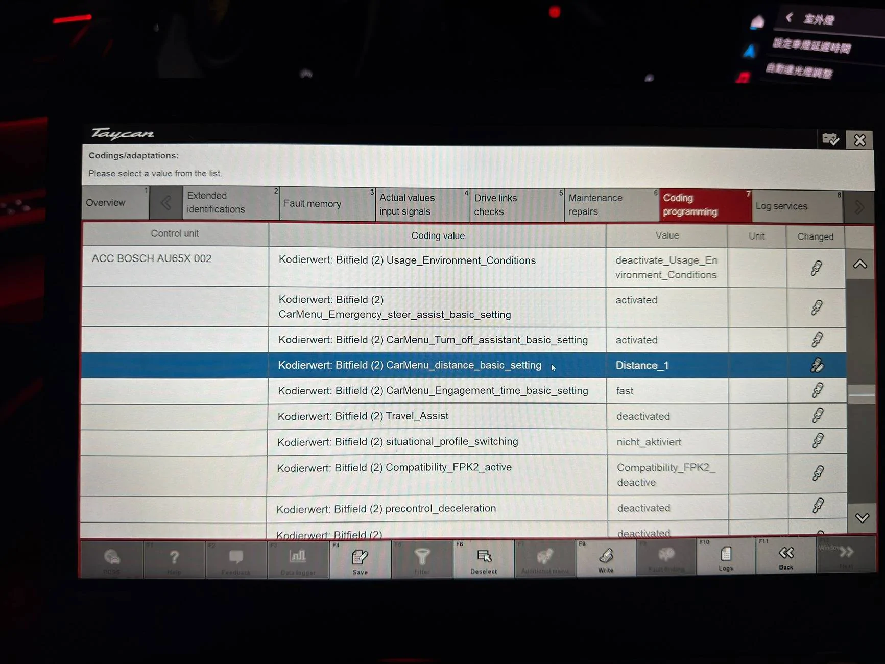

Change from Distance 3 (Default) to 1
ACC->Kodierwert->CarMenu_distance_basic_setting -> Distance 1
