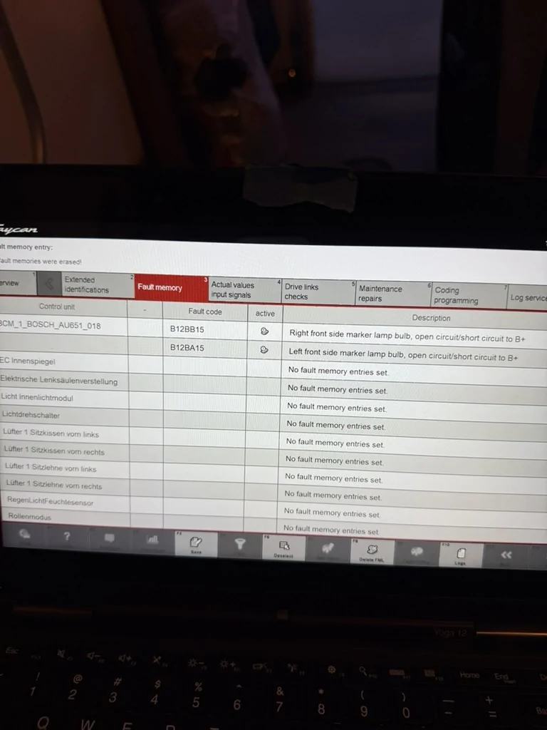

In trying to turn my side markers back on (had them off but have had them working with turn signals)
Steps:
BCM1-->kodierwert: sidemarker_via_lcm—>active (this did not work)
So I started messing around and this fault came up. The signals in the side mirrors don't come on either.

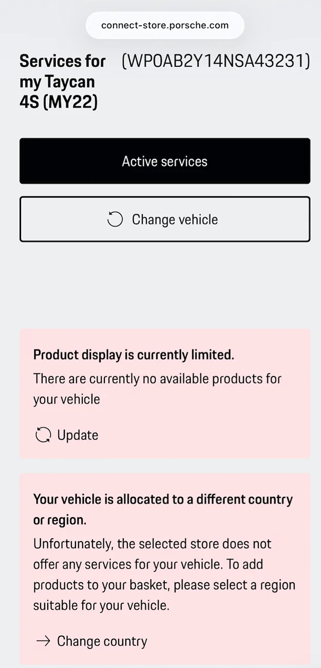

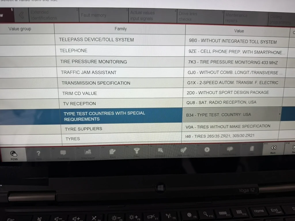

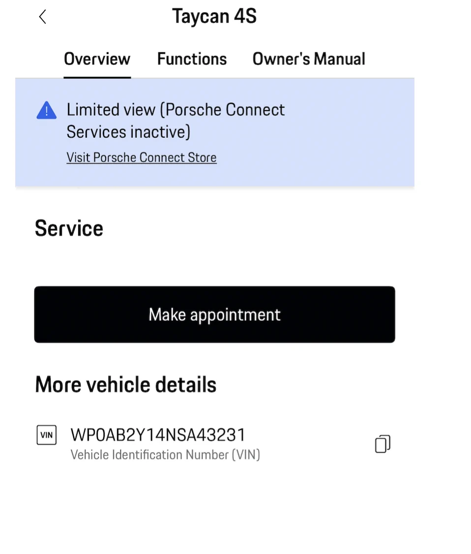

Second issue. My Porsche connect services all of a sudden stopped working. It has been working for the past year or so, even with coding that was done prior. My car still thinks it's German for some reason, even though the Type test country is set to USA.
Porsche Taycan Anyone with PIWIS? 1769449748493-6r

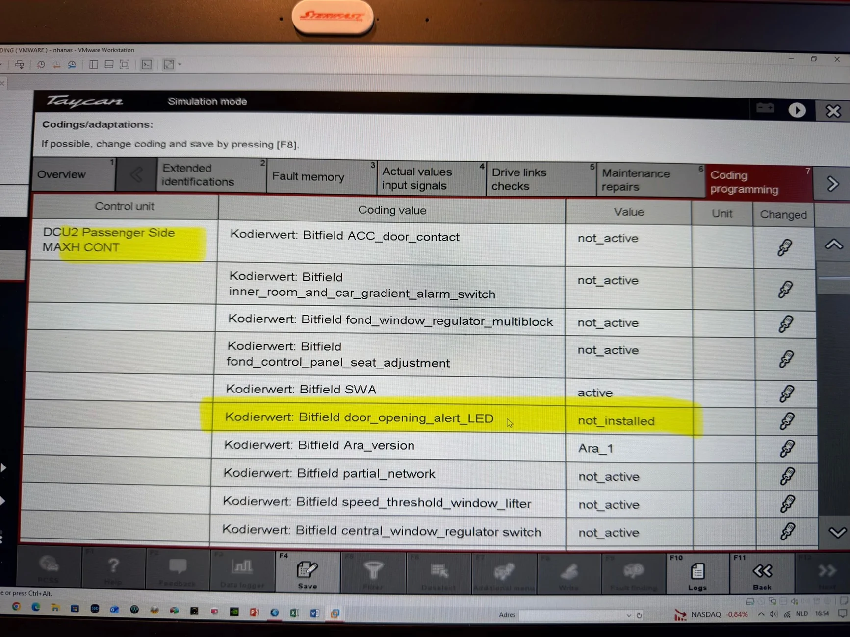

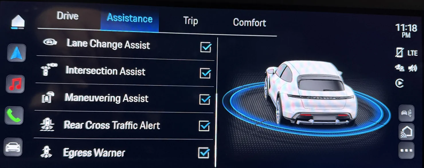

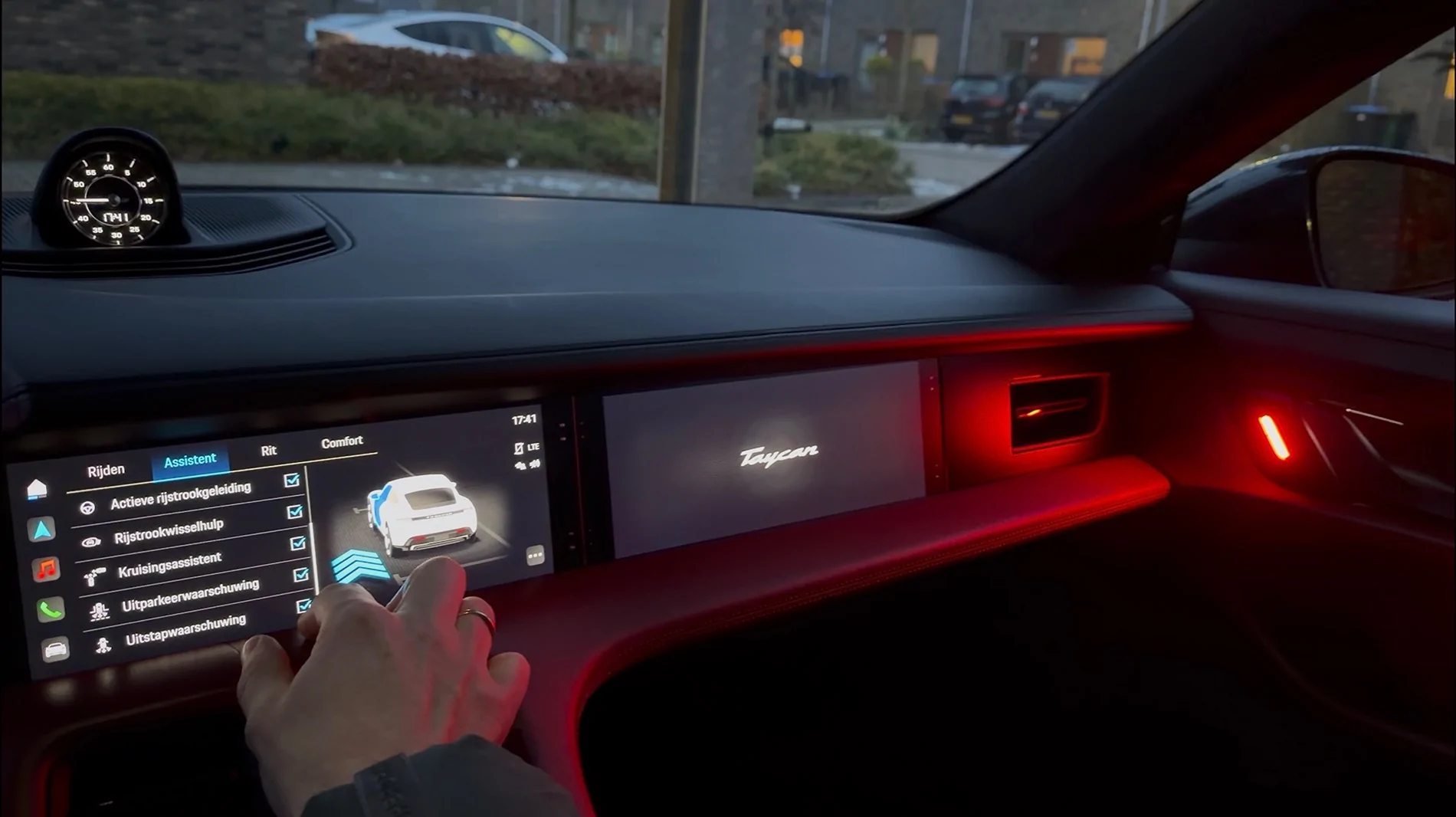

Today I was able to succesfully code Rear Traffic Assist and Exit / Egress Warning for my 2020 Taycan 4s.
I already had the LED’s in te doors for the Exit Warning, but I did not have this system on my car. I don’t know why the LEDs in the doors were there without this system and they were (ofcourse) without function.
Additional to the coding for the Exit warning earlier in this thread, I also coded the door modules for the LED:
you need all 4 door modules DCU2 Driver Side, Driver Side Rear, Passenger Side and Passenger Side Rear and then change kodierwert -> Bitfield door_opening_alert_LED to installed. Then the LEDs are also working.
Porsche Taycan Anyone with PIWIS? IMG_0499
Porsche Taycan Anyone with PIWIS? IMG_0510
Porsche Taycan Anyone with PIWIS? Afbeelding 50

Okay, I was wondering why people mentioned an LED on the door and I couldn’t find where mine was. I don’t have it! Now my car thinks I have this Egress warning, but there’s no LED light to display it. Sucks
Porsche-Guru
May 8, 2022
511
485
BMW M4, BMW 535, Taycan 4S - gone, in a 911now
I already had the LED’s in the doors for the Exit Warning, but I did not have this system on my car. I don’t know why the LEDs in the doors were there without this system and they were (ofcourse) without function.

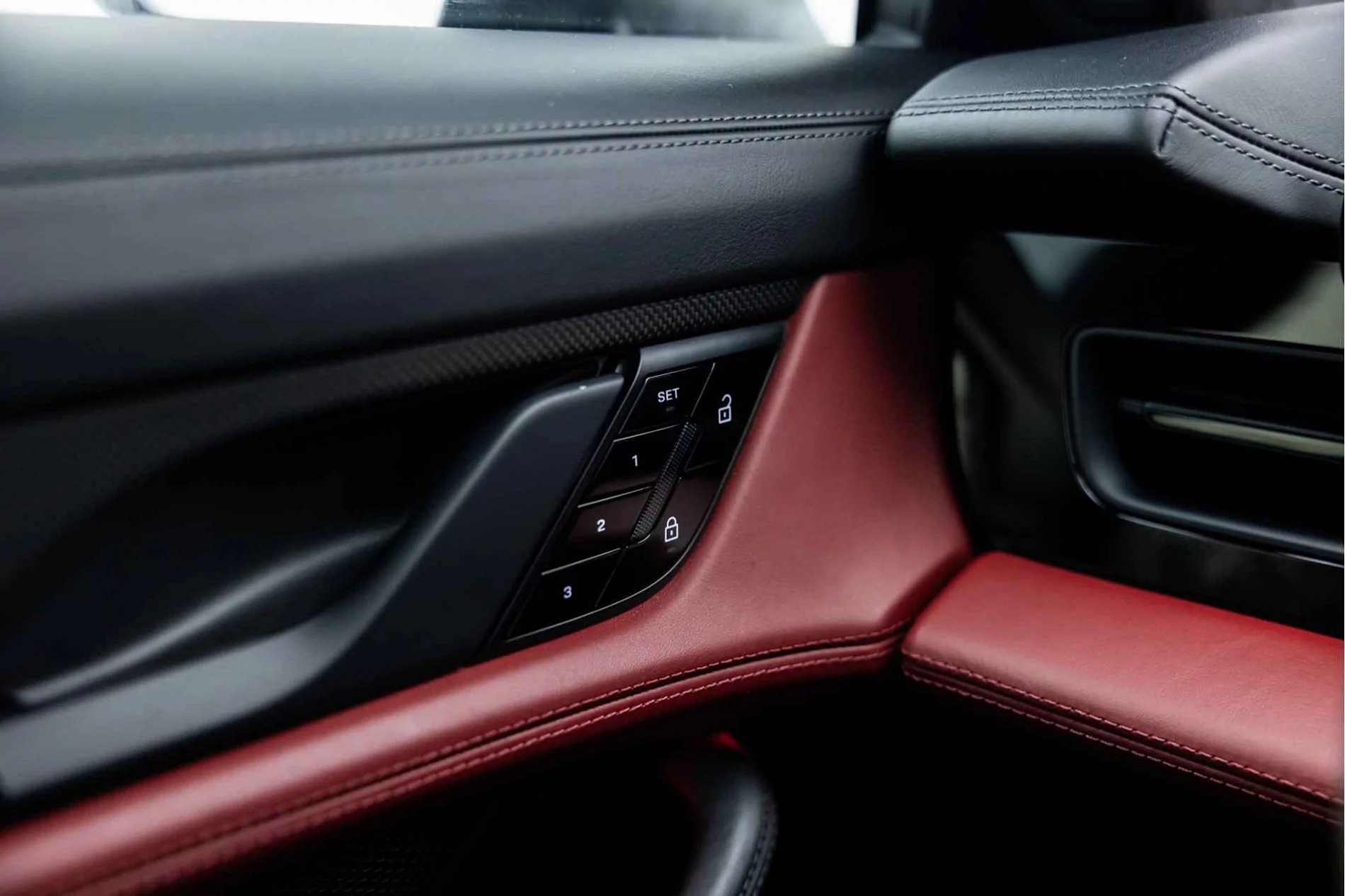

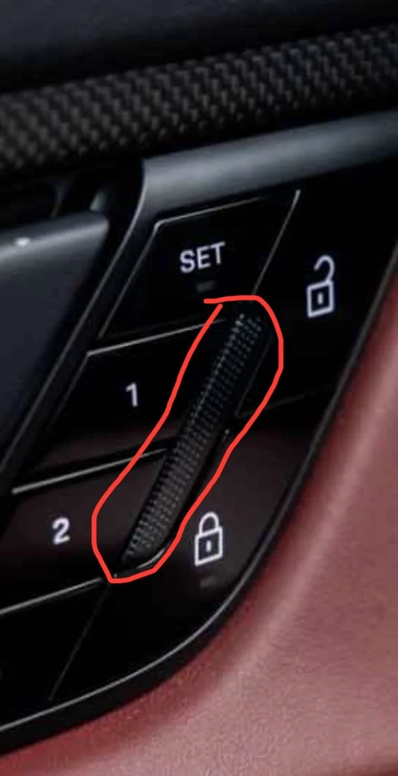

Can you send a picture/ photo of these door LEDs that you mention? Where are these located?
Thanks…
Why isn't this security feature enabled or listed in the options? sounds like it's all software/coded out.
MVS79
Martijn
Jan 12, 2026
2020 Taycan 4s
I don’t have this light … oh well
a lot of Taycans do not have these LEDs in the doors. I still wonder why mine has them although it did NOT have Exit Warning from factory. Seems strange.
After coding Exit Warning and the LEDs in the door modules, everyting works fine.
I think if you do not have the LEDs in the doors, but do have the LEDs in the side mirrors, the Exit warning it is still a useful function.
So I spent some time looking through autotrader. Non of the j1 had the light next memory control but all the j1.2 did have them. From your picture looks like you have j1.
edit : found a j1 with the light
90
8,453
7,451
My 2023 J1.1 has that LED, and the egress warning feature came enabled with the car.
Market dependent. In Switzerland it wasn't a thing, or at least not until 2023. And even then, most 2023 cars don't seem to have it over here
