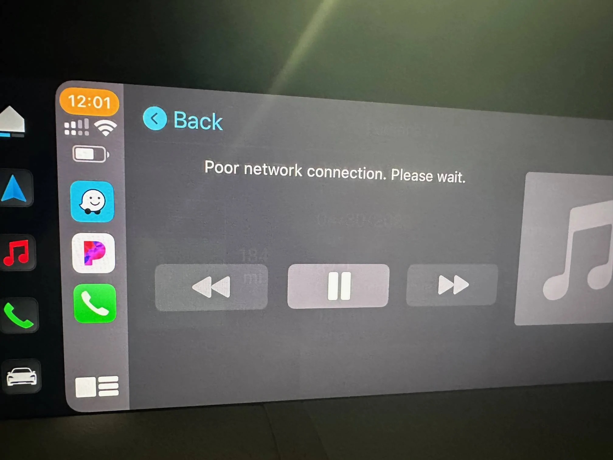

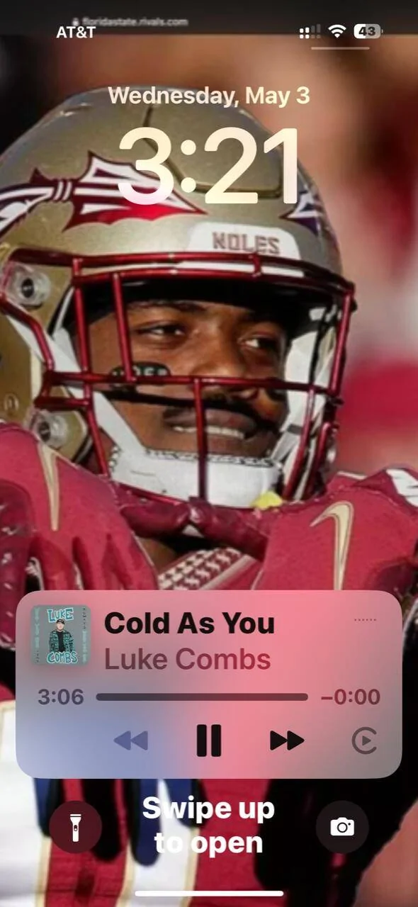

Good morning, I had this happen in September of 2022 and most recently, April of 2023. My vehicle would connect to CarPlay momentarily with 5G, then the car would then recognize the Taycan WI-FI as primary. I reset the PCM, deleted all connections between my IPhone and the car, nothing held. I reviewed my old post, and here’s what corrected it for me. I simply tell the phone to ignore the Taycan Wi-Fi connection. You must leave WI-FI on to use wireless CarPlay, so not allowing the Iphone to connect to the Taycan did the trick. Every now and then, even though I’ve instructed the car to forget the Taycan WIFI it still connects, so I simply forget the WI-FI again and it works as it should. It’s not perfect, but CarPlay Is functional again. If you see the WI-FI indicator on your phone and not the 5G indicator, it’s time to go into your settings and forget the Taycan WIFI again. I’ve had to forget it a few times the last week or so. The next time my car needs a service, I’m going to ask them to put it on a diagnostic device to see if there is a fault. Even though I forget the Taycan WI-FI, the MyPorsche App works just fine for lock status, state of charge, etc. I hope this helps.
A couple photos to show when the Wi-Fi took over (note the WiFi indicator under the time of day)
and on the top of my Iphone homescreen. When all is working well, the 5G symbol is there on both instead of the WiFi indicator. Let me know if it works for you…
