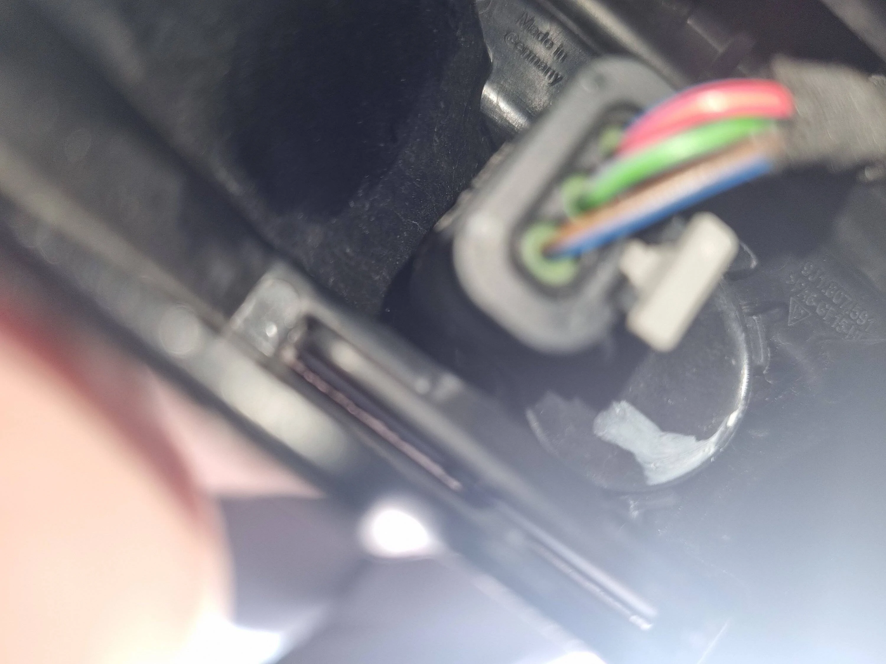

Albeit believing you Iam reluctant to and furious to pay several thousend dollar to replace a 40 Dollar sensor in a Brand new Car. Also in 20 years i never had a Stone fall in a Parkingsensor.
The sensor is visible from the Front and one can also see the clips holding the Sensor.
Can someone tell how the Plug is released from the Sensor? I assume you have to manipulate the Grey latch, but i dont know in what direction.

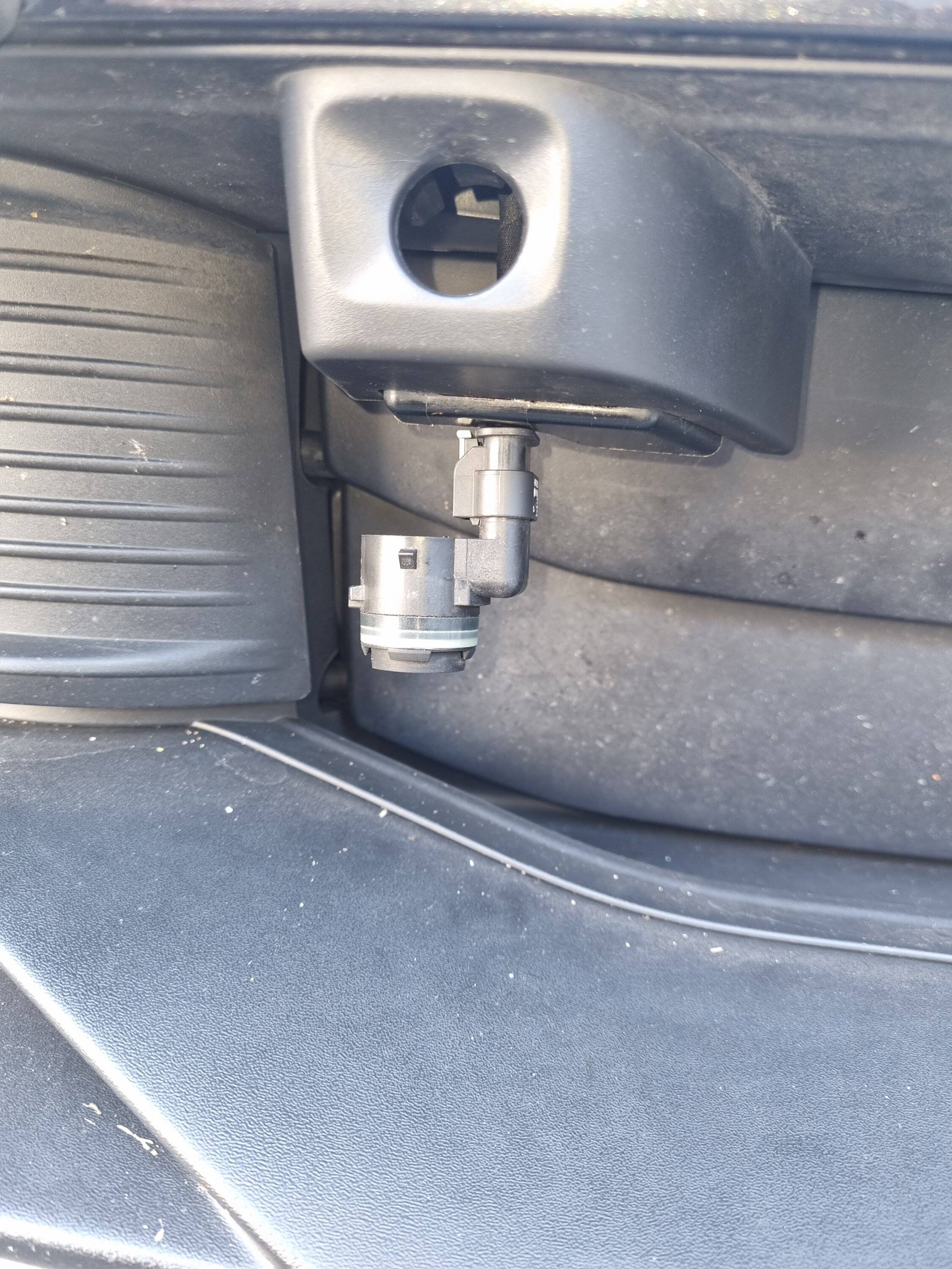

Well actually it was really easy to remove it. You just need to pri down the 2 nose holders which holds the sensor. Then push really hard. Its necessary to find pictures how the parts look like where its mounted.
Funny thing is that even in the Porsche parts katalogue is the wrong part number of the sensor, its an angled one there.
Anyway i ordered it for 50 bucks.
Even if i have porsche calibrate it, its much cheaper then let them remove the bumper.

It worked flawless but apparently the Rockfall was not a problem since the problem is the same es before.
So i guess its the Licenseplate holder for some reason.
