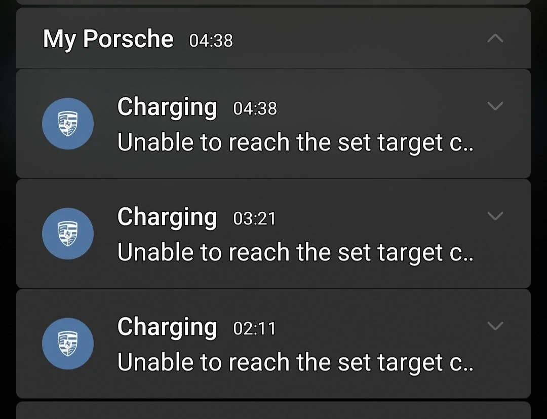

I had loads of issues with this over the years.
See pic of what I would wake up to on my phone most mornings.
These errors would flag up hours before it should even have started charging.
So I wondered if it was the car communications?
I am not sure exactly what caused it, as a few things happened.
I contacted my evse charger and they monitored it and said the system was getting too hot and cutting out as it was running at too high a voltage (supply to house apparently). They tweaked the settings and it improved a lot.
Then I switched to an intelligent charging tariff and that seemed to also help. It works most of the time now.
