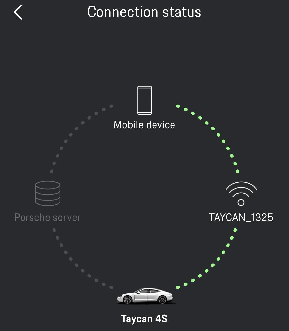

I now had my Taycan 4S for about 2 months and have had consistent problems making the connection with Porsche Connect (Android) software. In fact, I have never seen all four wireless quadrantes of the "Connection Status" display (in your message) show as green.
  1. Line segments in the "Connection Status" display are red/green inconsistently.
    1. Segment A-B: Always Green
    2. Segment B-C: Always Red (NEVER GREEN)
    3. Segment C-D: Usually Red
    4. Segment D-A: Always Green
The fact that your B-C segment which indicates the wireless connection between the car and your external Wi-Fi is green is a mystery to me as I've never been able to make this connection turn green.
  • When you set up the car, were you able to get the PCM's Wi-Fi to provide mobile access to phones in the car via Wi-Fi? I've only been able to get the phone to see the Wi-Fi access point, connect to it, but it says that there is no internet service on the connection. I called Porsche, they told me that it is an ATT wireless issue (I live in California) and that Porsche is aware of it. However, it appears as though you were able to activate your Wi-Fi so that it is connected to the car as evidenced by the B-C Segment.
  • Despite that the four segments are not green, I am still able to review the charge/voltage and range status, adjust the timer and charge profiles, review trip data, tire pressure, etc.
My suggestion is that despite that you are getting a message that the car is not connected; (I get that as well and I am able to see and modify a number of parameters related to charging, temperature, etc. remotely), try it to see what you can do and what functions are available. Note, the full remote operations of windows, door locks, etc. is not yet available.

The odd thing is that on my IPhone it says not connected to the Taycan Wifi, but the app shows those 3 segments green, just not the Porsche server. Also, I’m not able to use any of the PCM services like weather, real time traffic, calendar yet..

Although you will find the Taycan's wifi network, Porsche has not enabled the hotspot functionality so you cannot use it to connect to the internet. It is rare to have all 4 segments to be green. In general it does not affect your ability to use the various services. The Taycan uses its own eSim card to connect to the mothership for various things like updates for the Nav system and to enable internet radio, Apple Music, etc.

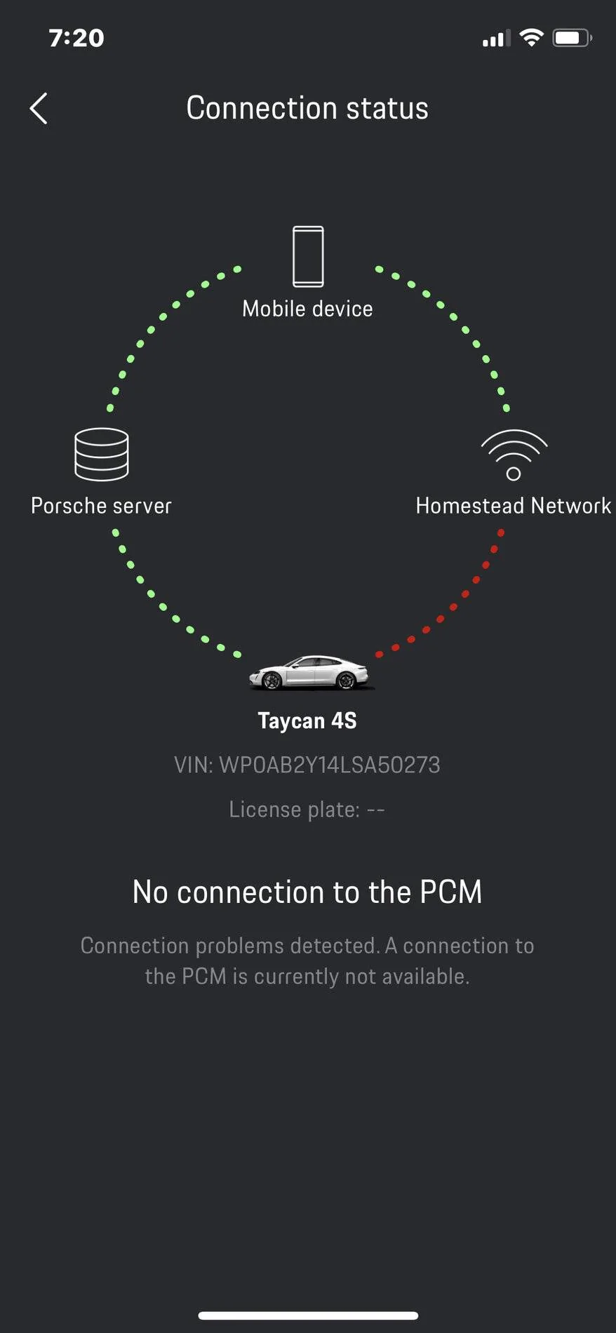

Jaydoc
Judith
May 29, 2020
78
911 Targa, Taycan on order
This is what I get in the Connect app. Homestead network is my home wifi and the car is in the garage which does have a signal. I can't find anything in the manual or online to help. I'm assuming that whatever this error is explains why my car charges to 100% despite having setup the timer/profile to 85%. This is driving me crazy. Any help appreciated. I haven't tried charging at an EV yet
Porsche Taycan Charging America App Not Speaking... IMG_545165D7155B-1
