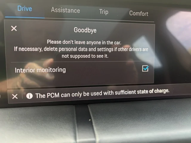

Interesting, never noticed this during the first time chassis error (see pic)
When I turn off the car and before I open the door the screen says this at the bottom, leading me to believe it is warning me about 12V state of charge? Or is this just a reminder not to drain your battery by using screens when vehicle is turned off??
That has nothing to do with it.
In fact, it's a useless notification.
I've seen that a few times but my car has an excellent working 12V recharging system, always has, six years already.
If you would have a problem with the 12V there would be a warning on your dash/app.
That warning is an indication your 12V battery is about to die (if your car is still alive that is).
You don't have that warning.
OK - I was hoping it was a statement of the obvious. CYA - tell the customer not to run down their battery.
