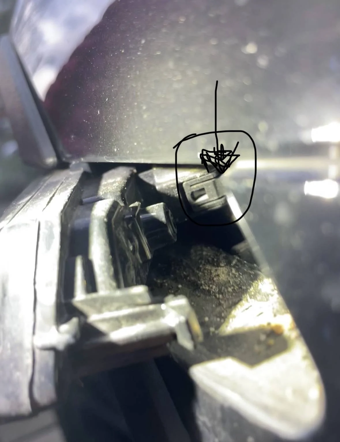

2023 CT4. The fabric insulation needed T25 Torx and attaching the side marker took T20. Hardest part was to figure out how to disconnect the power. I found flipping out the part facing front of car made it easiest to release the plug. The release is only on one side and was on the side facing the front of the car. Pic attached with arrow drawn pointing at the part to squeeze.
The tip to pre-thread the T20 into new marker before installing was good, and also I cleaned out the accumulated dirt around the old marker before installing new one (both mentioned in the Tactical Expedition YouTube).
15 mins for first side and 5-10 for the second.

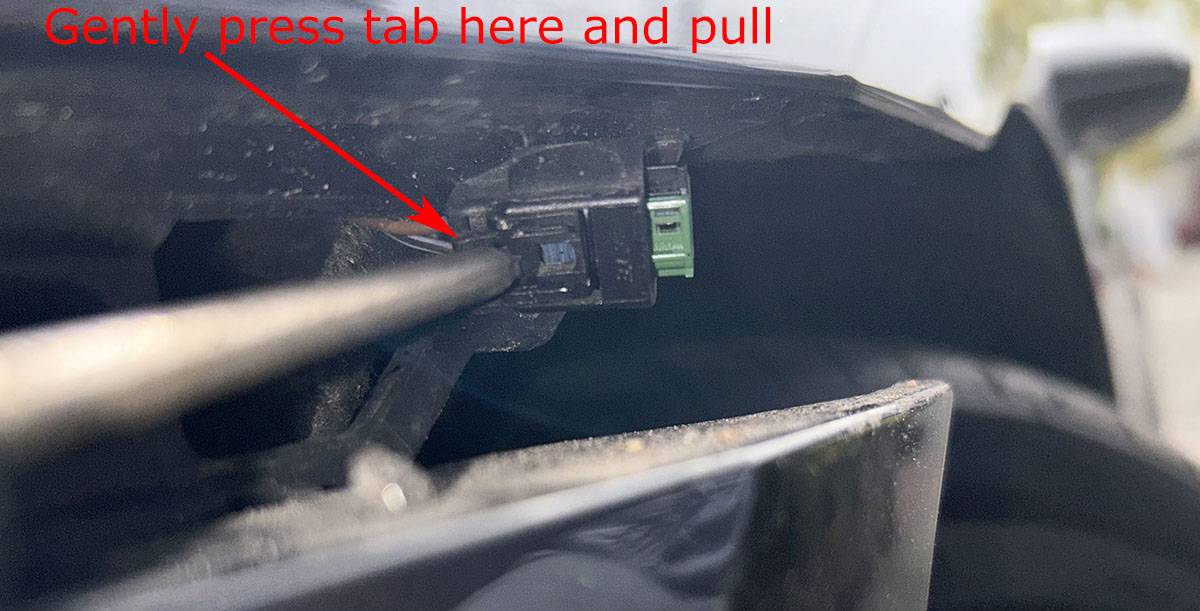

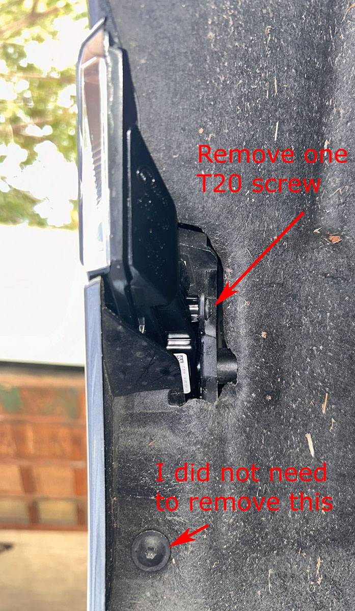

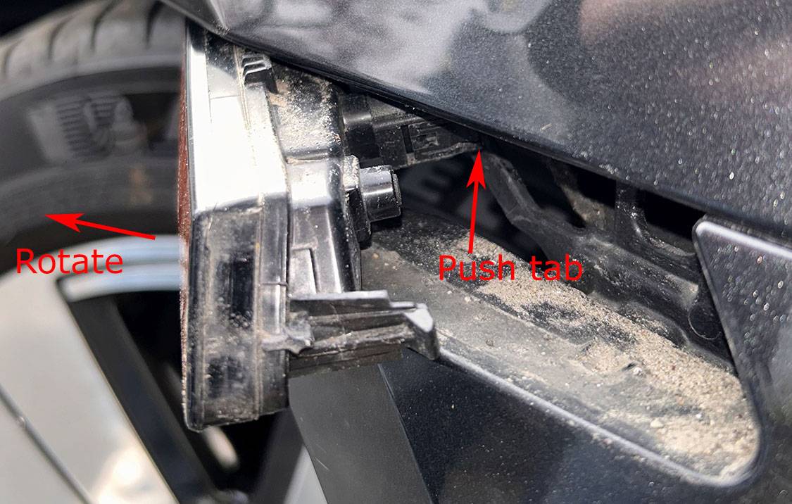

Thanks everyone for posting help. Done today with no issues. Here are three more photos that might clarify just a little more. I did clean everything before the new ones went in. For the hardest part, I used my T20 driver to gently push in the tab on the electrical connector to release the catch and gently pulled the marker away while rocking it a bit. The tab is towards the front of the car on both sides. For me, it was easiest to lay on the ground looking up to remove the one screw.
