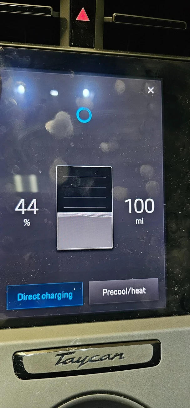

On my J1.1, as soon as I plug in (home charger), the status and buttons appear (see pic) - if direct charging button is selected, it remains in direct charging (100%) mode - including future charging sessions - until you deselect that button. Then it will return to profile setting.
No-one is debating this. The question relates to high-speed DC (Direct Current) charging.
Home chargers use AC (Alternating Current) up to 22kW where profiles and timers are available, assuming Direct Charging is not enabled.
Fully understand that. I wasn't debating. I was just trying to be helpful as subsequent posts referenced "home/selection of direct charging/"DC"/none work all the time" and I was tricked/unclear first couple times not realizing I had hit that button. Meaning it ignored profile and charged to 100% at EA fast charger (for reasons noted above) AND at home. I thought something was wrong because profile said 80%. Direct charging button was blue (is that "on or off"), etc. So I posted to pic to try to help anyone else who perhaps was tricked like me.
