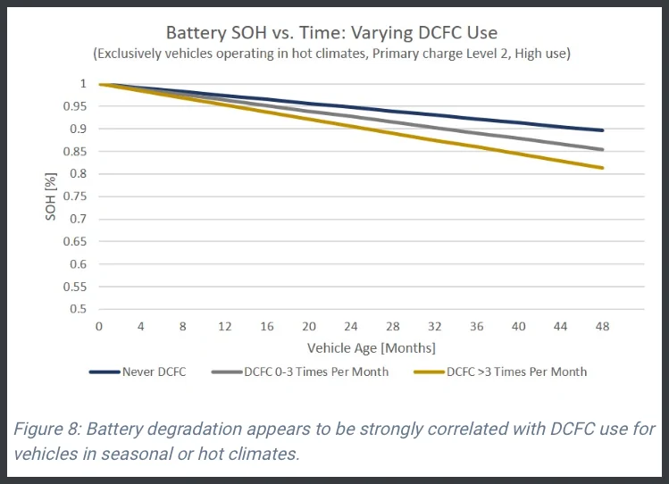

Have a look at this thread - need to scroll down midway in first post to see graph reproduced below amongst others and links to relevant web site but yes heavy DC charging vs AC can have a more detrimental effect on SoH of a battery but the actual differences may not be deemed significant - ymmv :)
Thread link: #1
Porsche Taycan Always Be Fast Chargin'? Screenshot 2023-06-04 at 3.20.17 PM
