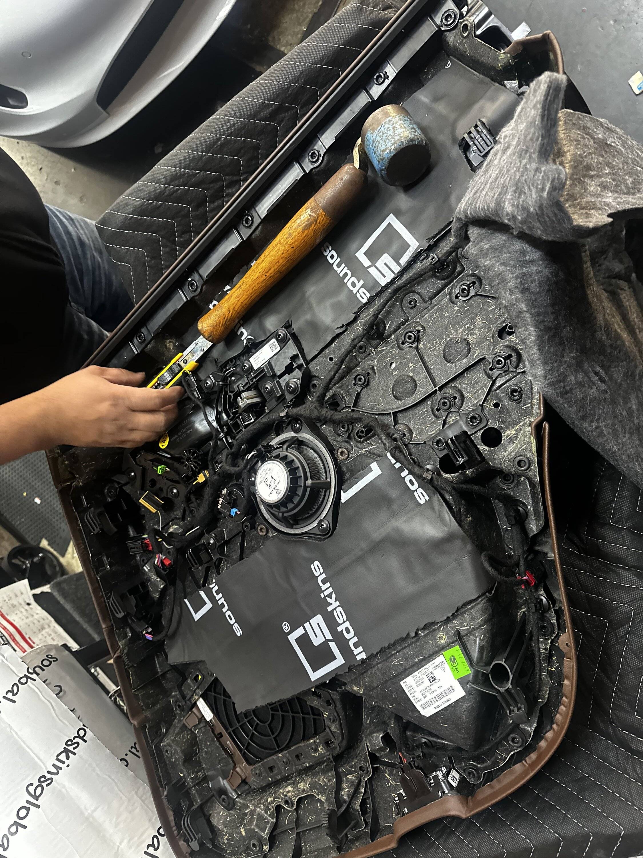

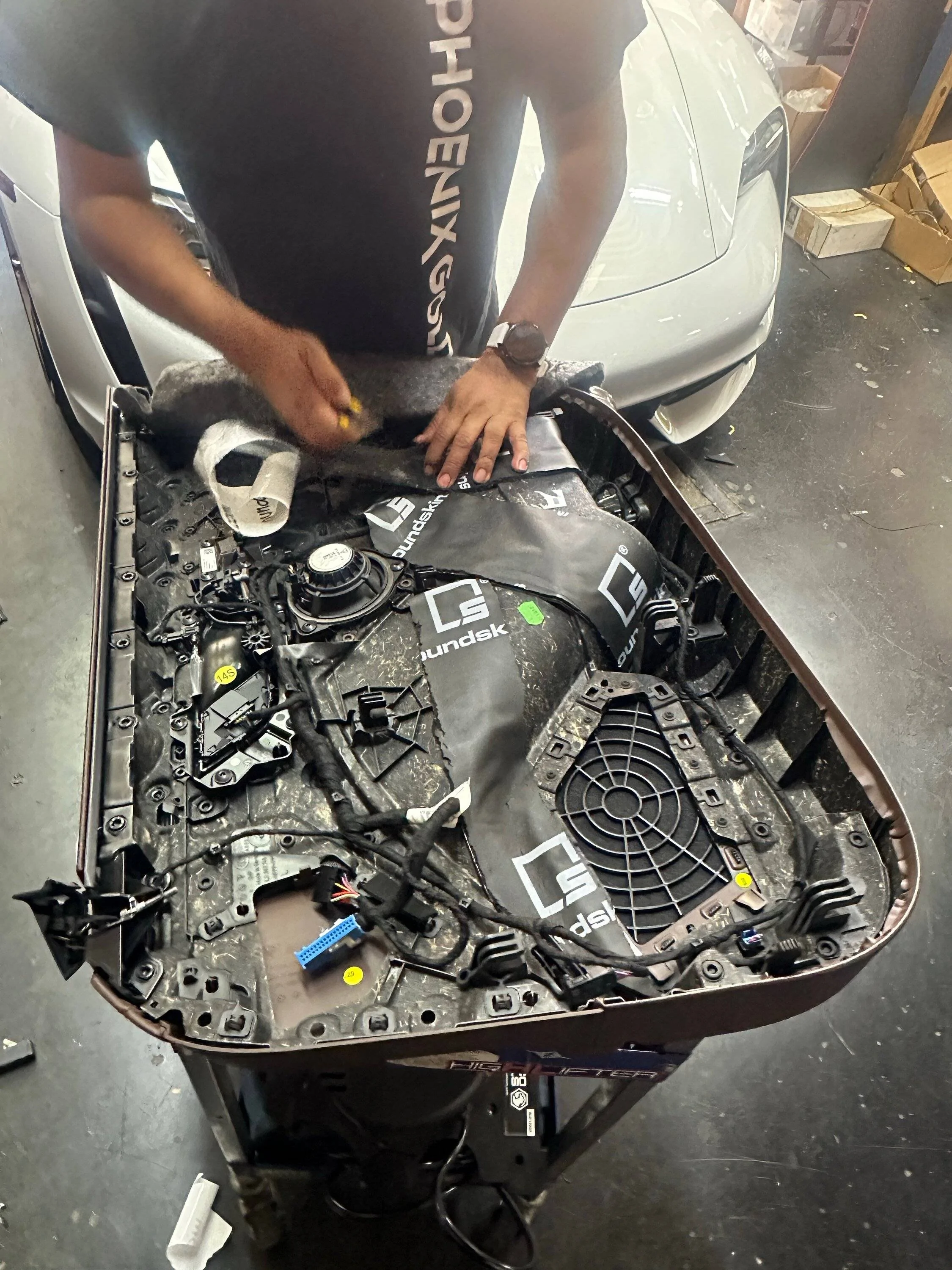

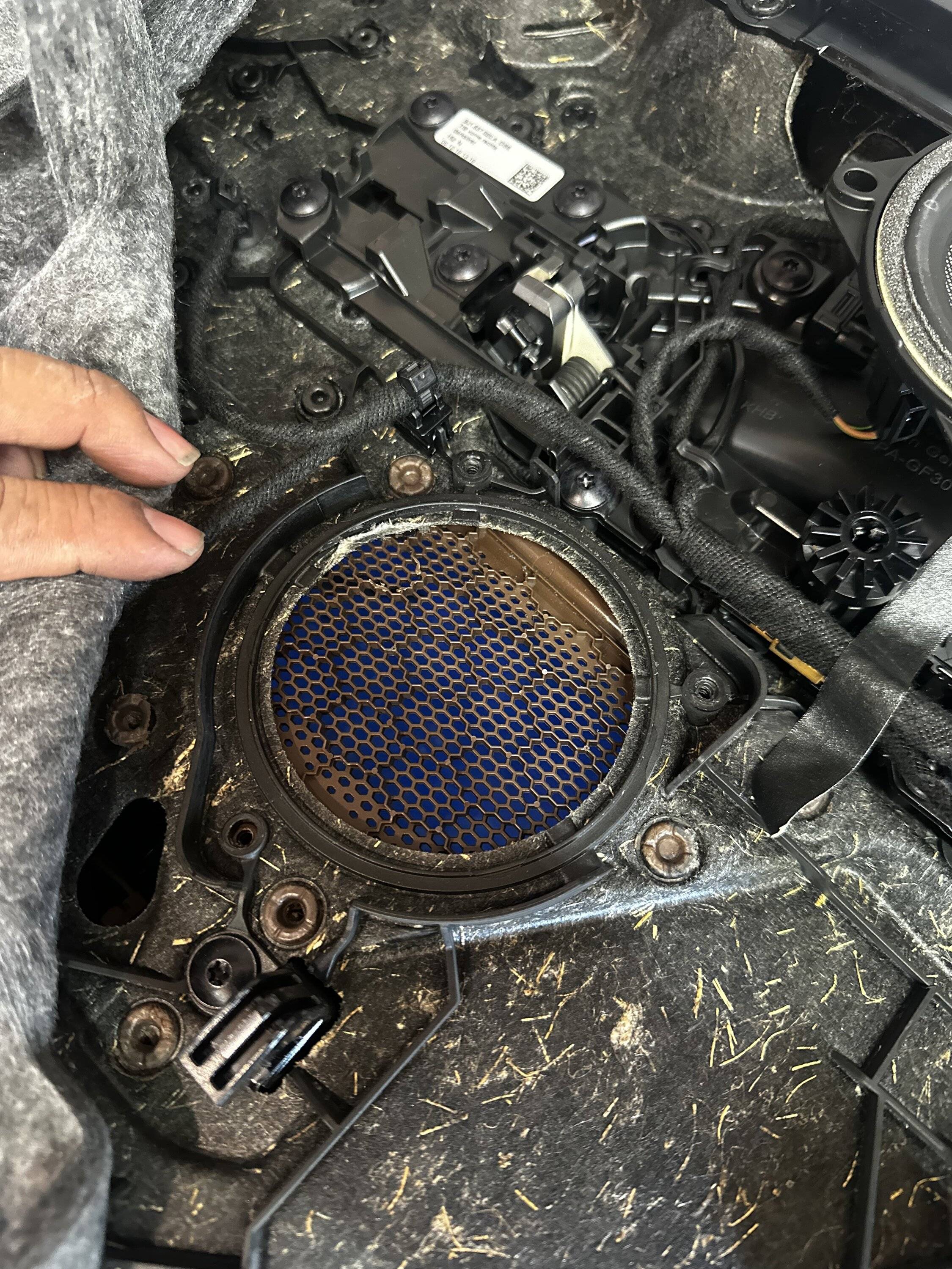

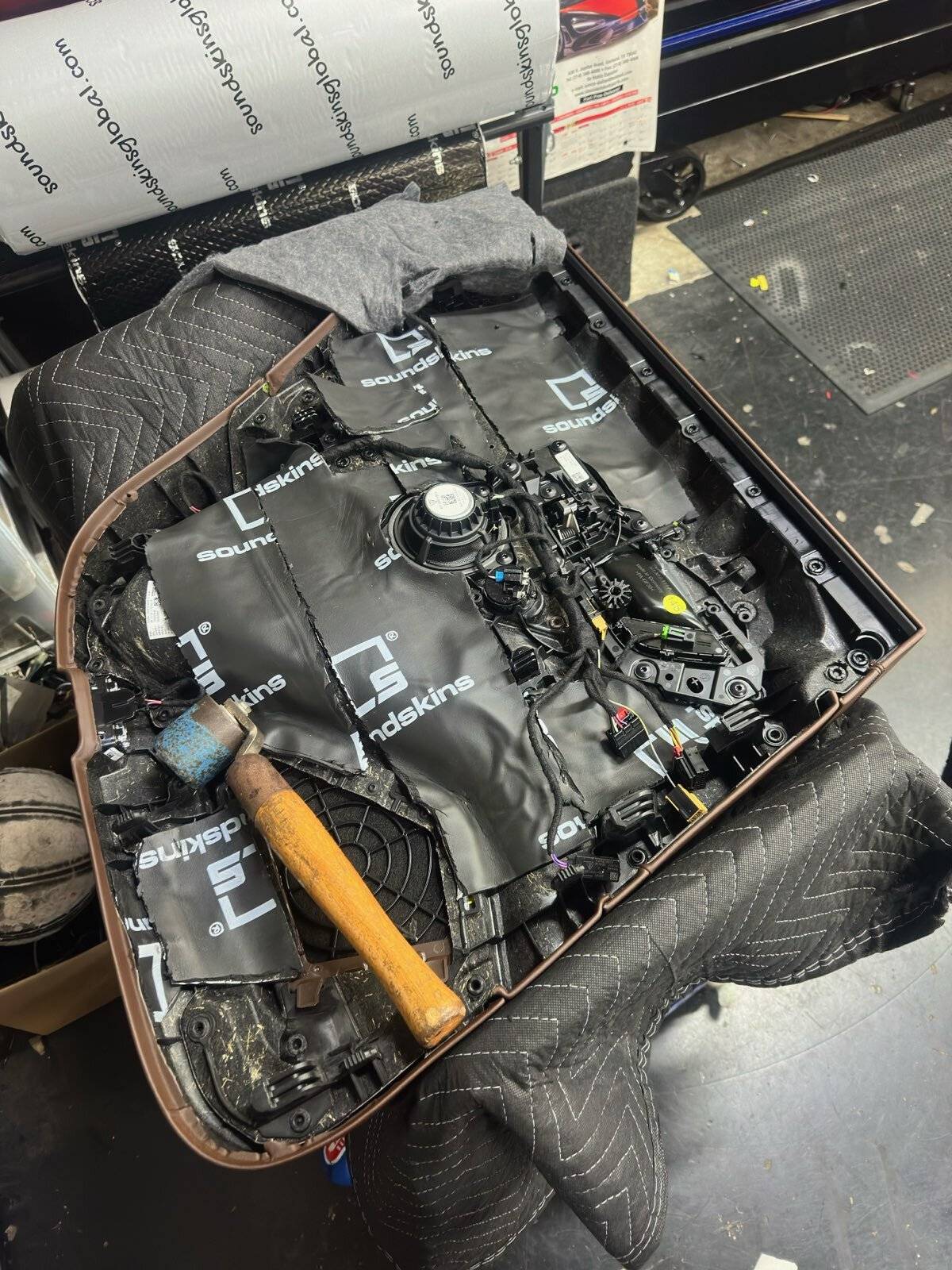

So my stereo shop in Dallas installed my Radenso radar system and ALP anti-laser sensors, and also removed the door panels and sound matted the interior door panels on 4 doors. They also did the fix listed in this thread removing the plastic brackets covering the woofer. It made a huge difference with the rattling. Almost all the rattles gone except for one rattle on passenger front door I’ll have them look at this week. I’ve included some pics of before and after.
