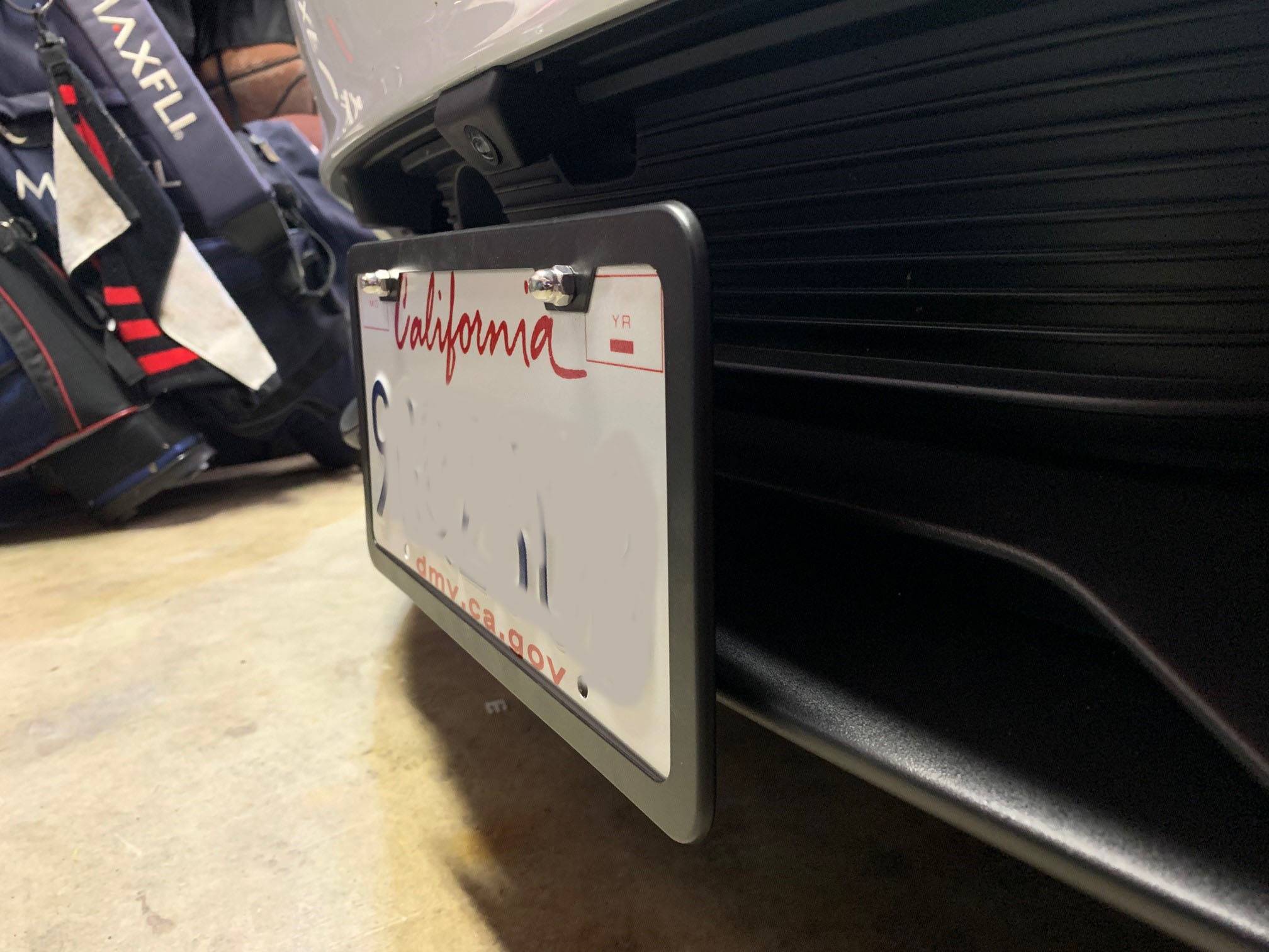

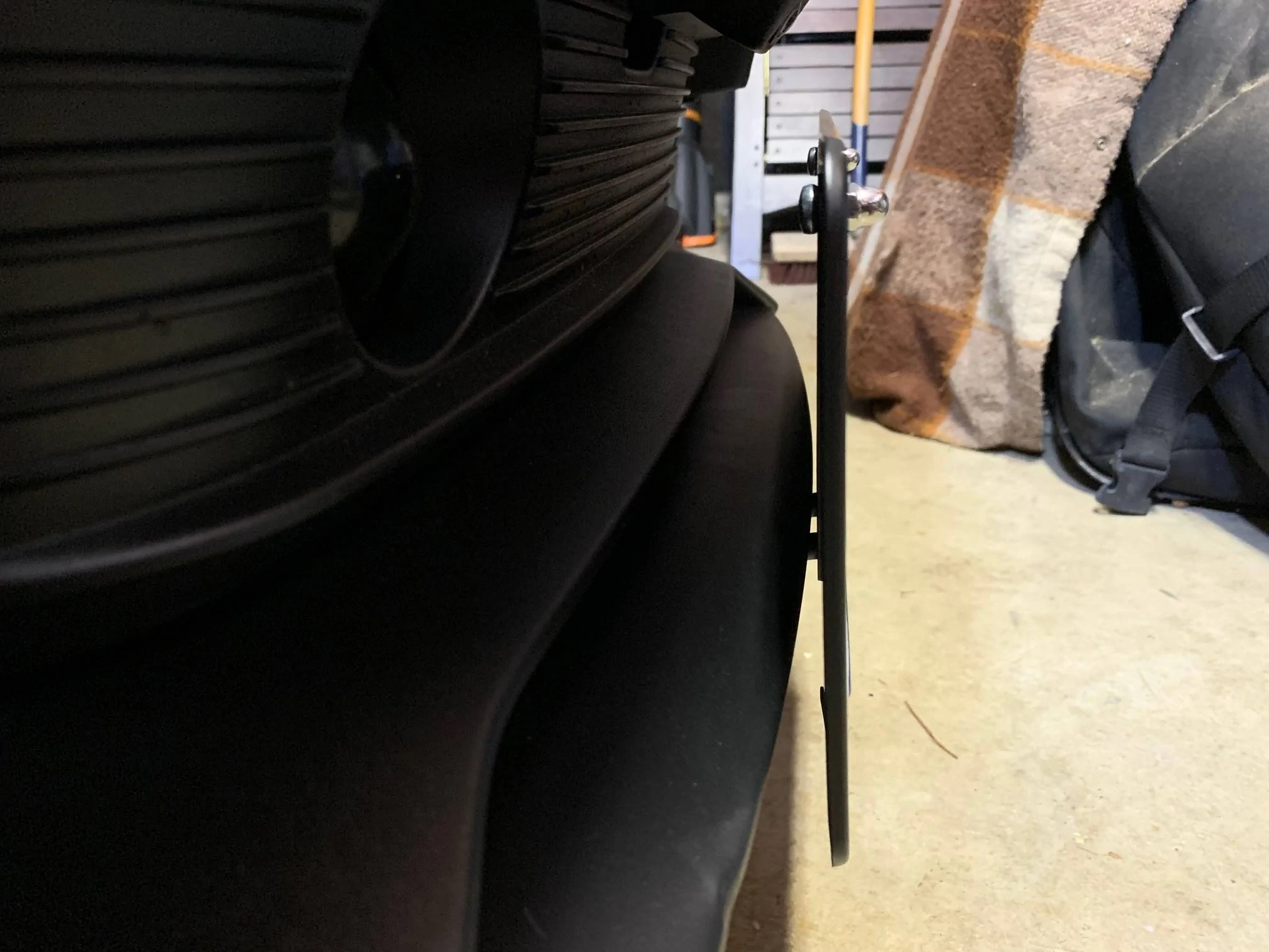

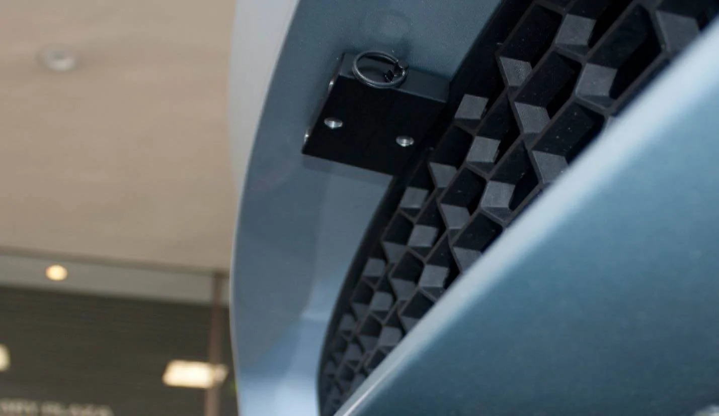

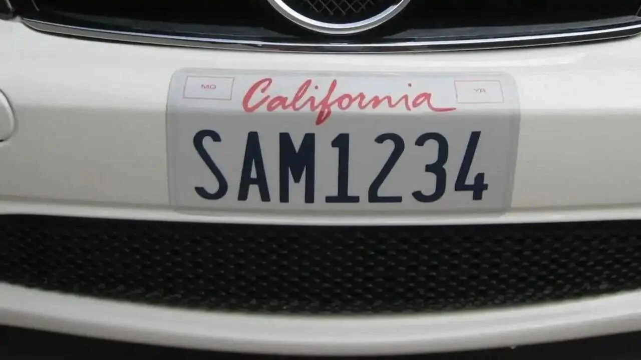

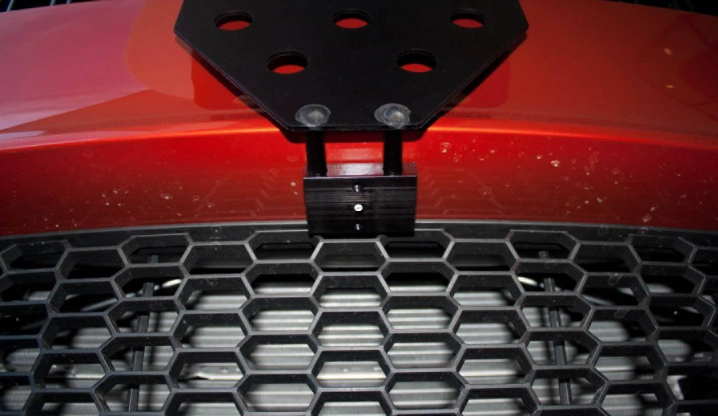

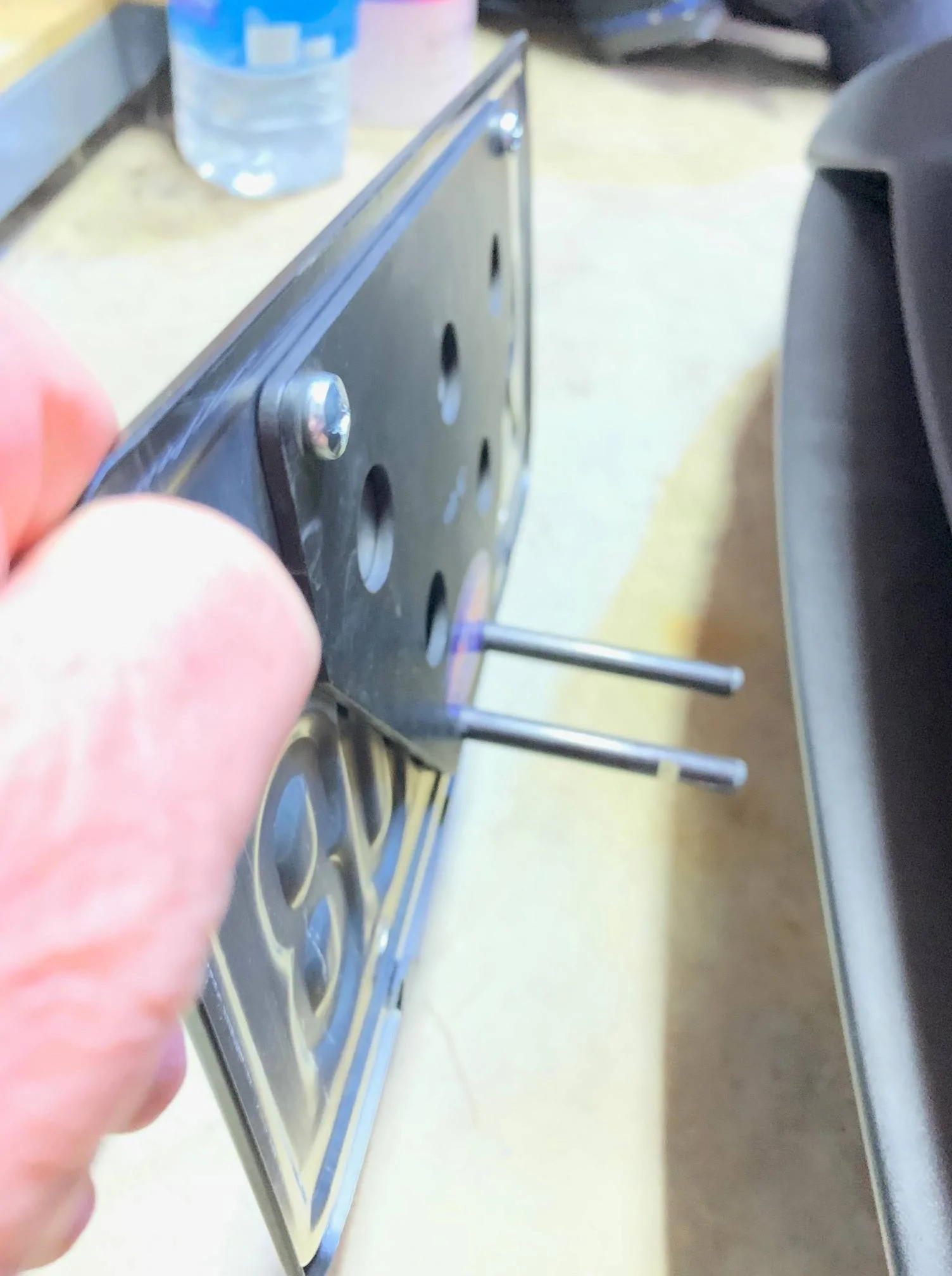

I used a Sto N Sho that I had for my BMW M4 - it fits fine on my GTS and I'm quite sure I'm not blocking any sensors - I keep the plate affixed as in the first picture in my trunk just in case I'm stopped. You can see how it mounts in the last couple of stock pictures - the holder piece will stay in place with double-sided tape although there's also a hole for a screw.

So you double side tape the mount? i thought its suppose to go underneath on the driver side? I ordered one from amazon but haven't installed it yet. Thanks

I did double-side tape the mount and also put a small screw up into the underside of the very bottom of the lip - cannot see the mount at all. And I centered it on the car - it's under the center front sensor, shown in the 2nd picture
