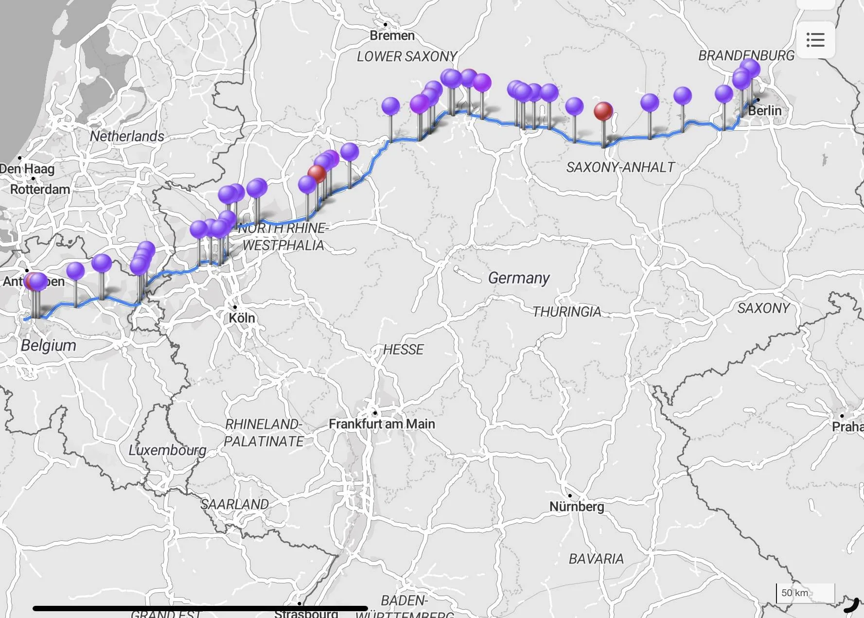

Just crossed Germany from West to East, and wanted to share a few facts/findings.

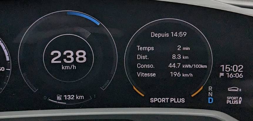

- speed : there are few unlimited portions of highways. and they seem very short at these unlimited speeds :confused: Car (ST RWD) would reach 148mph quite easily. According to powermeter, it was using only 40% at this speed

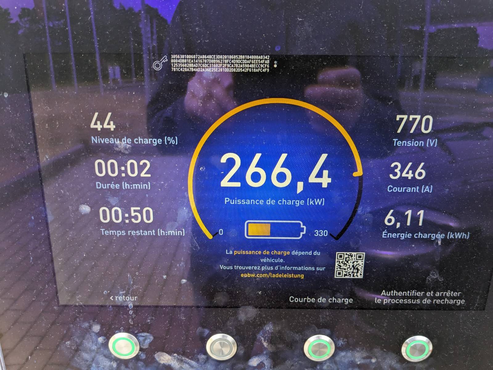

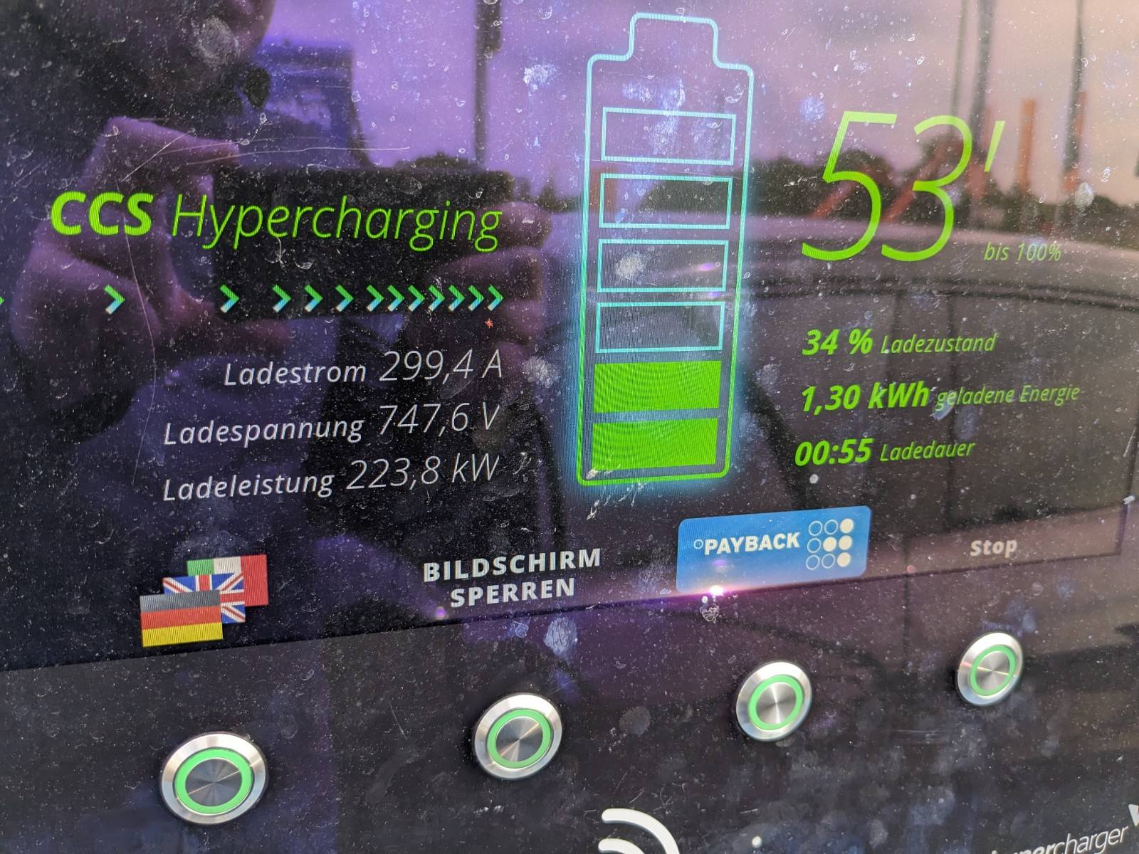

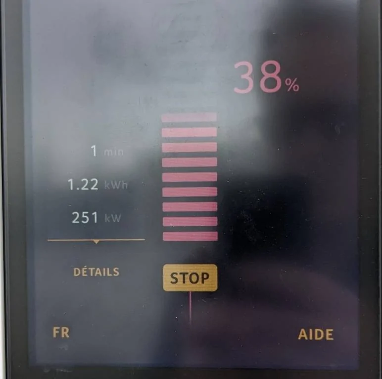

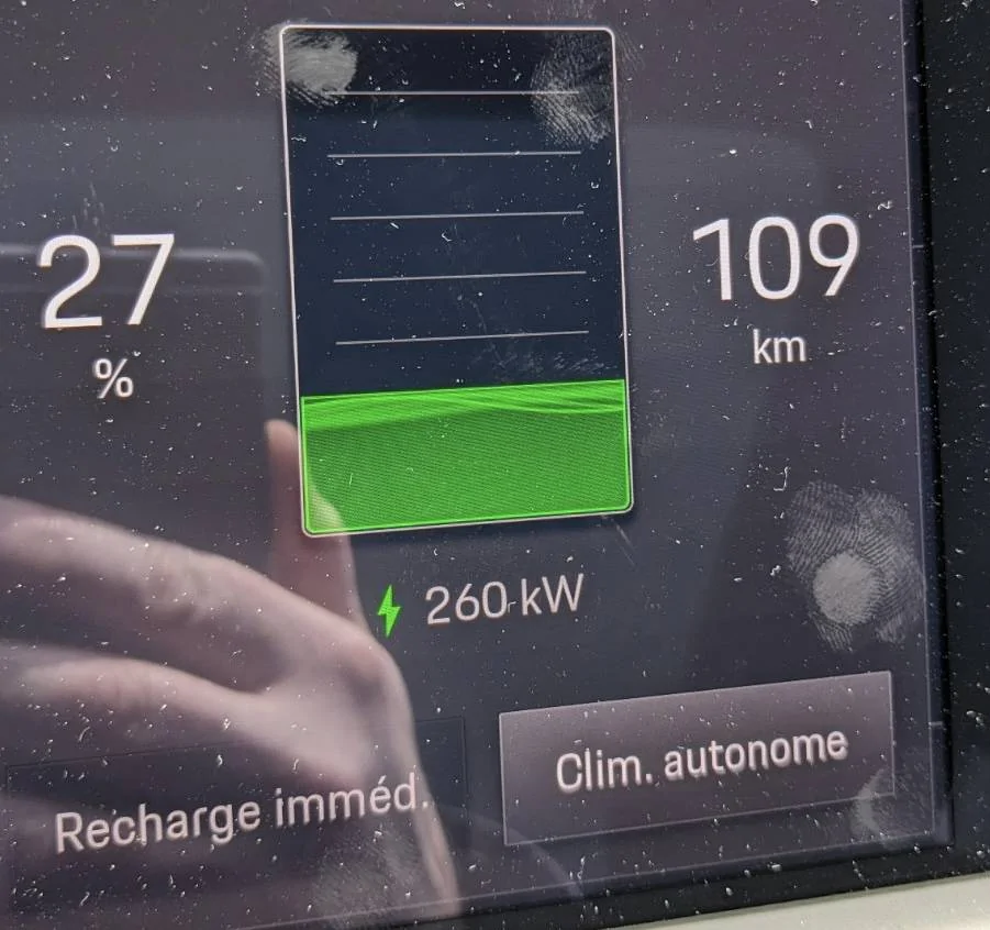

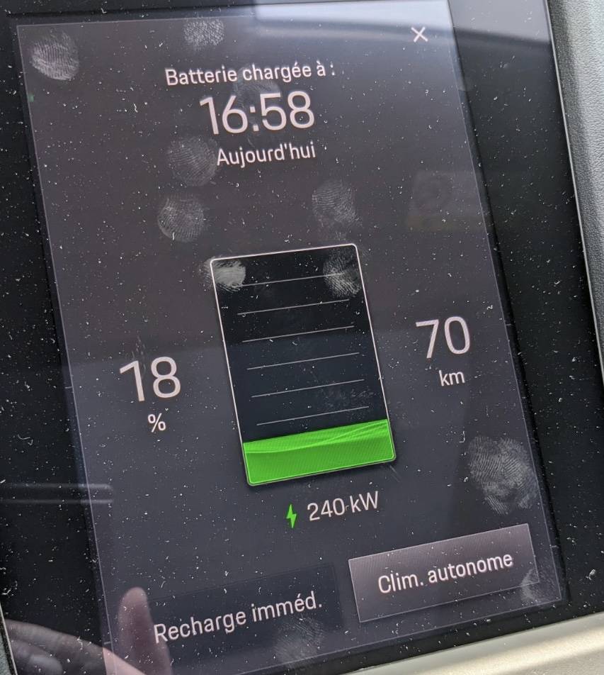

- charging / preheat : i wanted to test different networks: Aral, EnBW, Ionity. No problem to connect, most of the time i was the only one charging. Charging speed (with preheating the battery) was always good, between 220 to 266 kW

For the last one, i decided to stop Nav, so to check if charging speed would be worse without preheat.
Battery was at 36C/97F without preheat, while it was close to 41C/106F with.
As one could expect at these temp, charging speed was identical: started at 240, went fast to 260 kW. Preheat is not needed when battery is more than 35/95.

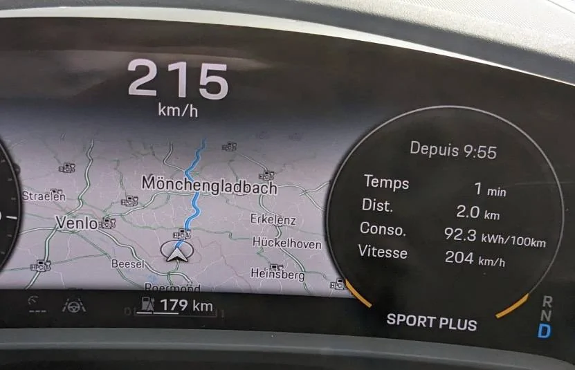

- consumption: i’ll start from the very high, going to the (very) low. I wasn’t trying to break records, just driving according the traffic / speed limits. Driving with AC eco set to 21C (20’ aero wheels). Weather: no wind, outside temp around 29C / 84F
very high: 92kWh/100km or 0.7 mi/kWh close to top speed … that would mean a range <100km / 60 mi :rolleyes:

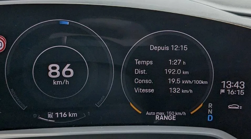

normal: driving for 190km/120mi switching between range when speed limits to sport plus when unlimited
average speed of 132km/h (82mph) for a consumption of 19.5kWh/100 km (3.2 mi/kWh)

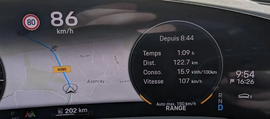

low: before reaching Germany, driving in Belgium/Netherlands. average speed of 107km/h (66mph) for 15,9 kWh/100km (3.9 mi/kWh)

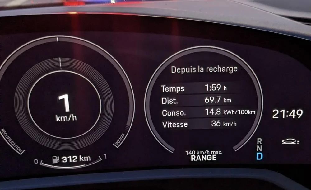

(finally) very low: in/near Berlin. as low as 4.2 mi/kWh. Range near to 350 miles…
