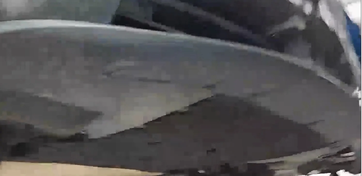

I wonder if you can expand on what you mean by undertray
I am going by the low quality video they send from a walkaround, but I think it is at the front - the dark coloured part in this frame:
Porsche Taycan How do you decide when/whether to replace the undertray? IMG_1941
I had holes in the same place in my last Taycan and they say it is very common.

Good, it is not the steel plate. Otherwise, there is no way the cooling system will be ok with it.
These are plastic covers, snapped by plastic pins. Sure, they may have scrapes, but actual holes, that still seems very strange, but I would agree that water/salt would not matter as they are not waterproof and are there to smooth the bottom for aerodynamics and to take the scrapes from speed bumps.
