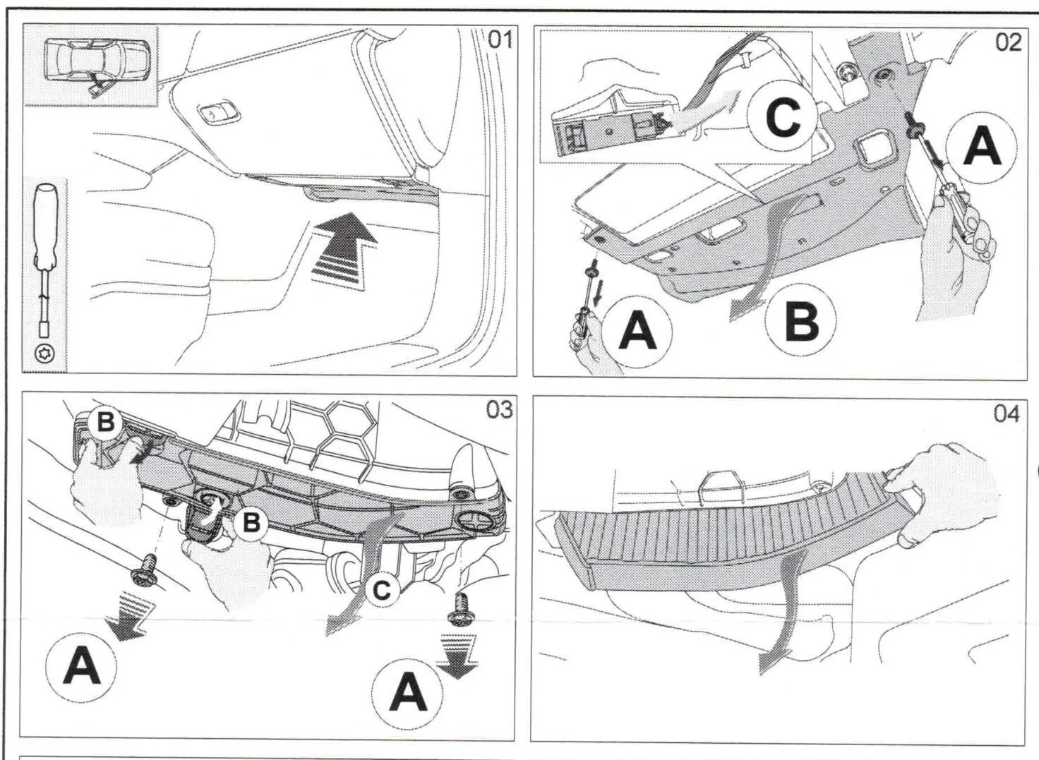

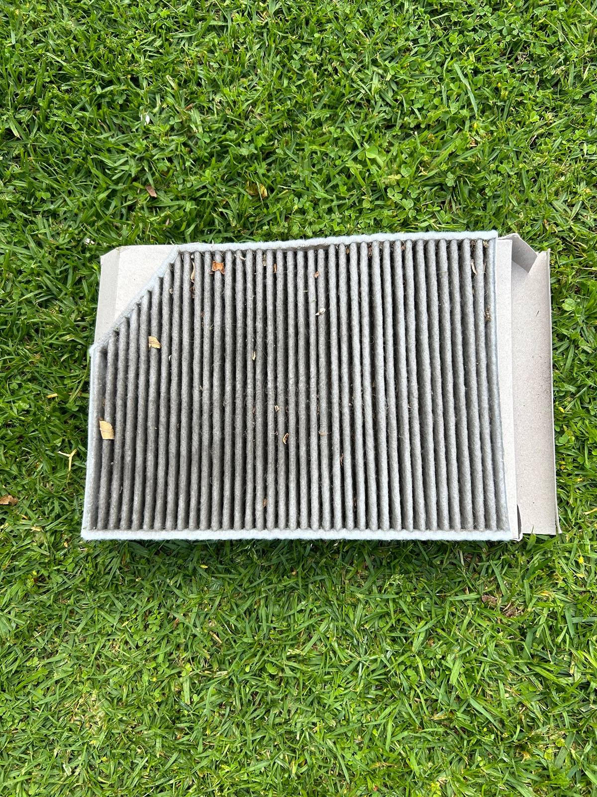

Replaced mine after 5k with the a-premium brand. Cheap and looks exactly like the OEM Denso ones. It is a bit tight with my body down there but a pretty simple job. Need to redo it as I noticed a whistle now when it’s preconditioning on full blast when I unlock and get into the car.

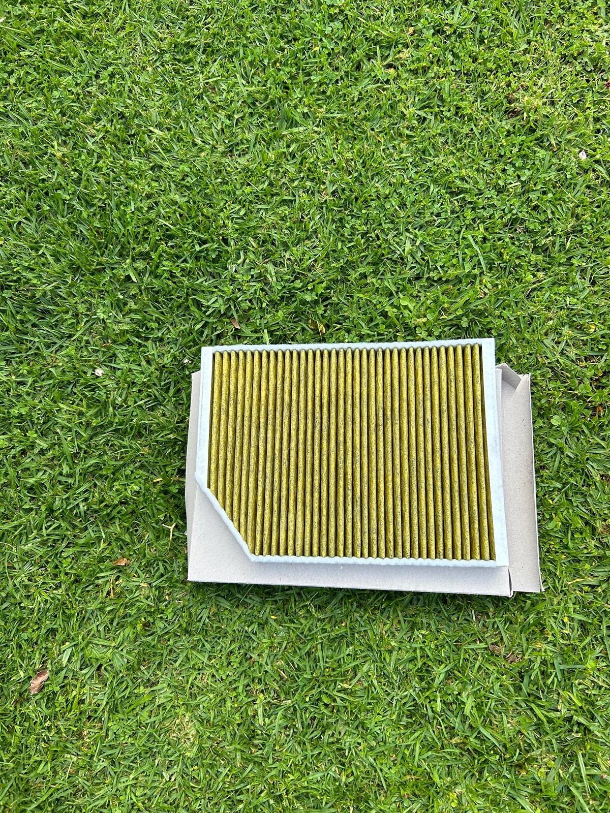

I use this brand of filter in Macan and Cayenne and was waiting for this one to be back in stock. This is in stock now, so will be ordering a few now before they are gone. This is the best one to get over the A-Premium that I have been using until now. This fits all Taycans and Audi eTron variant.
Reason: This is 4-stage with Activated Carbon, Baking soda, and Antibacterial layer. Ideal change frequency every 5k miles or 6 months or you are breathing mold that you can see if you only change yours per recommended 2 years and 20k miles.
