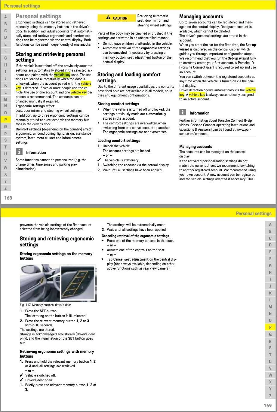

The problem was simply that the manual said not to do it. I didn't try so I can't cite any specific problems. That being said, I can't seem to find where I read that now.
From what I can tell, the vast majority of customizations are stored either in the seat memory buttons or the Porsche Connect Id that is logged in and selected. However, the last settings used are saved on the key that was used.

All comfort settings can be stored - seat, AC, PCM, media, mirrors and Porsche Connect ID in use. Drive mode etc not.
When setting make sure you keep your own key well away from the car and then make all the person settings for your wife. I also press the memory button for the key (1 I think) to ensure the settings are saved.
Lock the car and the test with both keys but not together and don't carry both in the car.
Can you explain "memory button key (1 i think)"? Do you mean the button on the door?
