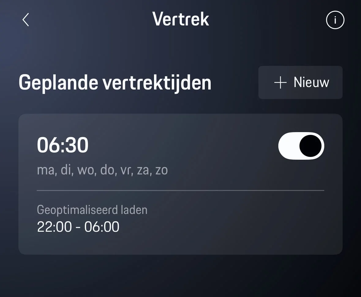

Always using this function and never failed.
Question: Did you send the planned timer to your car?
I’m using the setting planned departure, for daily charging. Only ‘overwrite’ when during daytime charging on the solar panels (direct charge)
Porsche Taycan How to use charging timers IMG_1728

Ehmmm. Good question! I honestly don’t know for sure. She did do the 8:00am perfectly though, so that implies that I did?
Gonna give it another try next charge!!

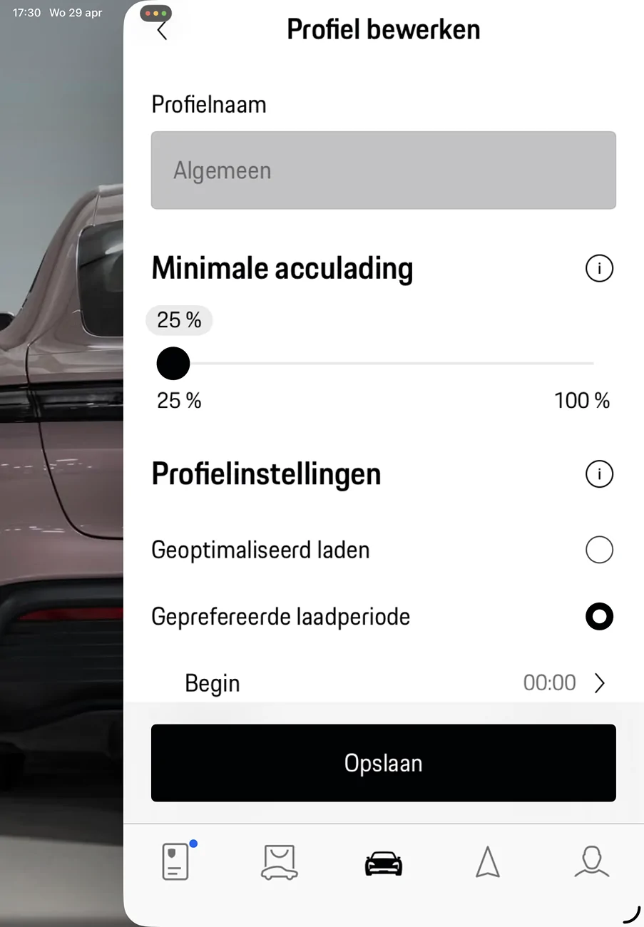

Thanks for all the useful insights! Indeed I’m very new to Taycan, to EV even.
My Taycan is a ‘22 J1.1
When looking at the profiles I couldn’t figure out how to set the max % of charge. Is it automatically on 85% then? A screenshot of my charging profile page is attached.
The timers however are very interesting: Being on a dynamic energy contract.. well timed charges are on negative electricity prices :) Getting rich by making more km’s!
Porsche Taycan How to use charging timers IMG_0017

We can go in circles here all day long. I recommend you tell us what you want to accomplish and I can tell you exactly how to set this up. After countless hours of research and trial and error, I can self-proclaim to have a PhD in the J1.1 charging logic.

Otherwise the car will charge until the limit set by the timer, say 85, and then will continue charging until the limit set by the profile, in this case 100% likely
This has been how it has worked on j1.1 since I’ve owned the car, so for 6 years
