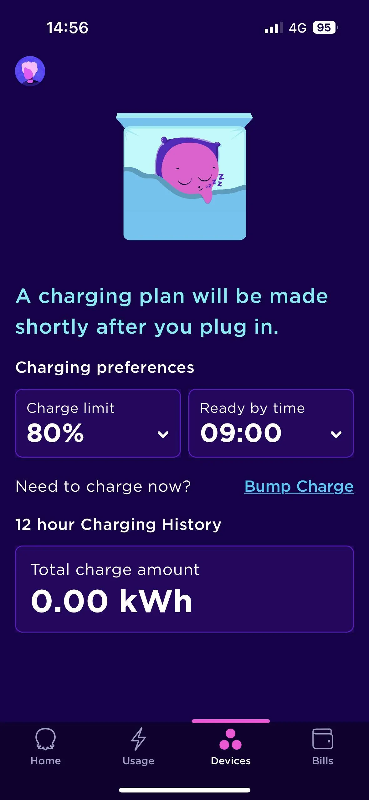

Assuming we’re taking the same intelligent octopus, the octopus app should control it..example screen attached

Exactly that yes. It’s set me charge plan but my car just saps up the charge when I plug in anyway. Octopus have replied real quick so I’ve sent them a load of screenshots to see if it’s something I’m doing wrong.
