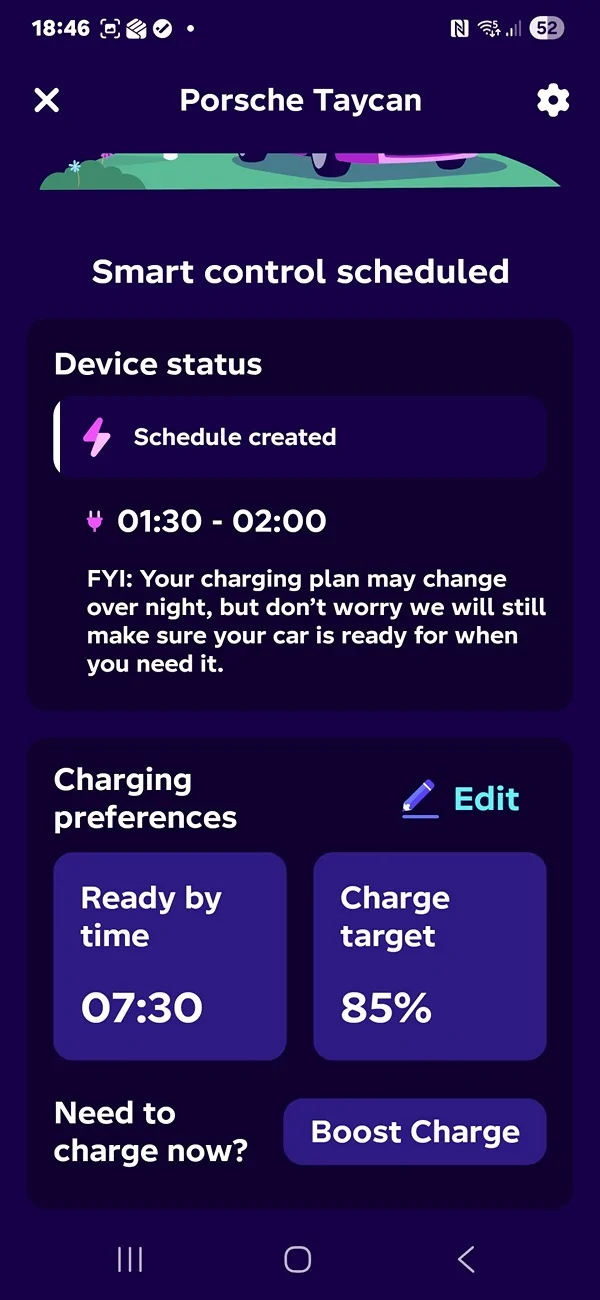

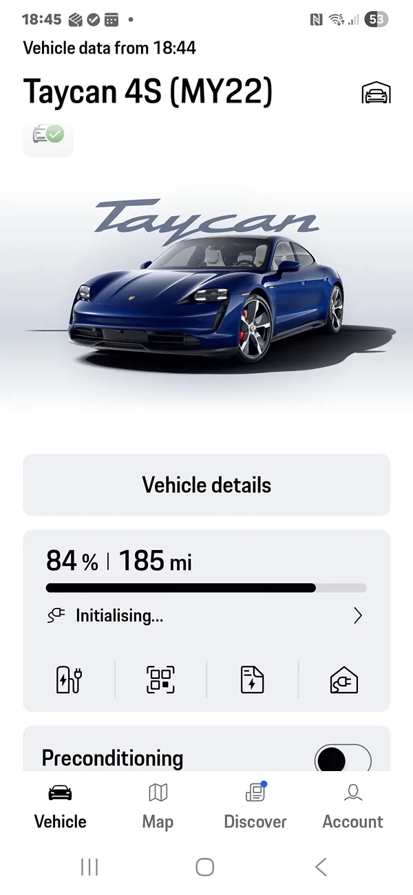

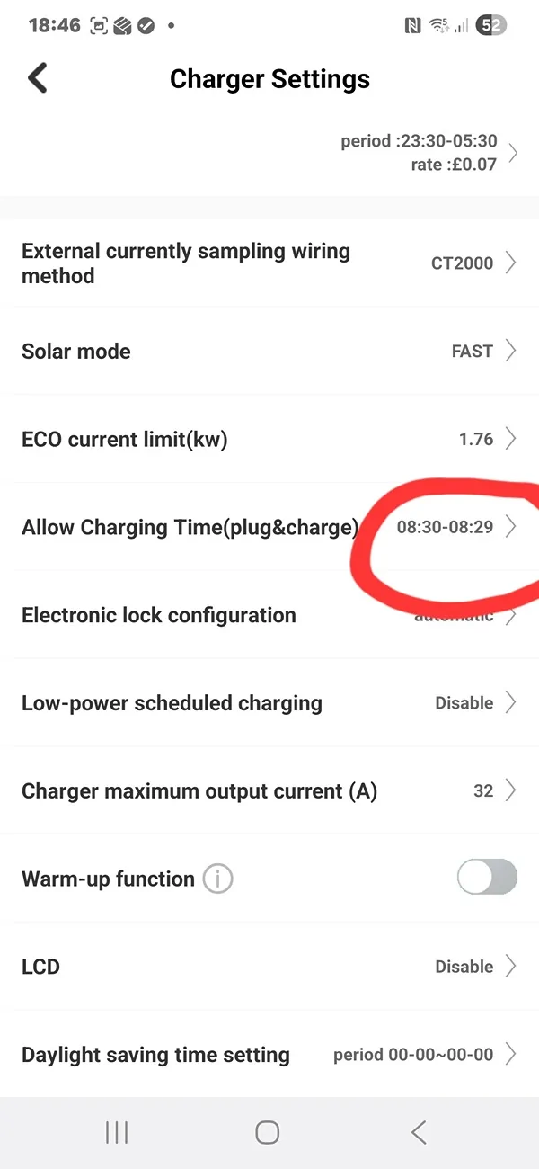

Hi
1. My Project EV is set to work 24hrs per day
2. OI connected to the car (via Porsche login) so it can control
3. I have no timers etc apart from within OI
4. Works pretty much ok ....occasional time when left plugged in it'll charge to 100% instead but after 3 days plugged in has charged exactly as expected
Some screenshots attached
Hope that helps!

Thanks for the reply and the screenshots, really helpful. I think I have a different Project EV charger to you as I don’t have the option to set a plug and charge charging time. At least I know to stop trying!!

Happy to send further photos if required. Why don't you direct message me with your charger type and I can compare with mine?
